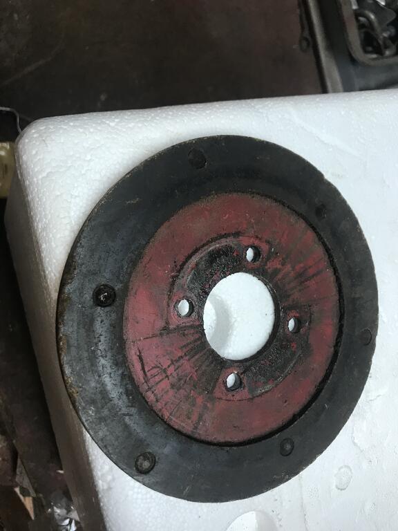

cafoose 3,883 #1 Posted April 30, 2020 I have a 6 inch PTO clutch plate from a Raider that is worn out. I'm thinking of getting this from and relining it. Will it work and what's the best way to attach it to the clutch plate? The OD of the original clutch plate is 6 inches and the ID is 4 1/8 inches. This one is 6 inches OD by 3 5/8 ID by 1/8 thick. https://www.ebay.com/itm/6-Slip-Clutch-Friction-Disc/223985794824?_trkparms=aid%3D1110004%26algo%3DSPLICE.COMP%26ao%3D1%26asc%3D225074%26meid%3D060f1855c4024fbeb130af5f8826ddab%26pid%3D100008%26rk%3D1%26rkt%3D12%26sd%3D272564626929%26itm%3D223985794824%26pmt%3D1%26noa%3D0%26pg%3D2047675%26algv%3Ddefault&_trksid=p2047675.c100008.m2219 Share this post Link to post Share on other sites

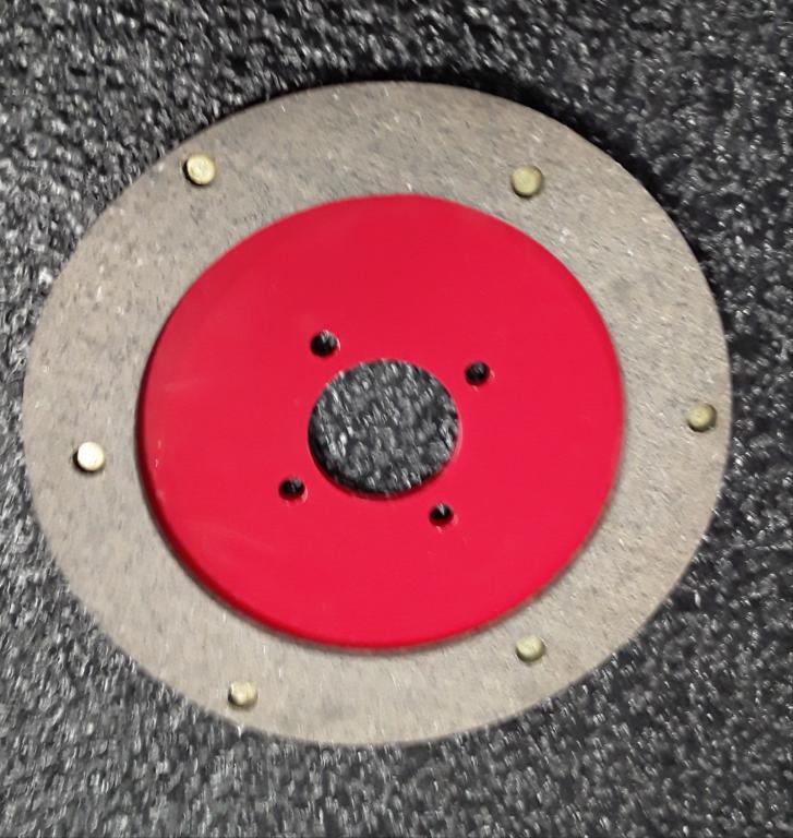

76c12091520h 4,292 #12 Posted May 1, 2020 10 hours ago, Racinbob said: There's two sizes Correct? 6" and 6 1/2". I needed one on my 76 16hp and bought a 6" on Ebay a while ago. Being a dummy I didn't actually measure the old one and its turns out I needed a 6 1/2" so the 6" is no longer needed. Problem is that I'm not fully unpacked from the move. With warmer weather here it won't be long though. Once I find it you can have it if you didn't already get one. Actual size is 6 3/4" , got em if you need em: 1 Share this post Link to post Share on other sites
cafoose 3,883 #13 Posted May 1, 2020 9 hours ago, 76c12091520h said: Actual size is 6 3/4" , got em if you need em: Mine is actually 6" that may be too big Share this post Link to post Share on other sites
76c12091520h 4,292 #14 Posted May 1, 2020 Yes, that's too big for 6" applications. Just helping clear up the size difference. Pre 73-74 =6" newer takes 6 3/4 Share this post Link to post Share on other sites
cafoose 3,883 #15 Posted May 1, 2020 6 minutes ago, 76c12091520h said: Yes, that's too big for 6" applications. Just helping clear up the size difference. Pre 73-74 =6" newer takes 6 3/4 Share this post Link to post Share on other sites
squonk 48,338 #16 Posted May 1, 2020 I have that clutch disc. There is a spot on the outer edge where the material is dinged up but it should work fine. If you want it $15 shipped. Share this post Link to post Share on other sites
cafoose 3,883 #17 Posted May 1, 2020 47 minutes ago, squonk said: I have that clutch disc. There is a spot on the outer edge where the material is dinged up but it should work fine. If you want it $15 shipped. PM sent Share this post Link to post Share on other sites
