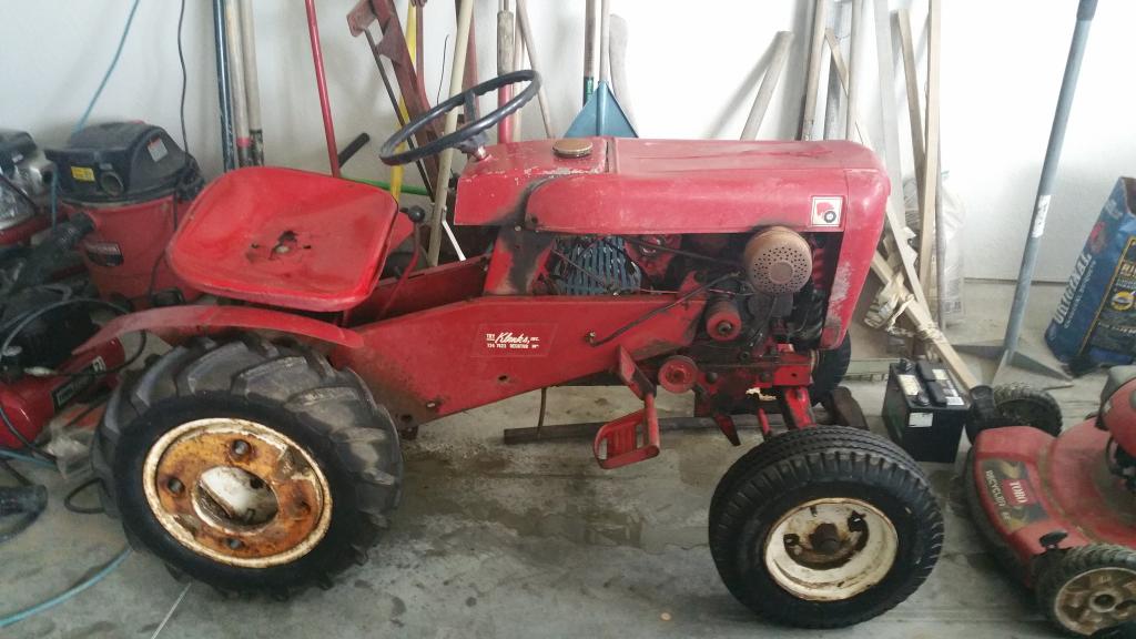

JSally 1 #1 Posted April 30, 2020 Forgive me gang but I am pretty new to all of this. I inherited my grandpa's 1963 753 Wheel Horse about two years ago and have finally found the time to start restoring it. First major issue is fuel leaks in a few places, including the two piece gas tank. It seems to be a small leak around one of the bolts that hold it together but before I take it apart I need some input from the professionals. Will I be able to find another seal, because I am sure the old one is shot? Would I be better off using some good old fashion JB weld to fix the small leak and not open a huge can of worms? My mechanical ability is fair I would say but not too familiar with garden tractors. Any input would be great! Thanks. 1 Share this post Link to post Share on other sites
