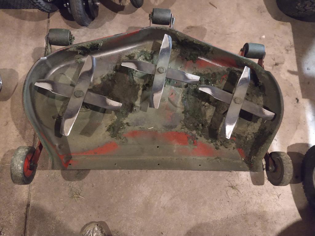

OoPEZoO 618 #16 Posted February 3, 2022 I've been running my 36" RD deck like this for probably 10 years. One set of standard blades and one set of gator blades. I think it works great. I'm very happy with the cut quality. I don't have anything between the blades, just tightened the spindle nuts down with an impact wrench. Only difference with my deck is that it has the arching baffles in the front. The previous cut quality was OK, but the dual blade setup was a noticeable improvement. That being said, the most important thing for a nice cut with my deck is sharp blades and making sure there isn't grass built up underneath. My deck is horrendous for that.......my property runs along a creek and doesn't drain well. My grass is always wettish, and will pack the underside of the deck almost solid......then it cuts like crap Share this post Link to post Share on other sites

peter lena 10,090 #19 Posted February 4, 2022 @OoPEZoO that under deck issue is treatable , NONE OF MY DECKS HAVE BAFFELING , terrifying to many , I am aware of the intended benefit . the built up solid clogging is your obvious issue , and enhanced rotting . that was my original intended removal of the baffles , they did little to help on the lawn. regularly drop my decks for light cleaning / lubrication spray down and most important , hot sun angle drying , like this , been doing this for years , none of my decks have any rot , blades are sharp , they are soaking in oil now over winter, upside down to hold lubricant to metal . grass cutting is very good , questions ? just ask , pete Share this post Link to post Share on other sites
