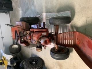

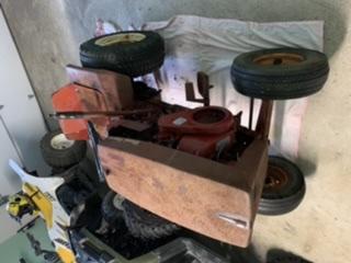

jamessparks 55 #1 Posted April 29, 2020 Just picked up a well condition 1965 855 but the guy who placed in storage cut all the wires so I am looking to get some advise on new Battery cables (OEM or Aftermarket) and also wire gauge for rewiring? Thank you. 1 Share this post Link to post Share on other sites

jamessparks 55 #3 Posted April 29, 2020 Thank you. Yes everything is original but what the gentlemen did when putting it away in the shed 5 yrs ago was just cut all the wires where each attaches and disconnected. I’m looking to see if you have any pictures as well but thanks for the information. Share this post Link to post Share on other sites

jamessparks 55 #7 Posted April 29, 2020 Sounds great. Thanks. Yes and what he did was just take cut pliers and cut the entire middle section of the wires out from the battery, starter, coil and to the ignition. Pieces of the color coded wire are still attached with the small bolt/nut so that’s a plus as well as I found the wiring diagram for the 855 on the forum. Thanks 2 Share this post Link to post Share on other sites
Achto 32,254 #8 Posted April 29, 2020 I would ask why he cut all the wires, but I stopped trying to figure out why people do what they do. Congratulations on your new !!! Please show us some pictures when you get a chance. 4 Share this post Link to post Share on other sites

jamessparks 55 #10 Posted April 30, 2020 @squonk can you provide me the name/address or phone. Thanks for the update and sounds good. Pictures in progress. 2 Share this post Link to post Share on other sites
