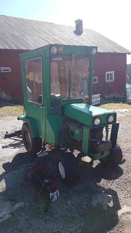

d200 :) 1 #27 Posted May 4, 2020 Hi found out what was wrong. Was the swash plate was not in place. Now it works great again thanks for all the tips Share this post Link to post Share on other sites
d200 :) 1 #28 Posted May 4, 2020 So now start rust jobb and paint Share this post Link to post Share on other sites
