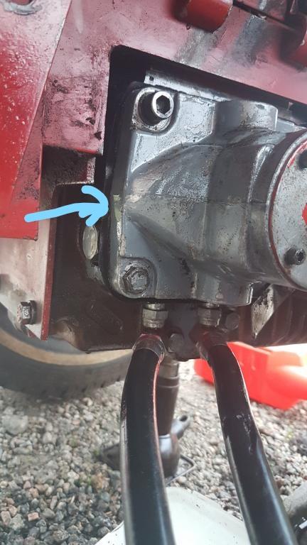

d200 :) 1 #3 Posted April 28, 2020 Skien is in norway :)thanks for the manual. it is the seal on the photo Share this post Link to post Share on other sites
Achto 32,465 #4 Posted April 28, 2020 I have little knowledge on your transmission. Following along to gain some. Share this post Link to post Share on other sites
pfrederi 21,095 #5 Posted April 28, 2020 At the blue arrow? That we would call a gasket. Share this post Link to post Share on other sites
d200 :) 1 #6 Posted April 28, 2020 Yea hehe sorry gasket any ideas what i sould do next ?:) Share this post Link to post Share on other sites

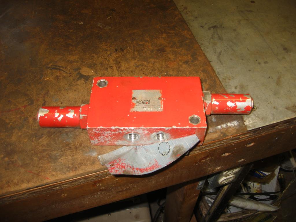

pfrederi 21,095 #9 Posted April 28, 2020 You have a dampener that was only used a couple years I am not familiar with them. Does the lift operate??? Share this post Link to post Share on other sites

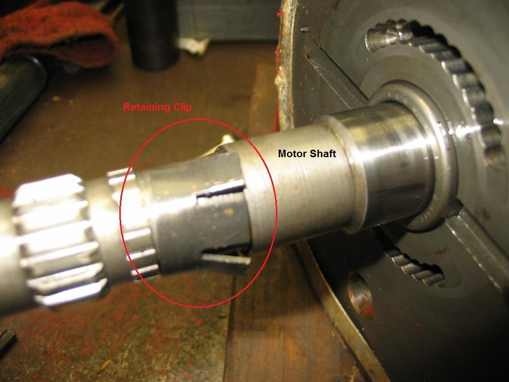

pfrederi 21,095 #10 Posted April 28, 2020 Look at page 45. any steps you may have missed ? Did the cover come off easily or did it require effort. The retaining spring clip may have broken... Share this post Link to post Share on other sites

pfrederi 21,095 #15 Posted April 28, 2020 (edited) This is second failure reported here this week. I have to think on this some.The other was after just a fluid change. Spring clip I menat was in Fig 84 Edited April 28, 2020 by pfrederi Share this post Link to post Share on other sites

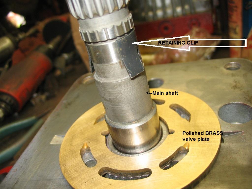

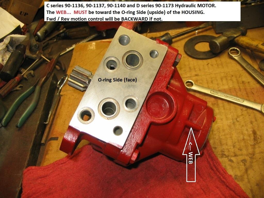

daveoman1966 3,884 #18 Posted April 28, 2020 (edited) This is the SPRING CLIP that pfrederi refers to. It MAY have broken which is not all the uncommon. I ahve a new one if wanted. It is very likely that when you replaced the cover, you got it on upside-down. The HYD MOTOR COVER has a 'web' on one side and that 'web' MUST be on top... look at last pic. Edited April 28, 2020 by daveoman1966 2 Share this post Link to post Share on other sites

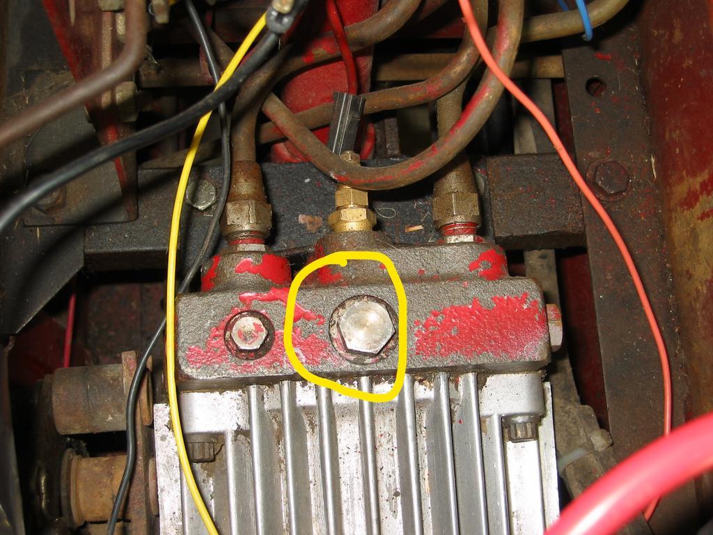

d200 :) 1 #21 Posted April 29, 2020 (edited) 19 hours ago, daveoman1966 said: This is the SPRING CLIP that pfrederi refers to. It MAY have broken which is not all the uncommon. I ahve a new one if wanted. It is very likely that when you replaced the cover, you got it on upside-down. The HYD MOTOR COVER has a 'web' on one side and that 'web' MUST be on top... look at last pic. Thank you for the info. webing is upp. But could i damage the retaining clip just by oppening the cover ? I dident empy the hole system just the hydro pump. Was wondering if the release valve could be the problem could i try witout it. Edited April 29, 2020 by d200 :) Share this post Link to post Share on other sites

pfrederi 21,095 #24 Posted April 29, 2020 (edited) what kind brand and number filter is on it. also make sure the coupling between the engine and pump is OK and that the splined input shaft is not slipping. Did you use any sealant on the gasket? The diagnostic chart would have yu look in the transaxle but I don't think that is your problem, something wrong in there the lift would still function. i am afraid a pressure test as shown in the manual is the next step. Edited April 29, 2020 by pfrederi Share this post Link to post Share on other sites
