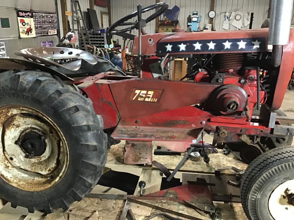

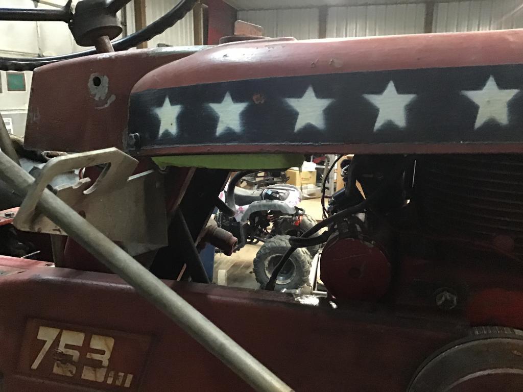

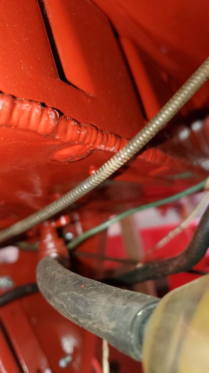

Pullstart 71,482 #10 Posted April 28, 2020 @puplman I modified a gas tank for my “Frank” build and sealed it with a three part system from KBS Coating. It worked great! This link here is where I started the process. 1 Share this post Link to post Share on other sites
Pullstart 71,482 #11 Posted April 28, 2020 Here are some pictures. I milled the bottom corner off the tank, then bent the bottom plate a tad and my father in-law helped weld it at his shop. 1 Share this post Link to post Share on other sites
bottjernat1 2,197 #12 Posted April 28, 2020 Ron grenco I think is his name he sells the gasket for the tank they work! My late dad bought 2 from Ron. He is also on Facebook! 1 Share this post Link to post Share on other sites
puplman 9 #13 Posted April 28, 2020 19 minutes ago, pullstart said: Here are some pictures. I milled the bottom corner off the tank, then bent the bottom plate a tad and my father in-law helped weld it at his shop. I was thinking about taking it off and bringing it to a local welder and then coating the inside. Sounds like that is pretty much what you did. Thank you for the insight. 1 Share this post Link to post Share on other sites
Pullstart 71,482 #14 Posted April 28, 2020 This stuff is such an awesome product, I doubt it needs welding. We just milled the threads off and had an uneven plane to deal with. These tanks weld like garbage and he had a better suited aluminum welding setup than I do in my garage. In your case, If it were mine I’d just coat it with the gasket and sealer in place as it is. The cleaner and cutter steps may leak a little, but the seal coat is amazing stuff and just thickens up. Use a plastic grease coated plug on the outlet bung and duct tape off the hole after you apply the coating. Share this post Link to post Share on other sites
