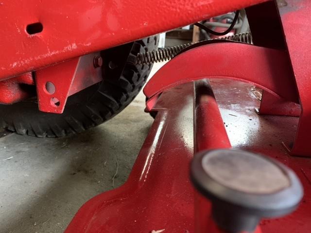

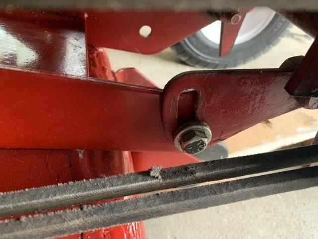

Ronert Canan 2 #1 Posted April 27, 2020 32” Mower deck will not balance front to back... (Front will not lift) As can be seen in the photos the front of the deck has to be wedged up with wood to even out the blade height front to back with the deck dropped... The drag link is almost an inch above the wheel support arm... See Photo. Seems like the drag link is what supports/lifts the front of the deck? The lift rod is set as high as will allow... the Share this post Link to post Share on other sites
Ed Kennell 46,604 #2 Posted April 27, 2020 36 minutes ago, Ronert Canan said: Does the curved support belong under the rod? 36 minutes ago, Ronert Canan said: Share this post Link to post Share on other sites
