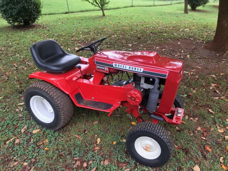

Pullstart 68,878 #2 Posted April 27, 2020 Right around 6 minutes 55 seconds I show how the hanging weight is attached to Putt Putt. 1 Share this post Link to post Share on other sites

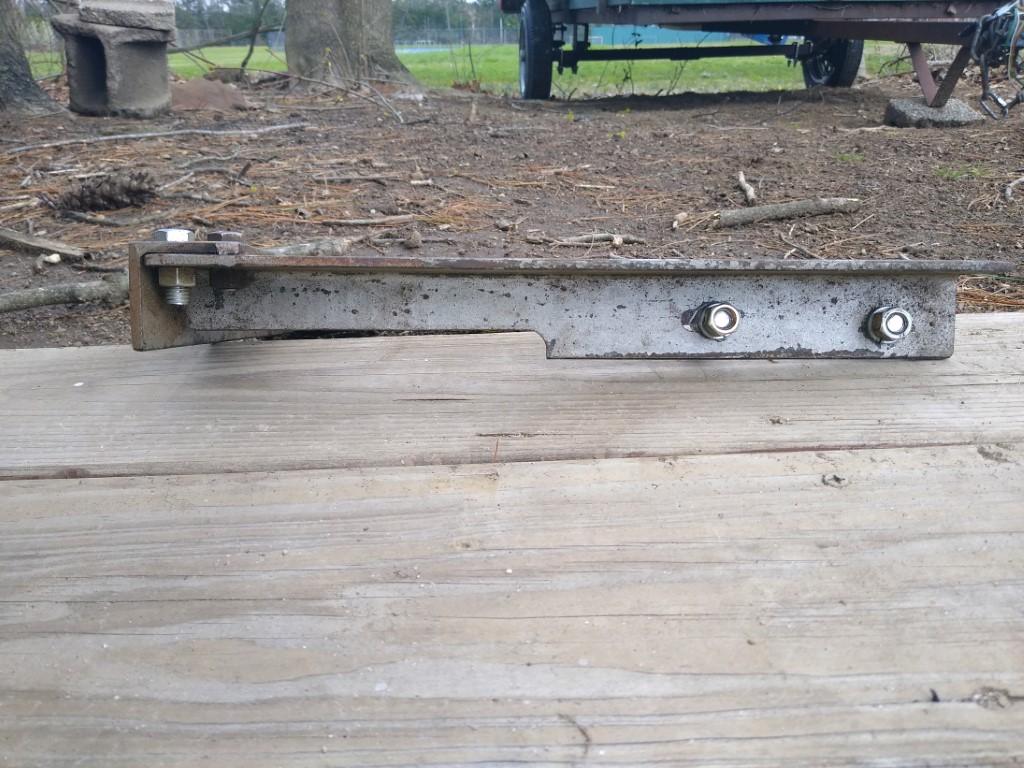

McGrew 461 #3 Posted April 27, 2020 Eric, I cannot take credit for this bracket, as my Dad did it almost 40 years ago, but it works. He moved boats and trailers with this bracket, and I used it as the attachment point for the winch I recently installed. The bracket stated out as 2x2 x 1/4" angle that was cut, sectioned, bent and welded into shape to clear the hood opening. It attaches with 4 grade eight 3/8-16 bolts. Hope this helps! Danny 5 2 Share this post Link to post Share on other sites

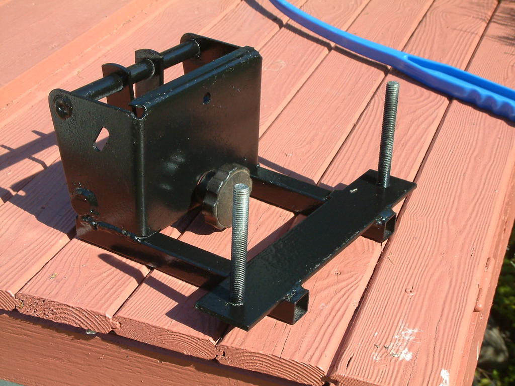

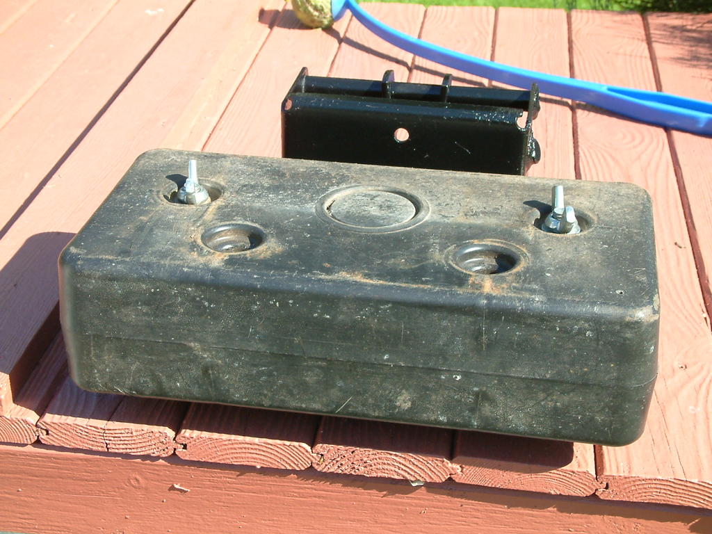

Stormin 9,987 #5 Posted April 27, 2020 This mule drive with slight mod was done to carry the front weight on the Black Horse. Something similar could be done for carrying a tool box. 4 Share this post Link to post Share on other sites

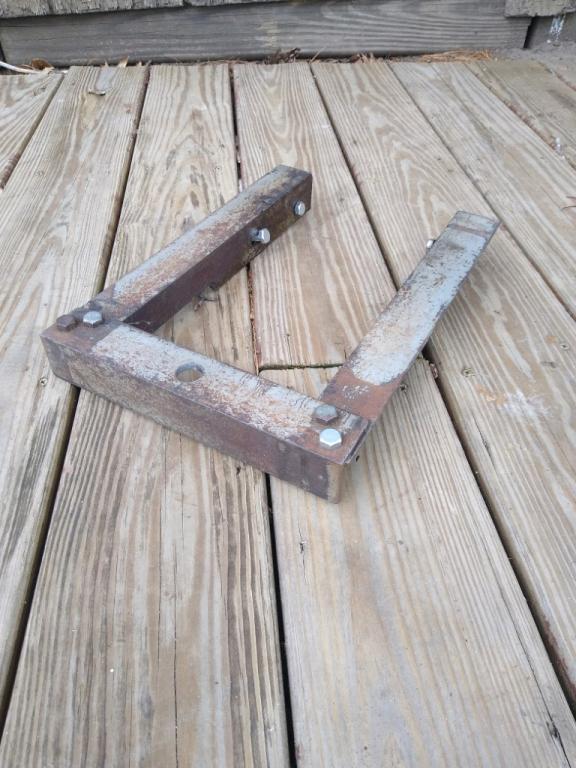

CCW 1,491 #7 Posted April 27, 2020 3 hours ago, McGrew said: Built a similar bracket to this one to hold a front hitch. Bolted to existing holes on the side of the frame. Made it out of angle iron and worked great. Could easily be modified to carry a box or other bracket. 2 Share this post Link to post Share on other sites

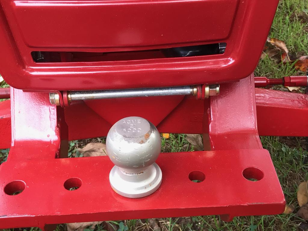

Lee1977 7,552 #12 Posted April 30, 2020 (edited) 22 hours ago, Mickwhitt said: I'm going to try and make a bracket that fits on the mule pulley mounting to carry a tool box, in a similar way to Norms weight carrier. I dont want to use the mule pulley unit itself so I will fabricate something that will fit just like the mule unit. My only concern is that there is nothing to stop the bracket hingeing up and down when driving over bumps. I'll look at some way of fixing it to stop that. Obviously the mule pulley is hinged to allow for adjustment and the pulley is held against the adjuster by the belt tension. I will have to create something that holds the bracket steady. Mick It's just a 2x2x1/4" angle with a 5/8" bolt welded to iit. the clip on the back side hooks under the hitch to keep it from flipping up.. I fad a front bumper bolted to it. Correction it;s 2 1/2 x 2 x 1/4 angle. took me a few minuets to find it ,it was hiding under the front of the air compressor. The release handle comes forward and some are not welded on the same. be sure it will come forward enough to release release with the bracket in place. Edited April 30, 2020 by Lee1977 2 Share this post Link to post Share on other sites
CCW 1,491 #13 Posted April 30, 2020 (edited) 1 hour ago, Lee1977 said: It's just a 2x2x1/4" angle with a 5/8" bolt welded to iit. the clip on the back side hooks under the hitch to keep it from flipping up.. I fad a front bumper bolted to it. Correction it;s 2 1/2 x 2 x 1/4 angle. took me a few minuets to find it ,it was hiding under the front of the air compressor. The release handle comes forward and some are not welded on the same. be sure it will come forward enough to release release with the bracket in place. This is very nice. You sure used the KISS method of design. I am going to explore making one of these. @ebinmaine this might be just what you need to mount your item. Edited April 30, 2020 by CCW 1 Share this post Link to post Share on other sites
Lee1977 7,552 #14 Posted April 30, 2020 (edited) 3 hours ago, CCW said: This is very nice. You sure used the KISS method of design. I am going to explore making one of these. You don't need the bolt a 5/8" rod will work just as well, once it's latched in place it's not going to move side ways. You could use 3 or 4 inch angle turn the angle down so the leg out is lower. make it to do what you need it for. Edited April 30, 2020 by Lee1977 1 Share this post Link to post Share on other sites
