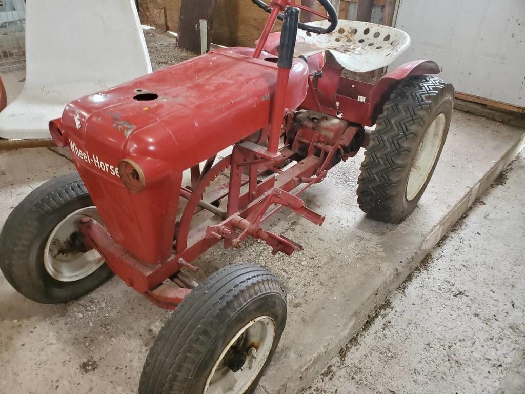

Powerwagonguy 4 #1 Posted April 27, 2020 Hi all, Can someone help with ID of this Wheelhorse, model and year if possible?....also are the headlights factory?....an option?.....Thanks! 2 1 Share this post Link to post Share on other sites
Pullstart 71,520 #2 Posted April 27, 2020 i’m gonna take a crack at this. 401 Suburban is my guess. Cast front axle makes it a Suburban and the 2 piece trans makes it ‘61. I THINK. those lights were definitely custom, never an option like that. Share this post Link to post Share on other sites
jimt1971 239 #3 Posted April 27, 2020 551 with two piece trans. 2 Share this post Link to post Share on other sites
857 horse 2,588 #4 Posted April 27, 2020 401 DIDNT HAVE THE FRAME THAT ATTACHES LIKE THAT....AND A 401 USED THE 3 PIECE TRANS....... THAT HOOD IS TO DIE FOR.......DONT LOOSE MY POST...I WILL BUY IT ANYTIME,,,,++ PERFECTION.!!!!!!!!!!!!!!!!!!!!!!....MY 401,,,,WHEN I HAD NO IDEA WHAT I WAS DOING.....5 YRS LATER,,KNOW ABOUT AS MUCH.!!!!!!! 2 Share this post Link to post Share on other sites
wallfish 20,733 #5 Posted April 27, 2020 It's a 1961 model 551 That hood stand and the 2 piece trans are unique to that particular suburban model which IDs it. Someone did a good job adding those lights to the hood, looks cool but not factory 2 3 Share this post Link to post Share on other sites

Powerwagonguy 4 #8 Posted April 27, 2020 Thanks for that info guys!....boy those lights sure looked factory and really fit the whole look.....the guys looking for $375 , no motor, as shown......too far away for me so if anyones interested it's on Milwaukee craigslist, farm and garden.....Have fun!! 1 Share this post Link to post Share on other sites
