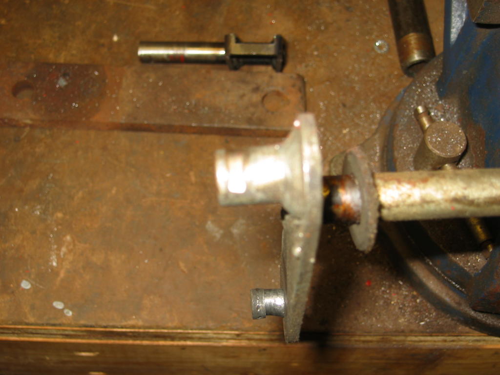

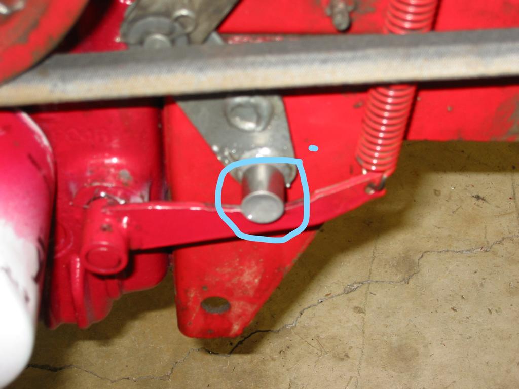

pfrederi 17,233 #5 Posted April 27, 2020 Check the bottom of the circled pin. They can get a groove worn in them (other pic) which can affect engagement. 4 Share this post Link to post Share on other sites
