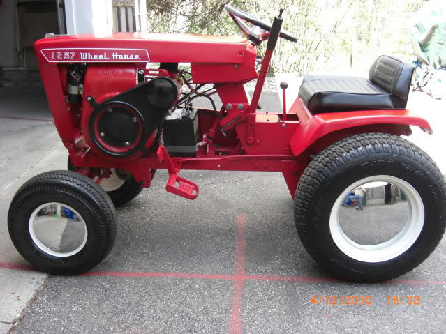

Retired Wrencher 6,542 #1 Posted April 27, 2020 Of all the tractors I have had I miss this hot rod 1257 the most. The engine was a 10 of 10. Great tractor. I do not have the original pick when I pick it up, but it did not look like this. Hindsight is real. 12 2 3 Share this post Link to post Share on other sites

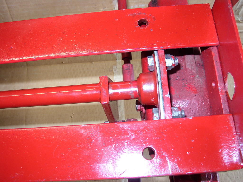

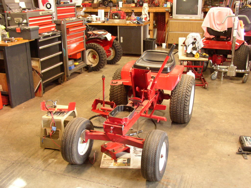

SPINJIM 1,996 #3 Posted April 27, 2020 (edited) Sorry about your seller's remorse, but happy to hear your praise of the 1257. I'm in the midst of restoring a 1257, but wondering if all of my efforts are worth it. You've encouraged me to keep going. Just finished rebuilding the steering linkage, and have to finish the K301 rebuild. Thanks, Jim Edited April 27, 2020 by SPINJIM 8 4 Share this post Link to post Share on other sites

peter lena 9,818 #5 Posted April 27, 2020 spinjim , looks like a thorough refit going on , is there any area that you have improved on ? ,in making it better ?. i always look at the tear down of any area as the opportunity to improve it . pete Share this post Link to post Share on other sites
SPINJIM 1,996 #6 Posted April 27, 2020 (edited) 28 minutes ago, peter lena said: there any area that you have improved on ? When I rebuilt the steering linkage (with lightly used parts), I put a spacer at the front end of the lower steering shaft. Instead of relying on just washers and a cotter pin at the rear end of the shaft, I took some play out of the steering by putting a 1/8" steel plate under the front shaft bearing to make sure that the fan gear fully engaged. Still left space for oiling the front bearing. Also, changing the battery box from the over-sized one (that was original) to the smaller one that fits a U1 battery. Leaves more room for the fan gear, and for air circulation around the engine. Also, going to put springs under the seat, instead of having it bolted directly to the fender. Easier on my 77 year old spine. Jim Edited April 27, 2020 by SPINJIM 8 3 Share this post Link to post Share on other sites
SPINJIM 1,996 #7 Posted April 27, 2020 (edited) 2 hours ago, Retierd Wrencher said: I miss this hot rod 1257 the most. Hi Retired Wrencher, I wondered why you called it your "hot rod" 1257. Did you make changes to the engine or to the pulley ratio ? Edited April 27, 2020 by SPINJIM Share this post Link to post Share on other sites
peter lena 9,818 #8 Posted April 27, 2020 spinjim , thank you for the feedback ! i can relate to doing similar modifications , both in steering and seat springs, they both had a difference that you can feel . on my battery tray i used conveyor belt material on the base , and a spiral wire wrapped coil spring over the top of battery to hold it in place. nice job , pete 2 Share this post Link to post Share on other sites

Retired Wrencher 6,542 #10 Posted April 27, 2020 (edited) 5 hours ago, SPINJIM said: Hi Retired Wrencher, I wondered why you called it your "hot rod" 1257. Did you make changes to the engine or to the pulley ratio ? Old style moons. Also the rear tires where slick looking from the side. Edited April 27, 2020 by Retierd Wrencher 3 Share this post Link to post Share on other sites

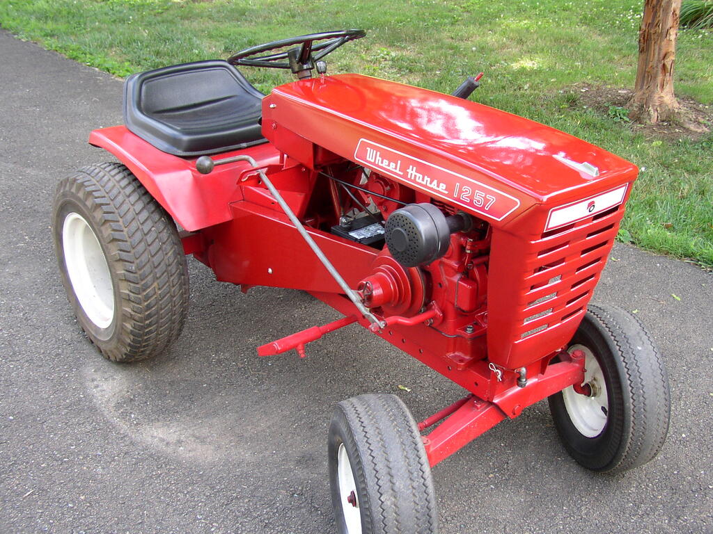

Retired Wrencher 6,542 #19 Posted February 14, 2024 On 4/27/2020 at 9:48 AM, SPINJIM said: Sorry about your seller's remorse, but happy to hear your praise of the 1257. I'm in the midst of restoring a 1257, but wondering if all of my efforts are worth it. You've encouraged me to keep going. Just finished rebuilding the steering linkage, and have to finish the K301 rebuild. Thanks, Jim Jim did you ever finish that 1257? If so can you post pictures of it? Share this post Link to post Share on other sites
SPINJIM 1,996 #20 Posted February 14, 2024 (edited) Yes, I did finish it. I had to downsize, so I sold it in favor of a C-120. Edited February 14, 2024 by SPINJIM wrong picture 3 2 Share this post Link to post Share on other sites
