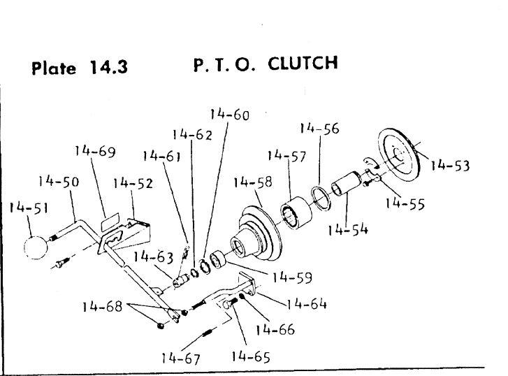

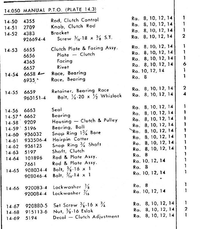

cafoose 3,883 #1 Posted April 27, 2020 Will a PTO clutch plate from a 1977 C series work on a 1972 Raider style PTO? I'm trying to convert the electric clutch on my GT-14 to manual. I have all the parts I need except for 14-53. 14-54, and 14-55 in the diagram. Part numbers are 6655, 6658, and 6659. I have a complete PTO with a 103817 clutch plate and I'm wondering if a 6655 will work. I'm also looking for a choke cable 102118 and engine mounting bracket for it such as used on a 1267 or similar model because I used a carb from a later model and can't use the GT-14 cable. I already posted my needs in the wanted classifieds. Share this post Link to post Share on other sites
