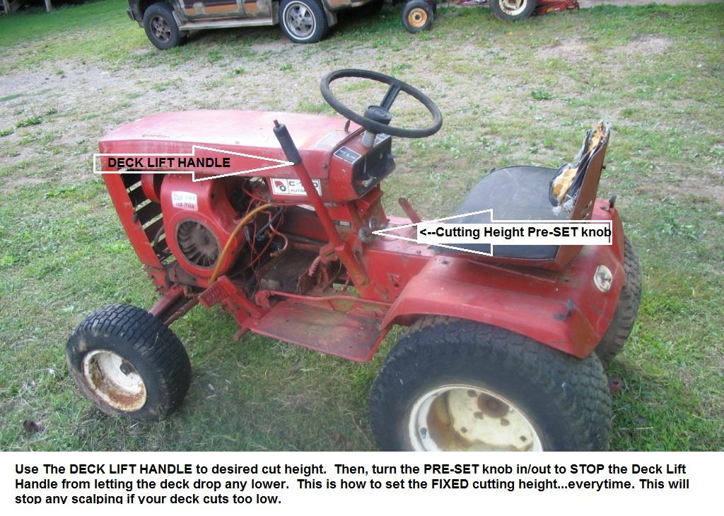

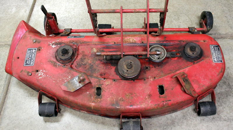

daveoman1966 3,884 #5 Posted April 25, 2020 (edited) Use the DIAL-A-HEIGHT knob to STOP the deck from dropping too low. This is a C-120 Auto, but the 8-sp should be the same. This is about the best pic I have to show what to do.... Here is a better pic of the Height Setting Apparatus... Edited April 25, 2020 by daveoman1966 1 1 1 Share this post Link to post Share on other sites
Mr Magoo 226 #6 Posted April 26, 2020 I think my Dial-A -Height is already maxed out, but I will look at it again when I get it back together. I have all new wheels and a new belt coming for it. Original WH belt was cracked and about ready to go. I may look for a new hitch shaft too. Mine is pretty worn. 1 Share this post Link to post Share on other sites

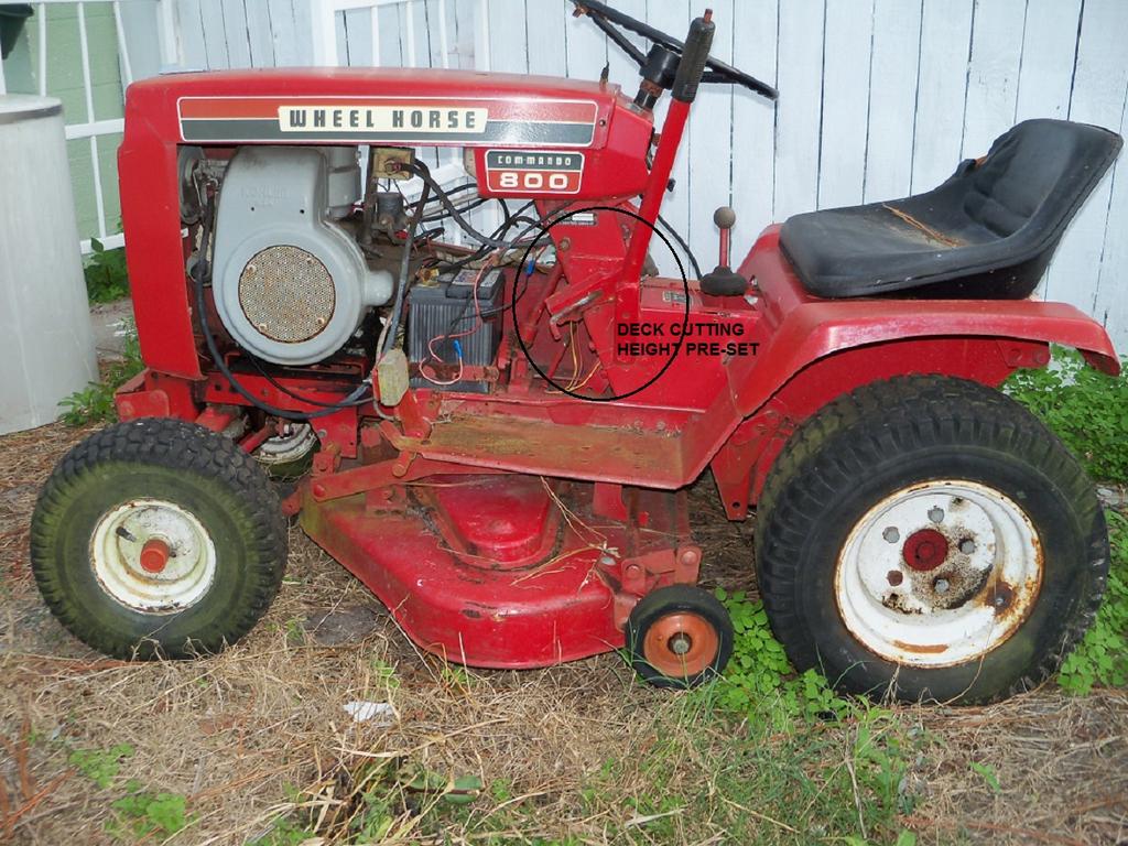

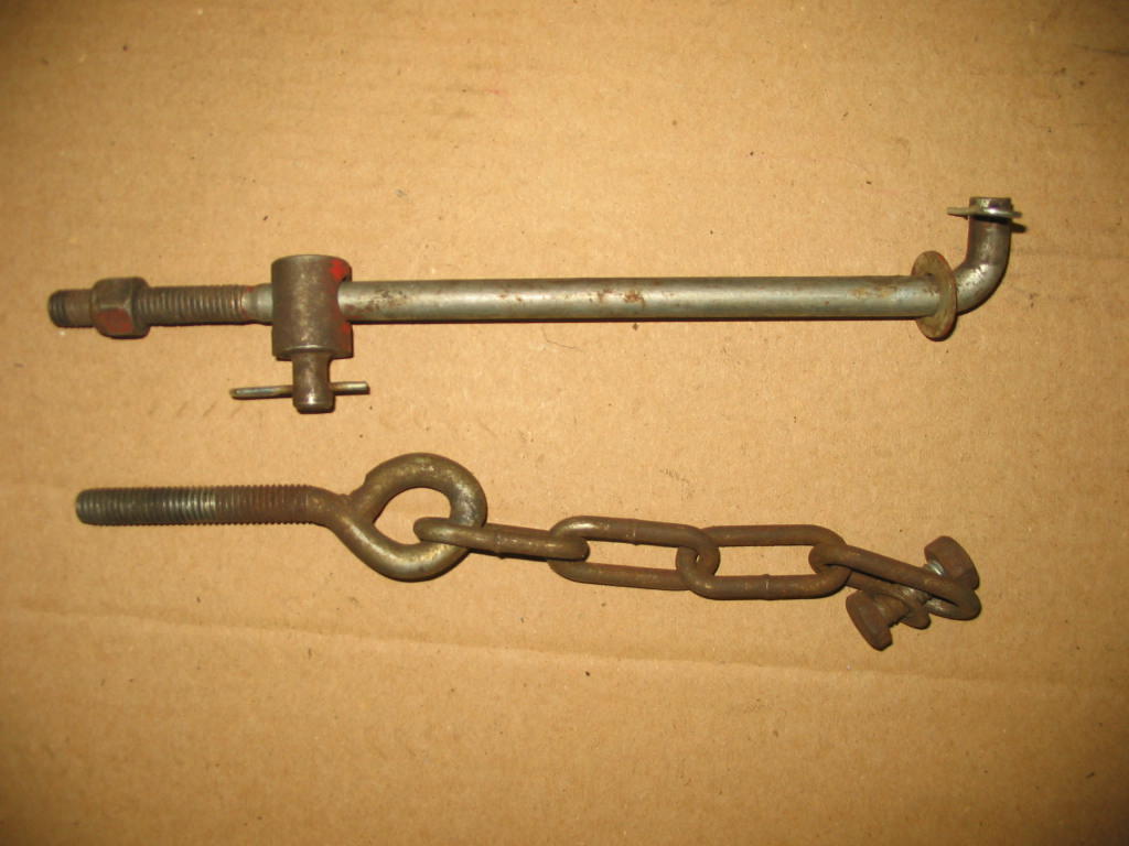

daveoman1966 3,884 #7 Posted April 26, 2020 Keep in mind that the anti-scalp rollers should hit the ground, ONLY to avoid scalping... Not always in contact. You MAY also gain some height by adjusting the LIFT ROD and TRUNION that hangs down from the lift handle...under the tractor. Here is aq pic. SOME tractors use the chain and Eyebolt...some use the trunion and rod. 4 Share this post Link to post Share on other sites
Mr Magoo 226 #8 Posted April 26, 2020 7 hours ago, daveoman1966 said: Keep in mind that the anti-scalp rollers should hit the ground, ONLY to avoid scalping... Not always in contact. You MAY also gain some height by adjusting the LIFT ROD and TRUNION that hangs down from the lift handle...under the tractor. Here is aq pic. SOME tractors use the chain and Eyebolt...some use the trunion and rod. Isn't the rod just for leveling the deck? Share this post Link to post Share on other sites
dalez 148 #9 Posted April 26, 2020 Yes it is for leveling but if too far out of adjustment the front can hang too low. Share this post Link to post Share on other sites

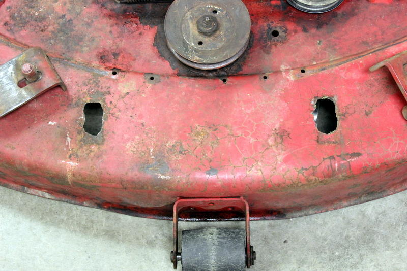

Mr Magoo 226 #12 Posted April 26, 2020 Did a bunch of disassembly today. I have several issues to correct. The rod that carries the two rollers in the rear is badly worn. I will have to cut it out and weld a new one in. The holes in the brackets for the front rollers are really wallowed out and the axle shafts are badly worn. Share this post Link to post Share on other sites

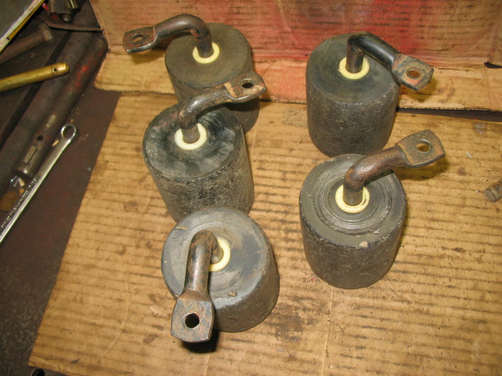

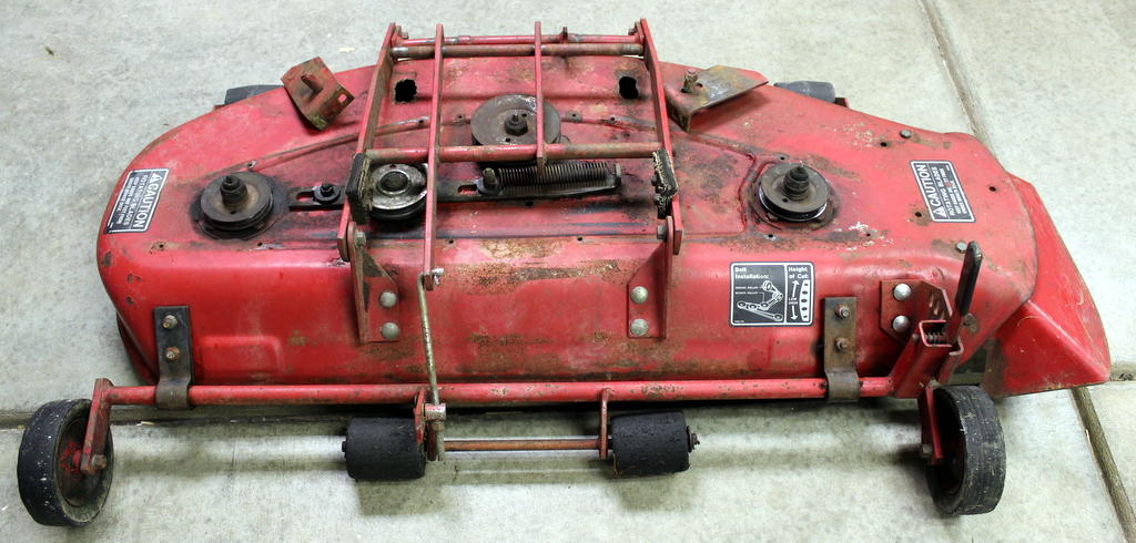

daveoman1966 3,884 #13 Posted April 26, 2020 (edited) I can get you a set of 3 front anti-scalp rollers with 3 good non-worn shafts. Two styles...that are interchangeable.. ps... The white NYLON inserts you see here are NEW. Other parts needed ??? Email me for prices : I am: daveoman@windstream.net Edited April 26, 2020 by daveoman1966 1 Share this post Link to post Share on other sites

daveoman1966 3,884 #18 Posted April 27, 2020 The group of FIVE (5) rollers with shafts are all the same...just look diff in pics. The ends are FLAT. They all have new nylon inserts. The group of THREE (3) rollers are the more modern design...like yours, but MUCH lighter in weight. These are 'hollow' ends. 1 Share this post Link to post Share on other sites
Mr Magoo 226 #19 Posted April 27, 2020 3 hours ago, daveoman1966 said: The group of FIVE (5) rollers with shafts are all the same...just look diff in pics. The ends are FLAT. They all have new nylon inserts. The group of THREE (3) rollers are the more modern design...like yours, but MUCH lighter in weight. These are 'hollow' ends. The nylon inserts were gone in some of them and ate the axles up. Share this post Link to post Share on other sites
daveoman1966 3,884 #20 Posted April 28, 2020 17 hours ago, Mr Magoo said: The nylon inserts were gone in some of them and ate the axles up. As you can see, the axles are not chewed up at all. $45 for 3 axles and SOLID rollers as shown in pic of FIVE. + 7 to USA zips $35 for the 3 'hollow' rollers with 3 axles. 7 to ship. Share this post Link to post Share on other sites

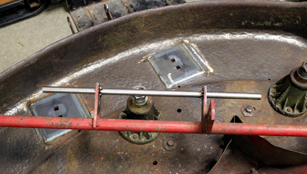

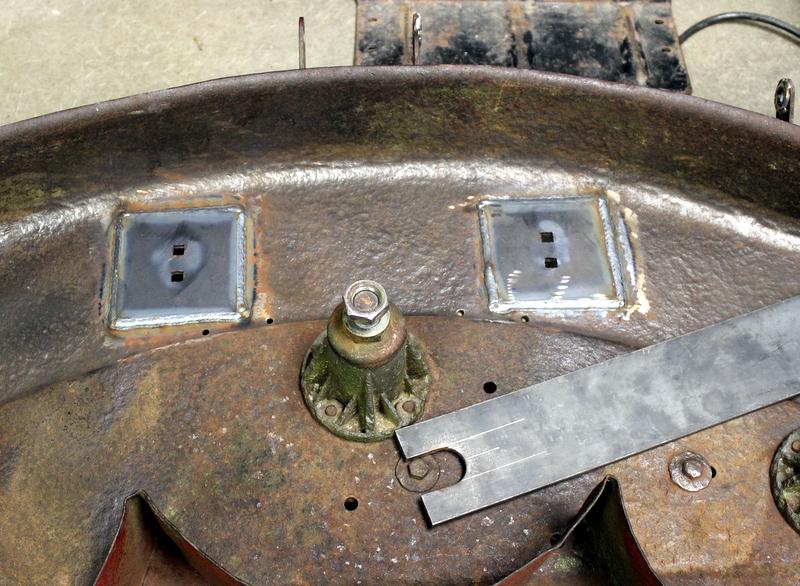

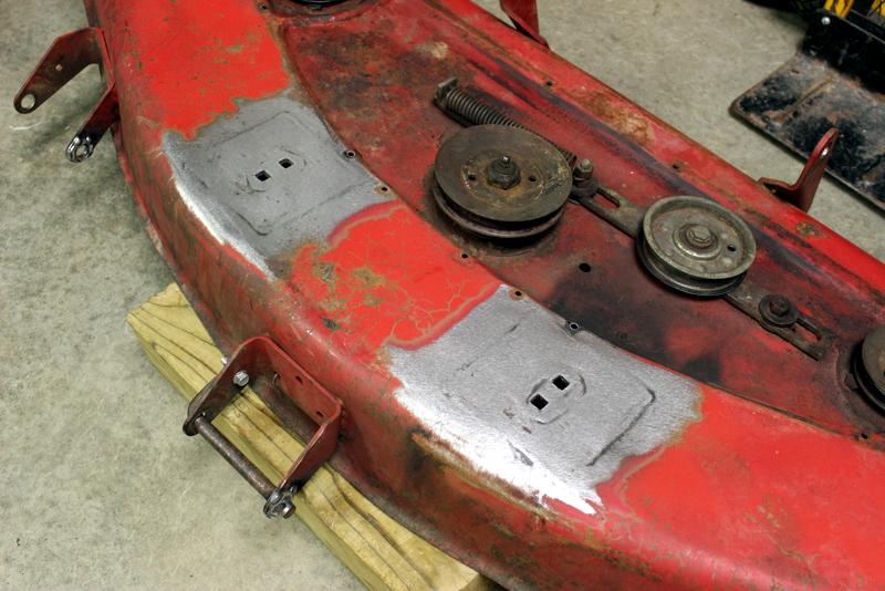

Mr Magoo 226 #21 Posted April 30, 2020 Progress today. Stayed after work for several hours and got some work done on the deck. I made a wrench to hold the nut under the blades out of a piece of 1/4" x 3" flat bar I had in the scrap bin. Punched an 1.125" hole in it on the iron worker and just cut the rest out with a cut-off wheel. Patched and reinforced the holes with 11 gauge steel on the inside. I had a piece of 1/2" stainless rod under my bench so I used it to replace the axle for the two rear rollers. Lastly I made some 1/2" i.d. washers and welded them on the axle brackets for the front rollers. The holes in them were wallowed out to almost 5/8". All new wheels came today in the mail. New belt and nuts for the spindles yet to come. Still a few things to do. 4 Share this post Link to post Share on other sites

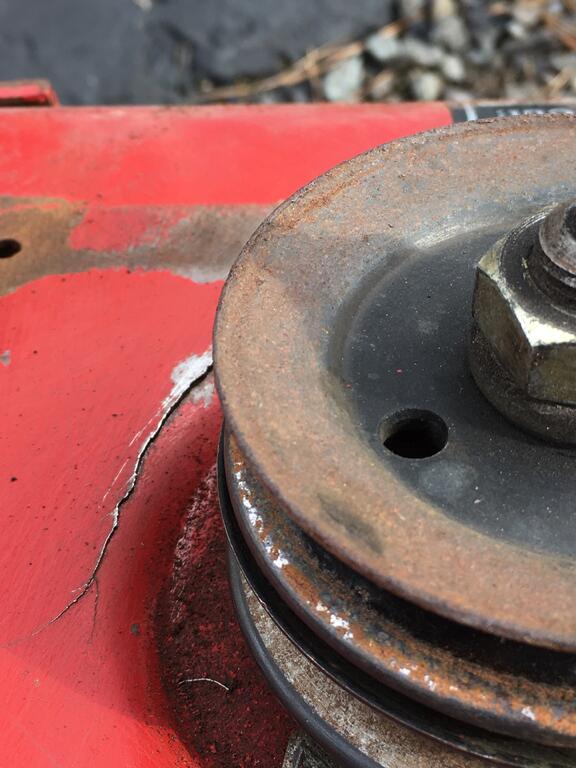

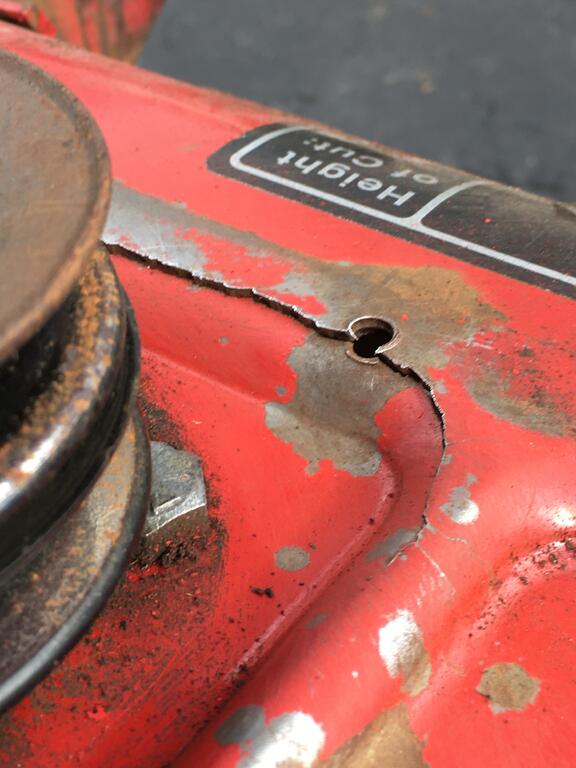

kwalshy 267 #24 Posted May 2, 2020 I too have some deck repair to perform, found this fracture while inspecting the deck yesterday Share this post Link to post Share on other sites
Mr Magoo 226 #25 Posted May 2, 2020 7 minutes ago, kwalshy said: I too have some deck repair to perform, found this fracture while inspecting the deck yesterday I would not be using that deck until it can be repaired. Share this post Link to post Share on other sites
