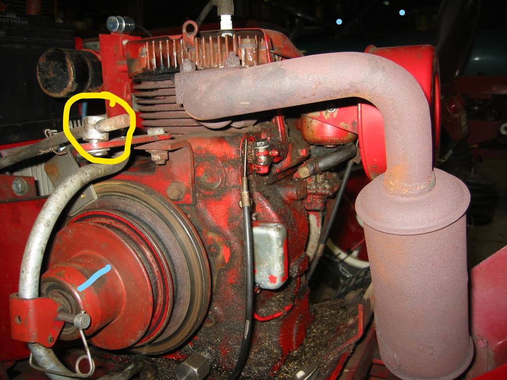

pfrederi 20,870 #2 Posted April 25, 2020 Welcome. Put a piece of colored tape on the PTO bell. Blue) That will give you a visual reference to see if it slows down during the slipping period. If it does tighten the trunion on the end of the PTO engagement rod.(Yellow). 3 Share this post Link to post Share on other sites

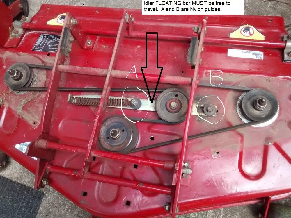

daveoman1966 3,884 #6 Posted April 26, 2020 At # 2, when you put a new belt on deck, did you see that the spring-loaded BELT TENSION ARM was free to float in the guides. It MUST be free to float or the Left / Right spindles will slip a lot. This is common. Be sure there is no debris or rust build-up under that flat IDLER bar. 1 Share this post Link to post Share on other sites
