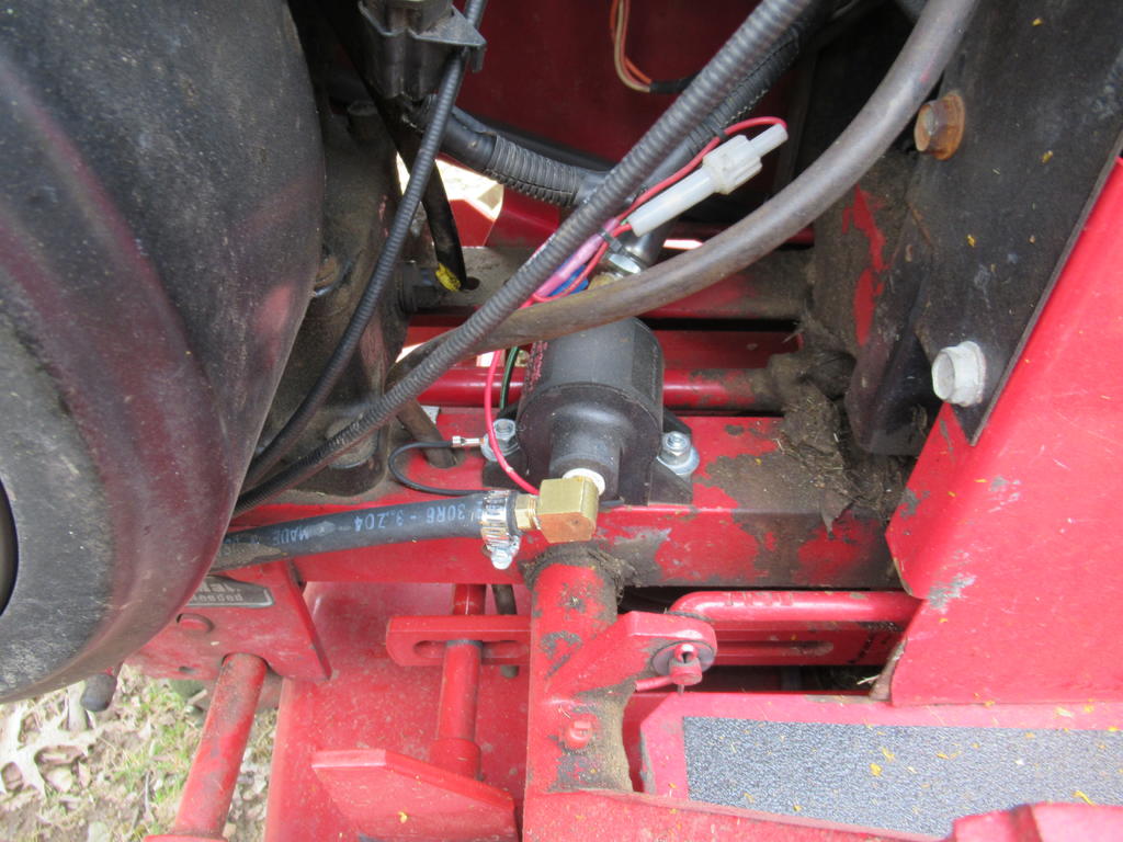

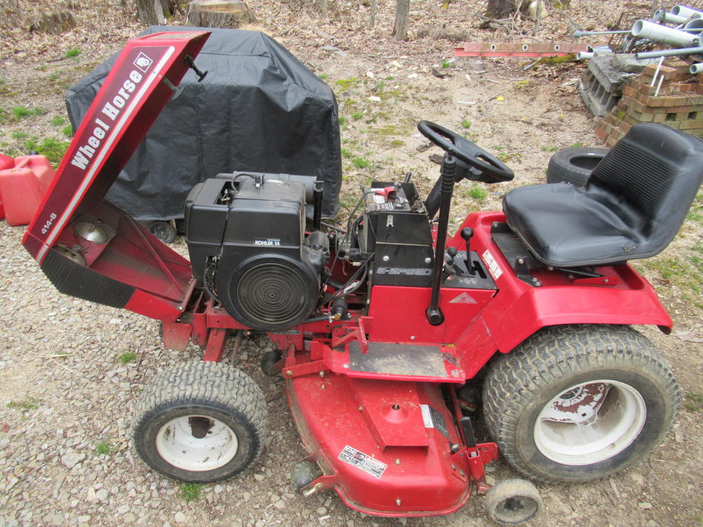

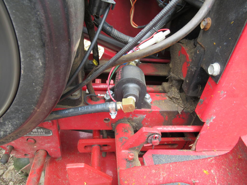

oldlineman 1,810 #1 Posted April 23, 2020 I finally did it and WOW! what a difference in starting. I bought a good pump Faucet 60106 and didn't even have to drill holes. I picked up feed on lighting circuit and since I never use the lights I pulled the ground off the lights so they don't work and installed a 3 amp fuse for the pump per instructions. I leave the light switch on and can shut down if need be with light switch. If you have any fuel pump problems don't hesitate to do this upgrade well worth it. I left the mechanical pump in place and just installed a peace of gas line between inlet and outlet to keep dirt out if I ever want to go back to it but can't see that happening. 4 4 Share this post Link to post Share on other sites

squonk 48,161 #5 Posted April 23, 2020 4 hours ago, oldlineman said: I finally did it and WOW! what a difference in starting. I bought a good pump Faucet 60106 and didn't even have to drill holes. I picked up feed on lighting circuit and since I never use the lights I pulled the ground off the lights so they don't work and installed a 3 amp fuse for the pump per instructions. I leave the light switch on and can shut down if need be with light switch. If you have any fuel pump problems don't hesitate to do this upgrade well worth it. I left the mechanical pump in place and just installed a peace of gas line between inlet and outlet to keep dirt out if I ever want to go back to it but can't see that happening. Do your self a favor.Get rid of that fuseholder and get an holder that uses the blade fuses and a weatherproof cap. The one you used are nortorious for moisture getting them causing corrosion spring failure and eventual heat. 3 Share this post Link to post Share on other sites
oldlineman 1,810 #6 Posted April 23, 2020 good idea I will do that thanks for the idea. Share this post Link to post Share on other sites
peter lena 10,076 #7 Posted April 24, 2020 also dielectric grease the fuse and connections , for conductivity and corrosion resistance , pete Share this post Link to post Share on other sites
