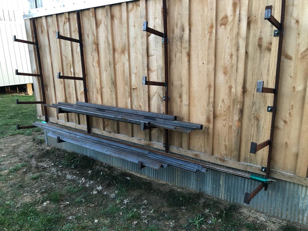

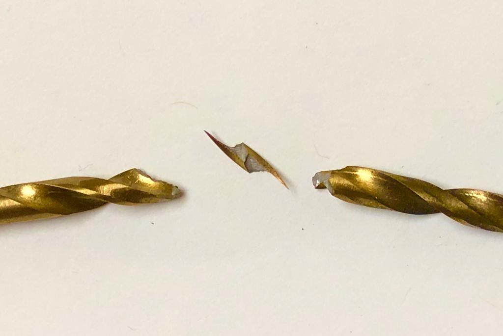

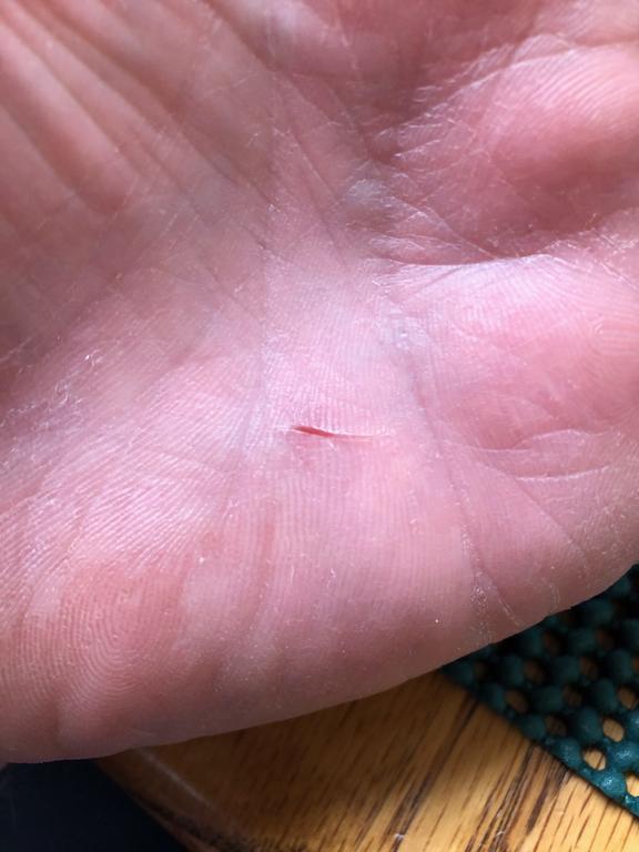

Mows4three 833 #1 Posted April 23, 2020 Hope everyone and their families is safe and doing well in these extraordinary times. With more time on my hands than usual, I set out last week to organize my tractor shed, build an outdoor rack for some steel I use in fabricating and regain some floor space in the shed. All was going well until I needed to drill some pilot holes in the clips that would secure the steel rack to my blacksmith shed wall. I was using an 1/8th Titanium coated drill bit fresh from a new $9.99 black and yellow drill index that I bought with a coupon from a store specializing in cheap tools (are you following me?). Being the frugal and fiscally conservative guy that I am, I have found these bits to be mostly OK. Besides, this was pretty much a spur of the minute project and who wants to run to the tool cabinet to get the good bits when the chinesium bits were right beside the drill press, right? As I was drilling the third pilot hole the drill began to chatter and pop. I’d never experienced this in the past. Small chips started to bounce out of the steel so I instinctively put my hand up to contain them to the drill press table. That’s when the bit snapped and I received a shard of the drill bit in the palm of my hand. This was no big deal at that point until I started wondering what COULD have gone wrong. First off, I was wearing PPE on my eyes. I never do anything in my wood shop, blacksmith shed or on a job without it. If I hadn’t had my hand up, the shard that imbedded itself in my hand was headed, like a rocket, for my face and possibly my eye. Secondly, I should have stopped drilling when I encountered the aforementioned chattering and popping (I’m a backyard hack, not a disciplined machinist so no snarky keyboard comments, please). Third, I shouldn’t place as much trust in a set of $9.99 drill bits as I did and I should start using better tools. Lesson learned: THINK AT ALL LEVELS. Simple stuff can get you in trouble when you’re in the shop and not thinking. Cheers! Dave Here are a couple photos of the culprit and the damage: 7 1 Share this post Link to post Share on other sites
WHX?? 58,236 #2 Posted April 23, 2020 Don't know whether to cry about the hand or give a thumbs for the nice racks. I bought the same drill set and pretty much use them once...maybe twice and throw them out! 1 Share this post Link to post Share on other sites

WVHillbilly520H 10,379 #7 Posted April 23, 2020 Has been my experiences ,Even in a "well" equipped industrial factory machine shop you encounter drill bits that are "harder" than normal that also "explode" when encountering unexpected grains in the material you are drilling lube of some sort helps lessen this but still happens no matter the brand... But it does happen more often with any off the offshore versions vs USA, Japan, or German. 1 Share this post Link to post Share on other sites
formariz 12,381 #8 Posted April 23, 2020 (edited) I had similar experiences in the past although bits did not break .Perhaps because once I felt the vibration I stopped and looked at them. These were actually 3/8" bits being used on the drill press. Upon inspection, edge was totally gone or looked serrated with chips on it and sort of rounded over. I have never been a fan of titanium coated bits. Good quality ones are OK until dull. Once sharpened the coating is gone from where it matters and then it is just like a regular bit. It is then also that one notices that its quality is inferior since that edge will never last again. Hence all the titanium bits here going to the garbage as they get dull. I have here American made bits used for the last 30 years sharpened countless times to the point that they are just stubbies. Over the years I have on occasion fallen to the lure of the newest and better bit and purchase several time those titanium bits only to realize immediately after what a mistake it was. Very nice rack Edited April 23, 2020 by formariz 1 Share this post Link to post Share on other sites

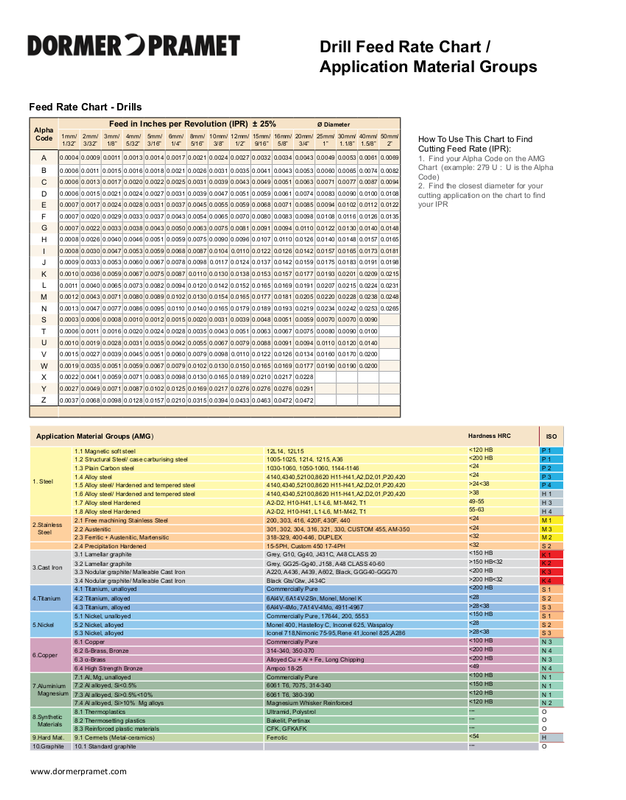

bc.gold 3,406 #16 Posted April 23, 2020 Here's a drill bit speed chart. 3 Share this post Link to post Share on other sites

Mows4three 833 #19 Posted April 24, 2020 22 hours ago, bcgold said: Here's a drill bit speed chart. Thanks for the chart. It’s really good info to have. It would defiantly be applicable to work done with decent drill bits. I am pretty convinced this bit broke due to inferior workmanship or materials. Dave 1 Share this post Link to post Share on other sites
