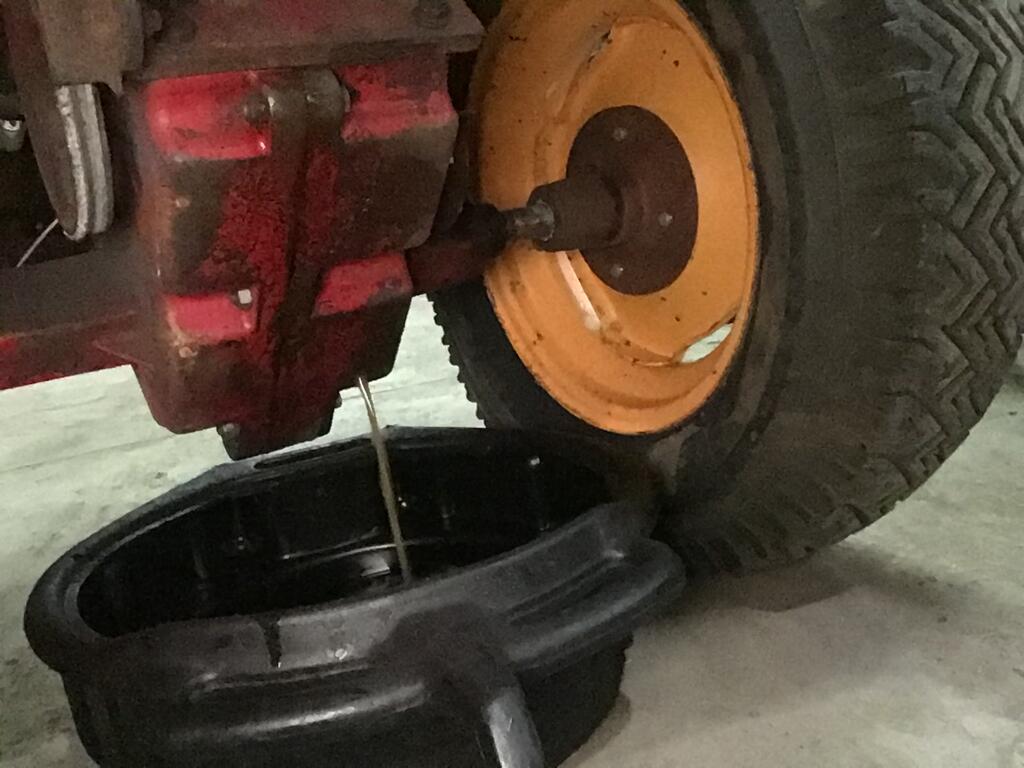

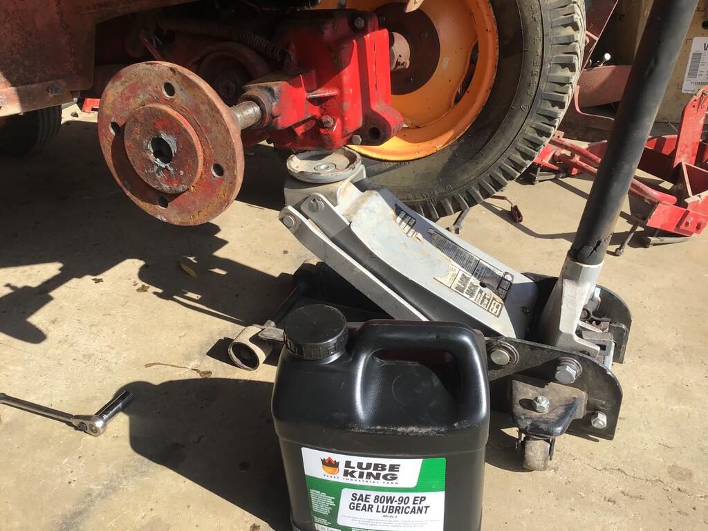

Pullstart 70,694 #76 Posted October 16, 2020 Draining the diesel from the transmission... 1 Share this post Link to post Share on other sites

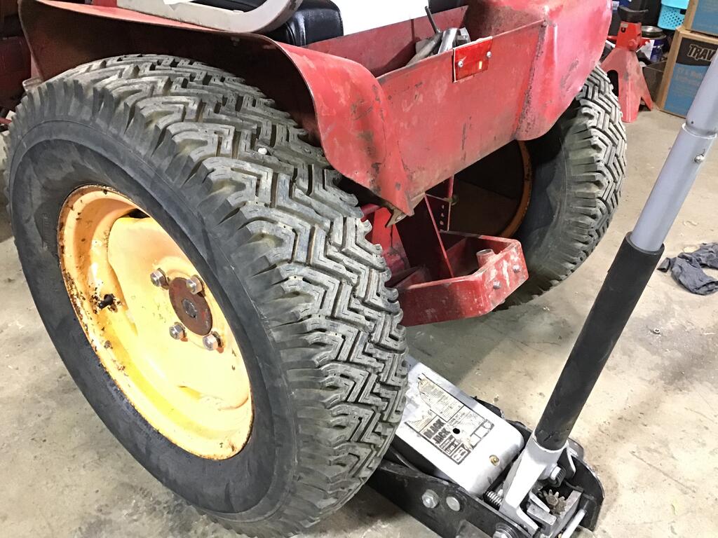

Pullstart 70,694 #77 Posted October 16, 2020 Jacking the left side up a ways, I was able to get close to 2 qts in. I figure if 2 is good for the limited slip cases, it might as well be good for this! 2 Share this post Link to post Share on other sites

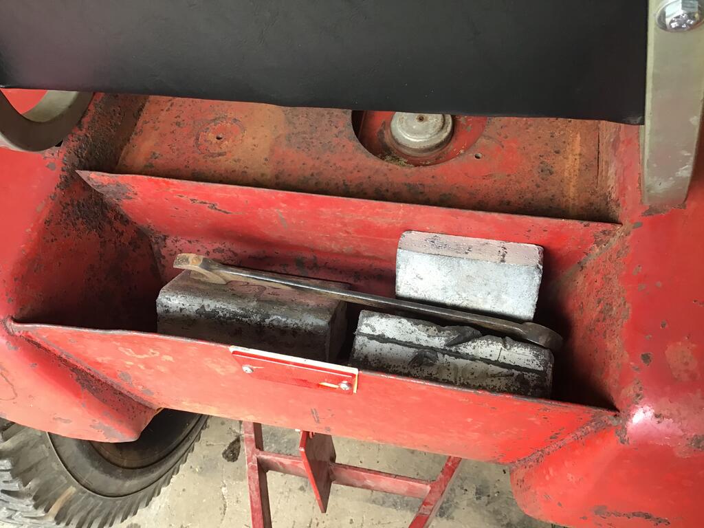

Pullstart 70,694 #79 Posted October 16, 2020 Other than wheel weights, the lead is holding this thing down! 1 Share this post Link to post Share on other sites

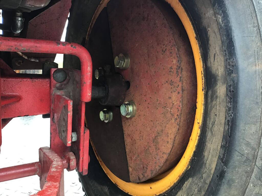

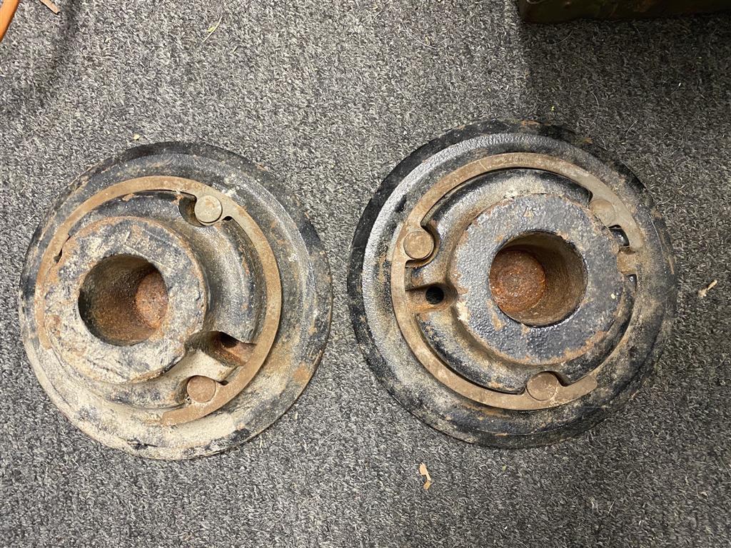

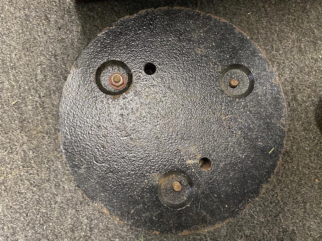

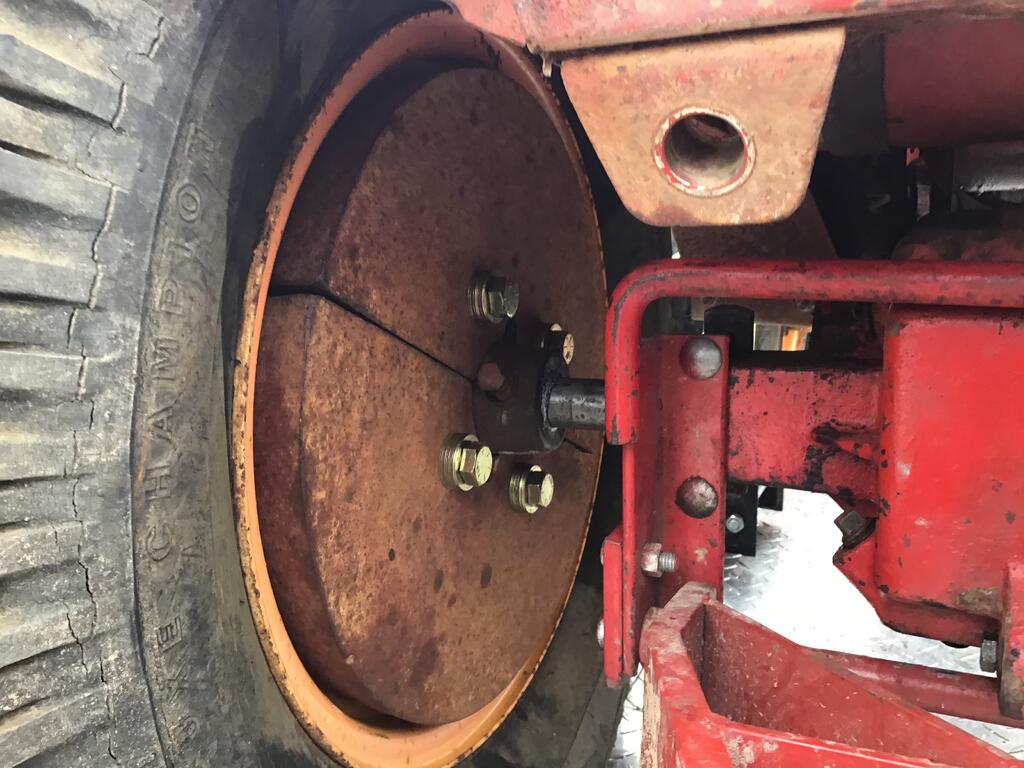

Pullstart 70,694 #81 Posted October 17, 2020 Got my BoltDepot order a couple days early! Inside wheel weights, here we come! 1 Share this post Link to post Share on other sites

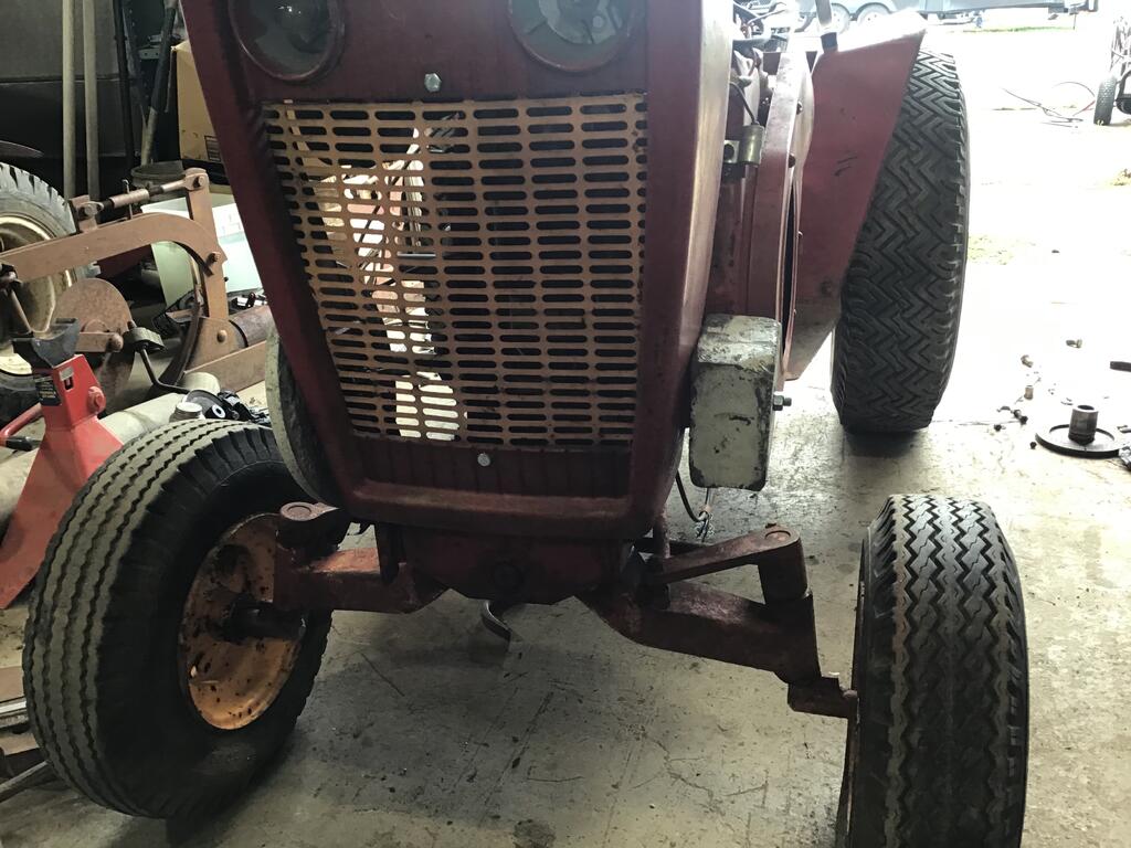

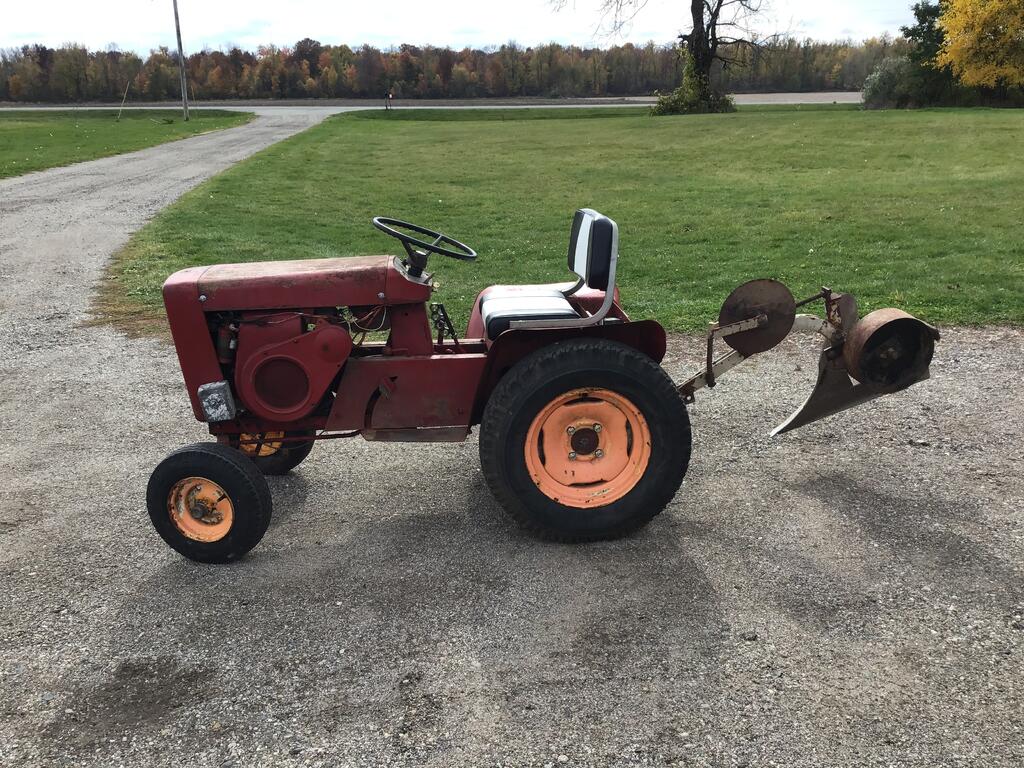

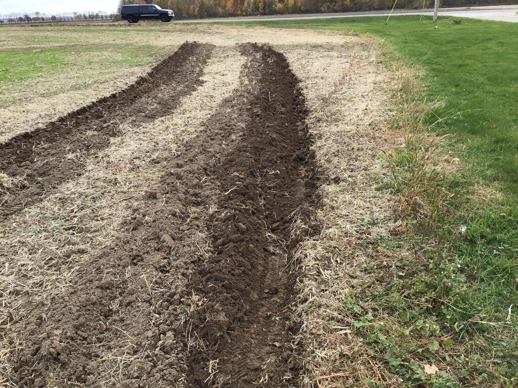

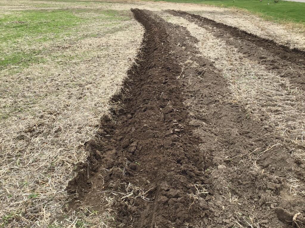

Pullstart 70,694 #82 Posted October 20, 2020 A bit of an update... the Fastenal RX keys were just the ticket to get this back together! It’s a monster! I think I’ll see about getting more weight up front, it is actually a bit light in the steering while it’s plowing. In the video I’ll post, the engine was bogging. I found a bit shorter and heavier spring on another 10 horse throttle assembly and swapped it out. Big difference, no more bogging... in fact power to spare! 1 Share this post Link to post Share on other sites
Pullstart 70,694 #84 Posted November 4, 2020 I figure I should update this thread. Rebel had a wiring melt down before a Rylee got to do any plowing. I have sold the inside wheel weights and plan to convert to 12” wheels like Joe the 1054. The 7” tires will move to this one, the 10” on Joe. I am unsure on exactly what engine this’ll get, but it’s getting more power and thanks to @prondzy’s suggestion, a starer/stator setup instead of S/G. Less rotating parts, less power rob, less to go wrong. 4 Share this post Link to post Share on other sites

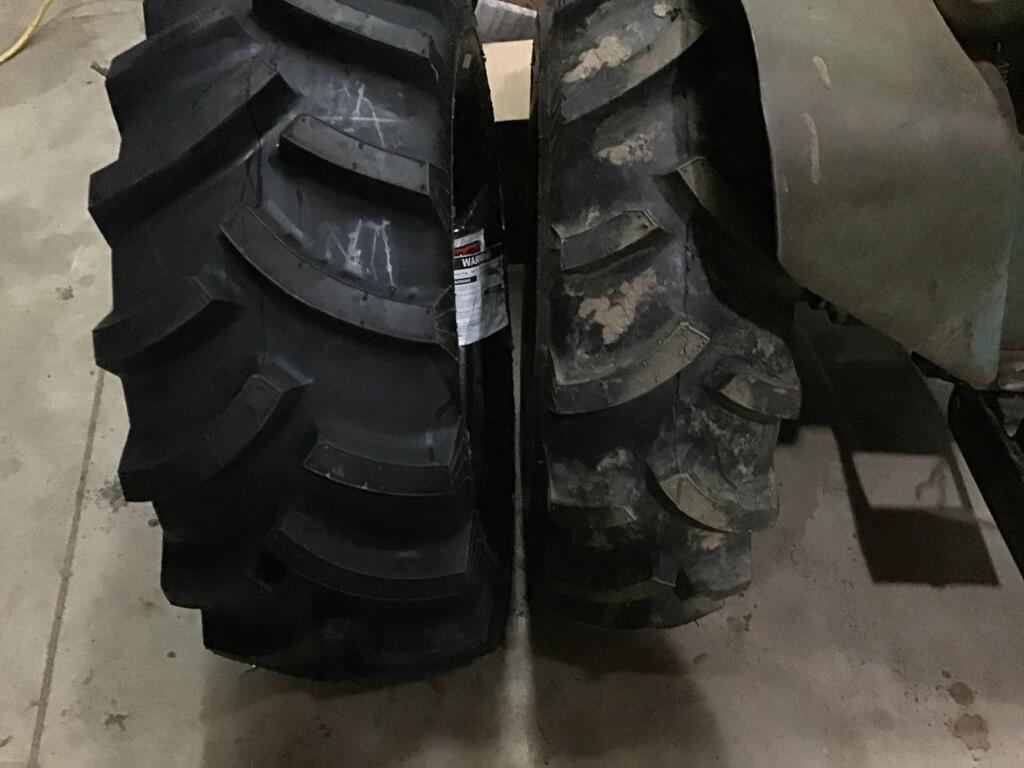

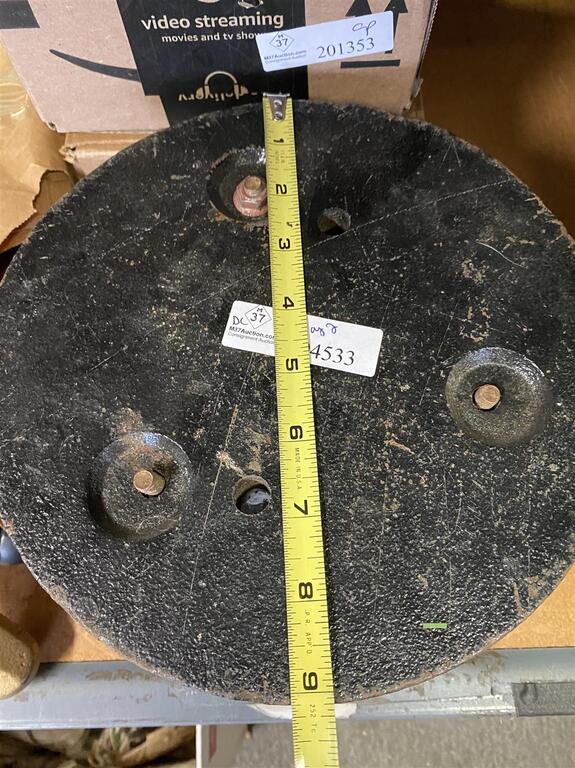

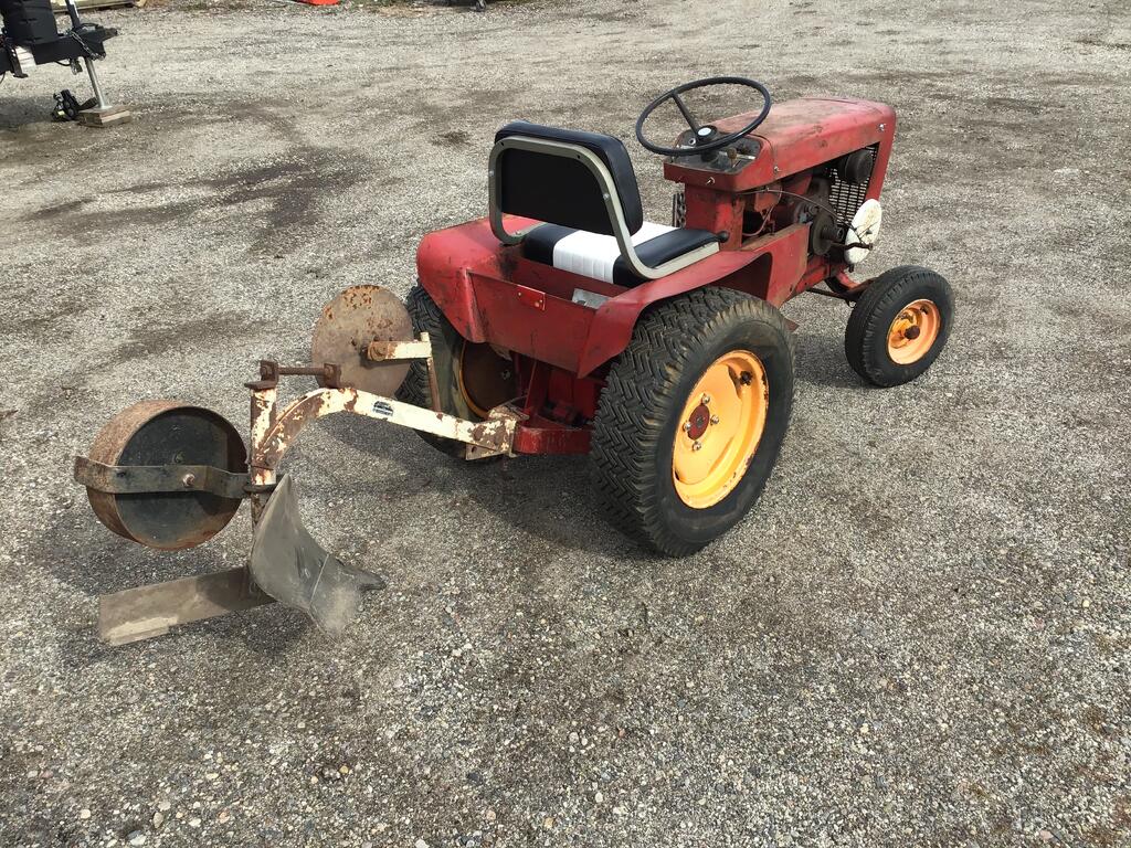

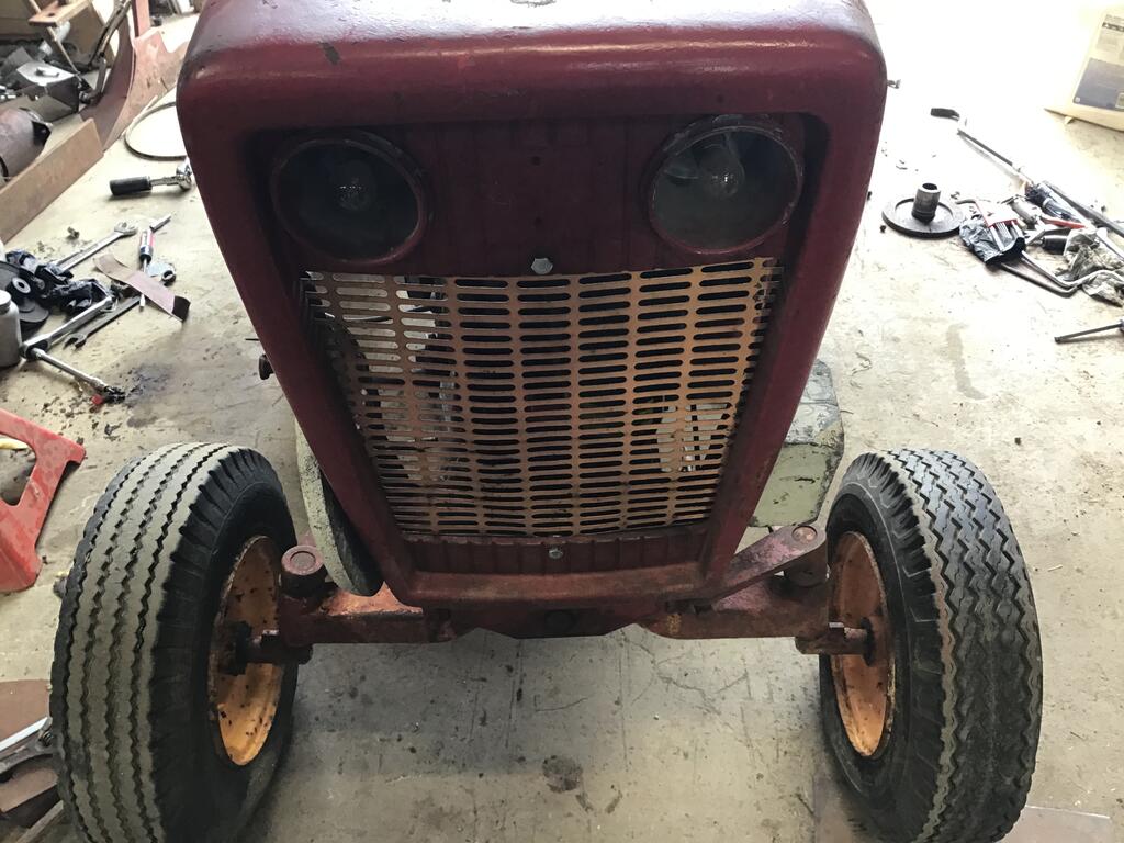

Pullstart 70,694 #85 Posted November 4, 2020 Tonight, I scored a set of front weights for a song at a local auction. Yee haw! 3 Share this post Link to post Share on other sites
prondzy 3,889 #86 Posted November 4, 2020 We will turn you into a real plow dog one of these days, yer learnin! 1 1 Share this post Link to post Share on other sites
Pullstart 70,694 #87 Posted November 4, 2020 1 hour ago, prondzy said: We will turn you into a real plow dog one of these days, yer learnin! thanks for learnin’ me a bit at a time! 2 Share this post Link to post Share on other sites

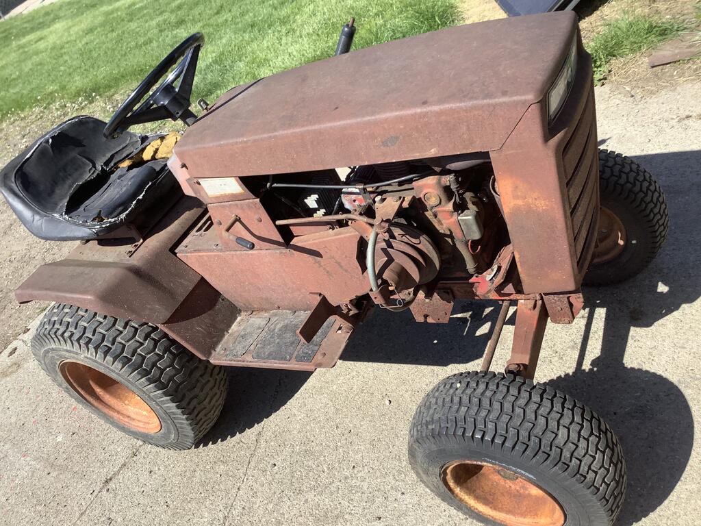

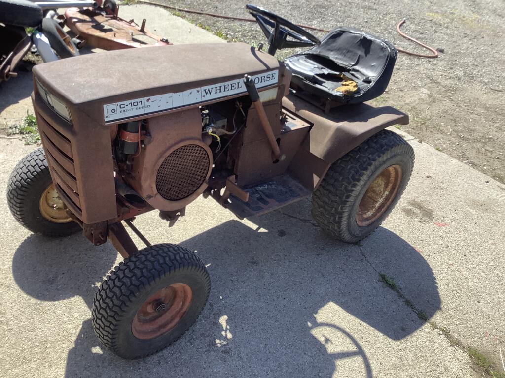

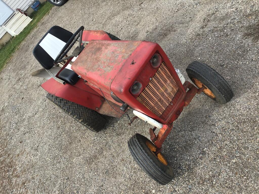

Pullstart 70,694 #91 Posted May 13, 2021 Rebel may have received a donor that still has magic smoke inside! Thanks for stopping by today @Bentoolong! For now, I might stick a deck on it and mow the back field/yard for a bit... There’s a pretty cool patch on the lower half of the flywheel shroud... I think I like it! 2 3 Share this post Link to post Share on other sites
