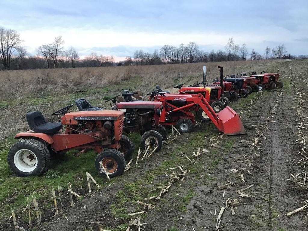

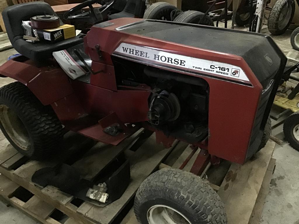

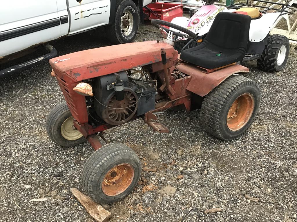

Pullstart 68,880 #1 Posted April 22, 2020 So after pulling the tractors out last weekend, I realized Chief and Big Junky are both tractors that I shouldn’t let anyone drive. The motion controls are sloppy, steering is sloppy, just not safe when children are very often a mix in my tractor world. They both run great and would be better off as donors to make other tractors run happy. First, Big Junky the 1076 will be stripped of his engine for Scoop the C-161 black hood. We have some friends looking for an affordable entry into plowing at the farm for their kids. I’m planning on looking at a GT-14 package soon and plan to have Scoop and the better GT-14 prepped to go to their greener pastures. I introduced on of the kids not too long ago, he’s the 14 year old running a beef farm. He’s up to 30 something head of cattle and is a big John Deere fan... up until he saw our Wheel Horses ❤️ As for the other GT-14, I believe it’s a mostly complete basket case other than an engine. Chief’s 16 horse Kohler will be a perfect candidate for that project! Stay tuned... 4 2 Share this post Link to post Share on other sites

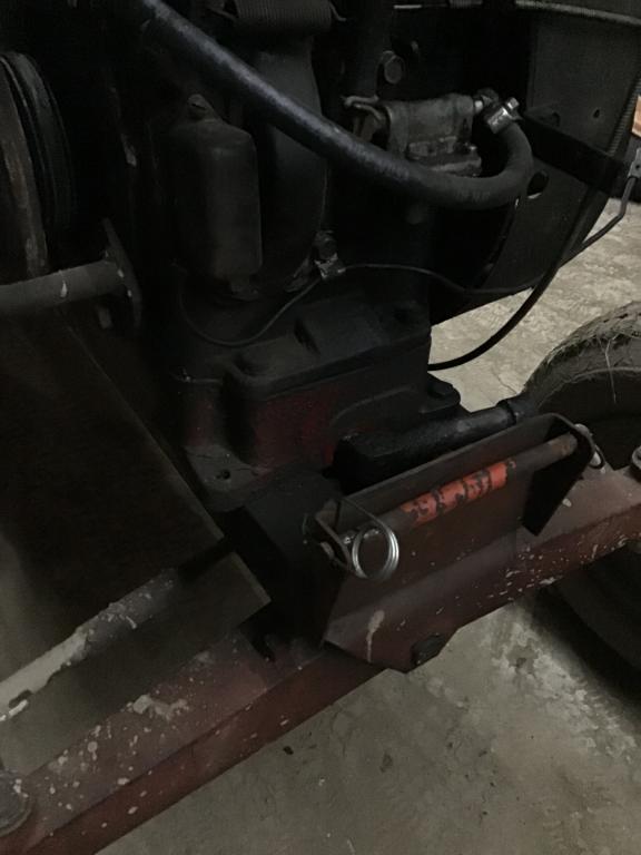

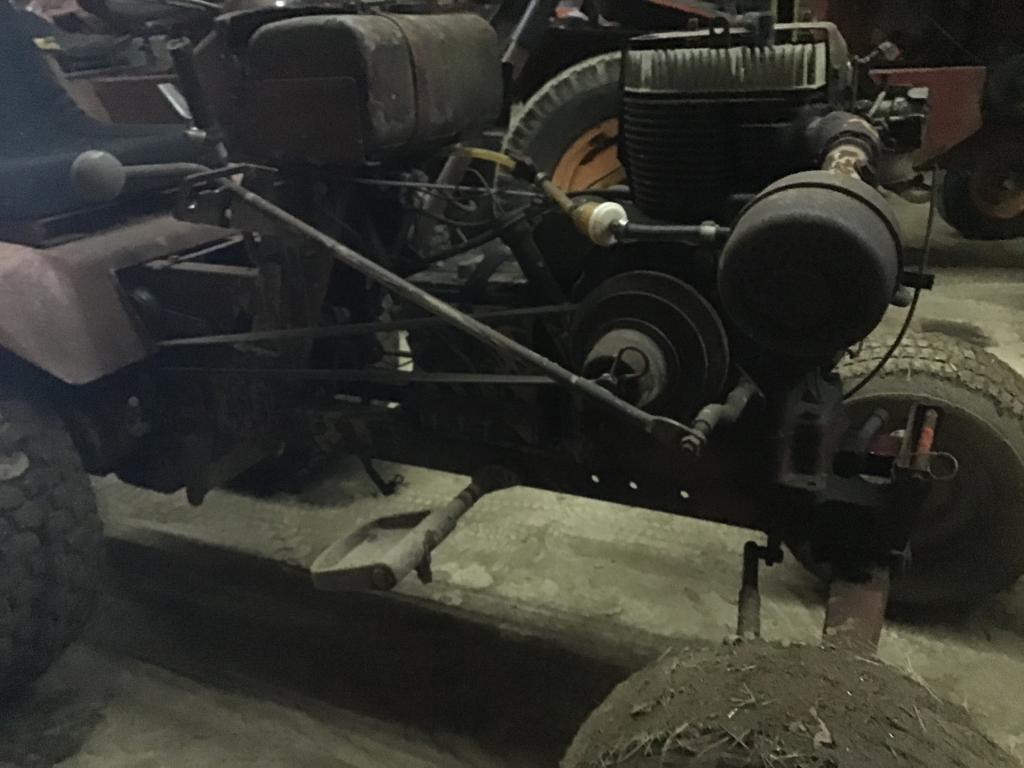

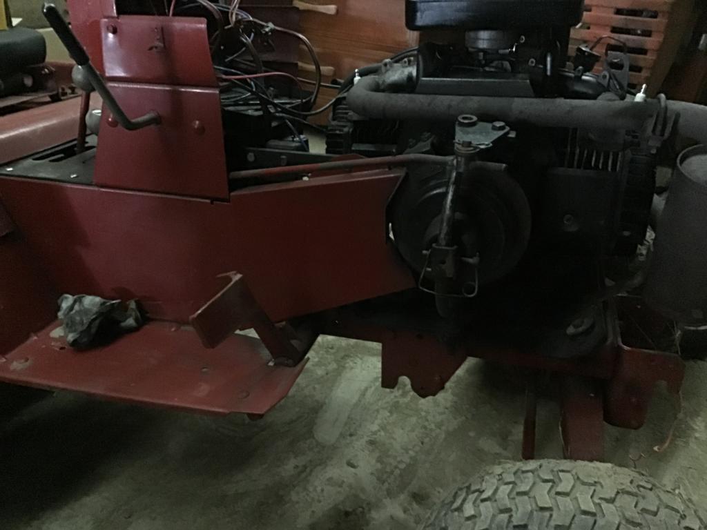

Pullstart 68,880 #17 Posted April 30, 2020 I realized Big Junky and Scoop were next to each other. I started taking measurements and comparing differences. The Kohler is mounted direct to the frame with a tall oil pan. It is 1/2” shorter to the crank than the Briggs. The PTO systems are different and the C series utilizes the shaker plate for the bell hoop. I have a C-101 Kohler shaker plate and shorter oil pan. Does anyone know if the pans will swap, or does the deep pan Kohler have a longer dipper? I might just find myself re-reading the big block oil pan sticky... I’m not against adapting the old style PTO rod to the C series horse either, if that needs to be done. Share this post Link to post Share on other sites
mark in ny 27 #18 Posted May 1, 2020 7 hours ago, pullstart said: I realized Big Junky and Scoop were next to each other. I started taking measurements and comparing differences. The Kohler is mounted direct to the frame with a tall oil pan. It is 1/2” shorter to the crank than the Briggs. The PTO systems are different and the C series utilizes the shaker plate for the bell hoop. I have a C-101 Kohler shaker plate and shorter oil pan. Does anyone know if the pans will swap, or does the deep pan Kohler have a longer dipper? I might just find myself re-reading the big block oil pan sticky... I’m not against adapting the old style PTO rod to the C series horse either, if that needs to be done. I believe the shaker style pans are the narrow base while bolt to frame are the wide. I dont believe you can swap them over from a shaker to wide because of bolt pattern. That said I asked a little bit ago and most seem to use spacers without the shaker. Share this post Link to post Share on other sites
Lee1977 7,552 #19 Posted May 1, 2020 Changing from short pan to deep pan is like Johnie Cash's Cadillac all the holes will be gone. 1 Share this post Link to post Share on other sites
