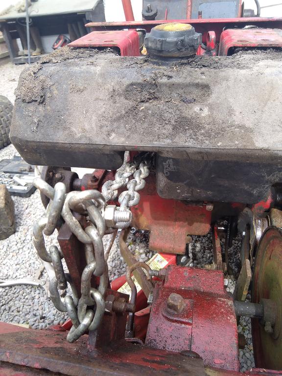

Dan.gerous 2,696 #14 Posted April 23, 2020 Messing about today, getting rid of nails holding bits together and putting the brakes back on I noticed that my tiller attachment seems different to standard. There was a long bolt on the chain that was slowly eating into the plastic fuel tank and I had to do a few more alterations to get everything to lead through the tunnel without touching. It looks like there should be a steel bar rather than a chain. Also noticed the gearbox oil is looking a bit milky.... 14 hours ago, roadapples said: 1 Share this post Link to post Share on other sites

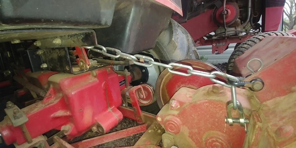

lynnmor 9,051 #16 Posted April 23, 2020 (edited) Your chain should look like these:chain Only one row of links go in there and the long link connects. Edited April 23, 2020 by lynnmor Share this post Link to post Share on other sites

Dan.gerous 2,696 #18 Posted April 23, 2020 2 hours ago, ebinmaine said: Could catch on that fuel tank The chain clears fine, the photo is a bit misleading. There was a bolt that was about an inch too long up at the wire end that was digging into the tank. I put in a shorter bit and clearance is now fine. Also stole a spring off the trampoline to help lighten the lift, it makes a reasonable difference. Share this post Link to post Share on other sites

Dan.gerous 2,696 #22 Posted April 23, 2020 1 hour ago, Dan.gerous said: I might single it up for a cleaner run a bit more like yours, at the moment the chain is doubled back. 2 hours ago, c-series don said: I’ve never seen that piece that your chain is attached to. I know it may not be correct but I have always just run a cable from the rockshaft out to a small length of chain to the tiller. Now I'm inside for the evening had a look again at your pictures, I see what you mean about the extra bit on mine. I'm going to remove it tomorrow as all it does is bend the pipe bracket that the lift wire goes through due to a bad lead - any mechanical advantage can only be minimal for making lifting easier. The while setup should look a lot better - will post updated pics in the morning. 1 Share this post Link to post Share on other sites

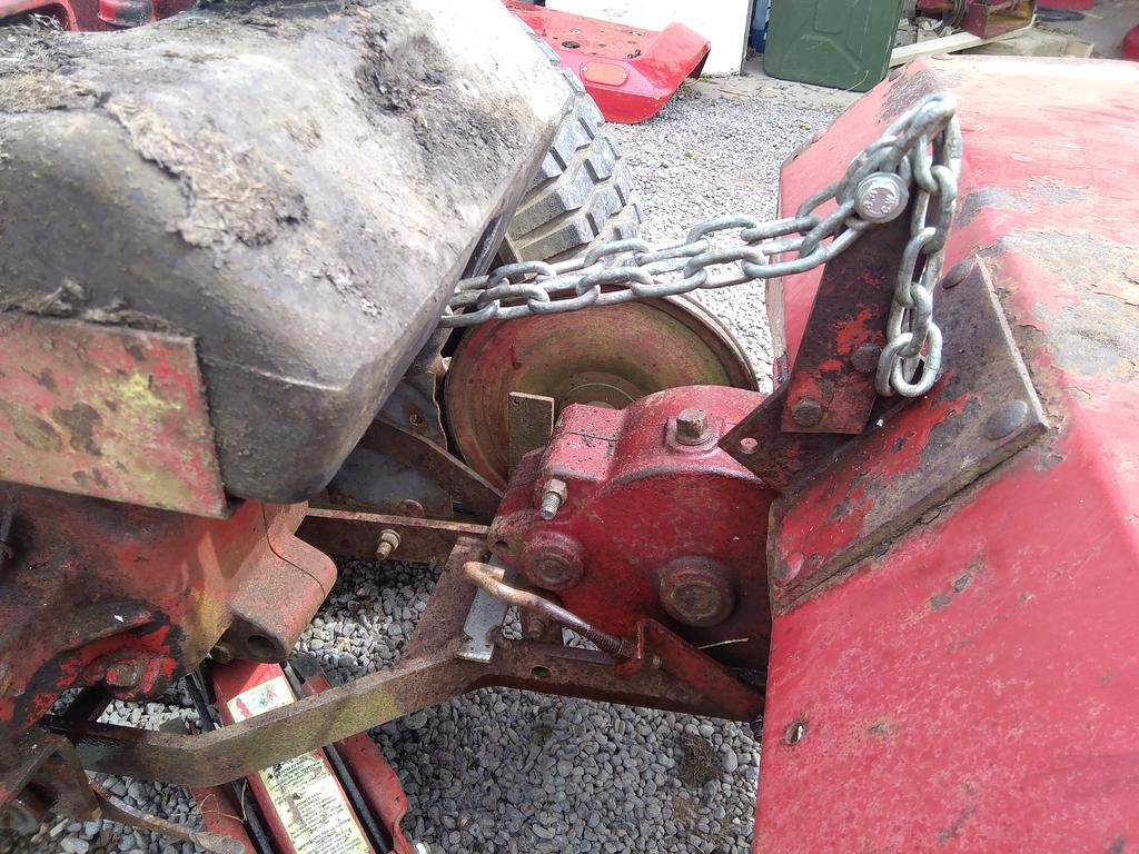

WVHillbilly520H 10,379 #23 Posted April 23, 2020 5 hours ago, Dan.gerous said: Messing about today, getting rid of nails holding bits together and putting the brakes back on I noticed that my tiller attachment seems different to standard. There was a long bolt on the chain that was slowly eating into the plastic fuel tank and I had to do a few more alterations to get everything to lead through the tunnel without touching. It looks like there should be a steel bar rather than a chain. Also noticed the gearbox oil is looking a bit milky.... Where the chain mounts on your tiller someone before you must have added the extra piece of metal to get a higher lift... The chain actually attaches to the bottom hole you show there with a small clevis... If I remember when I get home I'll get a pic of my set up. 1 Share this post Link to post Share on other sites
Dan.gerous 2,696 #24 Posted April 23, 2020 5 minutes ago, WVHillbilly520H said: Where the chain mounts on your tiller someone before you must have added the extra piece of metal to get a higher lift... The chain actually attaches to the bottom hole you show there with a small clevis... If I remember when I get home I'll get a pic of my set up. The way it is now is putting a lot of stress on the mounting plate, will get rid of that extra bit for sure. Share this post Link to post Share on other sites
WVHillbilly520H 10,379 #25 Posted April 23, 2020 2 hours ago, Dan.gerous said: The way it is now is putting a lot of stress on the mounting plate, will get rid of that extra bit for sure. Here you go... 1 2 Share this post Link to post Share on other sites
