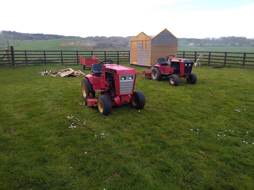

Dan.gerous 2,696 #19 Posted April 23, 2020 (edited) The horses lined up for trials. The shed in the background will be about four times longer once the greenhouse and tractor parking shed are put into the end of it, and phase one of the garden will be next to it. Getting materials is holding me up at the moment. Edited April 23, 2020 by Dan.gerous 1 1 Share this post Link to post Share on other sites
