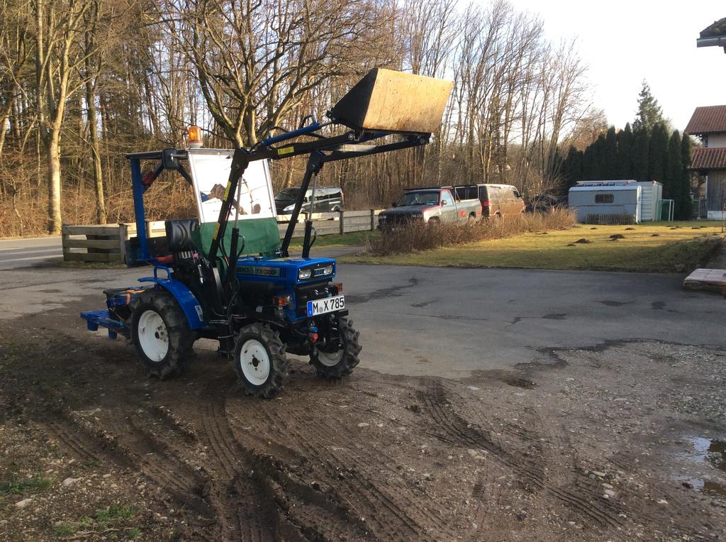

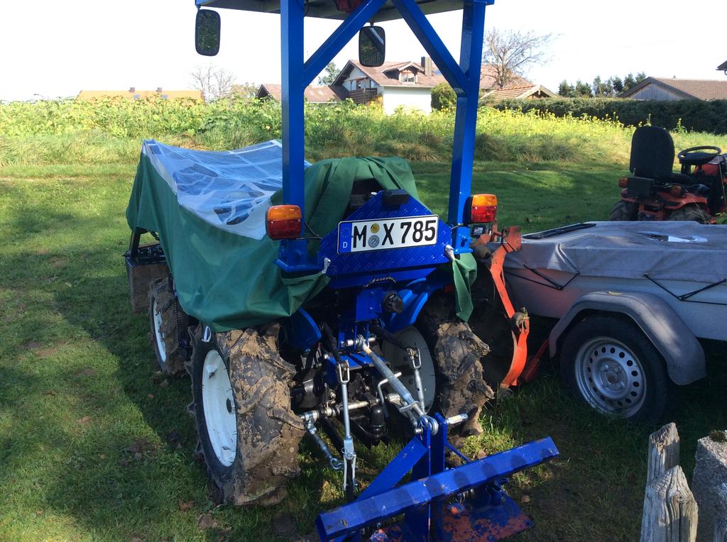

Tractorhead 9,217 #10 Posted April 21, 2020 I can give you some hope, I did it with my Beast. I don‘t know your actual road approval certification, but as long as brexit is not finally past, you can made it based on EU Rights.. Mine is a Iseki Brand, but i tried that also ahread with my Wheelhorse. The approval Type was here Called Zugmaschine Ackerschlepper, what means Agricultural puller. Therefore i needed followed issues to solve: 1. Headlights and park light, where headlights must go with key on ignition, parklights must be able to switch without key. 2. Flasher left and right and even Accidental flash, can be with an control light but must not, a beeper to remind is ok. 3. A coupling possibillity for Trailer with approoval for an ability to pull more than 450Kilos with electrical coupling for lights like a Cartrailer or similar. I used a 13pin Cartrailer connector i had in spare. 4. At least one rear mirror, i used two on the Beast 5. A footbrake with an option for a continouse engage 6. The brake must be able to stop the allowed Load on a slope of 15%, including Trailer without overload the Brakes. Because it is an Agricultural puller an Engine certifcate wasn‘t required here at all 👍 as long as brexit is not finally passed, maybe that is a Way you can go. except points 6,5 and 4 it was closely but i fail with my Horse, because the brakes are definitely too weak dimensionated. They could be improved, but needs an separately certification run, what costs additional 1200€ Incl. Approval, so i stopped that and try it on my Beast with same Scenario, because it has massive better Brakes they allowed up to 1,9 Tons of pulling load at 15% slope. The Brake test was doing simply in a real driving test. We hung a trailer on, loaded with Lift weights to it‘s maximum and give me a Way with 2 bars i must stop in between. The Test was a Success and i get my road approval. Additionally i agreed to another Approoval for the FEL, that it can stay permanently mounted on my Tractor. also that was Success, but that cost me all together 1000€ Added for this approval. Because it is my Hobby and i love it to drive also along the Road legally and even my FEL is completely selfmade, i invested that Money. I didn‘t see it as a waste of Money, because hobby means doing things with minimum effect by maximal cost.😎 So my answer is just, try it and ask, hopefully you get same results as i did. This horse failed, because of too weak brakes, compare of the dimensions aaaaand Road approval successfully. And one of my „Tours“ i did with it to a Friend‘s property several Km‘s far. Greetings from South Bavaria 1 Share this post Link to post Share on other sites
ebinmaine 80,755 #11 Posted April 21, 2020 1 hour ago, Tractorhead said: hobby means doing things with minimum effect by maximal cost I love that! That should be on a flippin t-shirt.... 1 Share this post Link to post Share on other sites

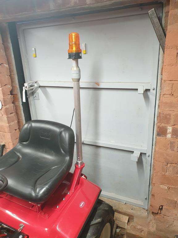

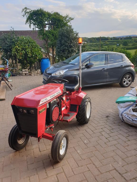

Mickwhitt 5,259 #15 Posted April 26, 2020 I decided to do a bit of fabrication work today and made a mounting bracket for my amber warning beacon. I had a curious length of aluminium tube which was telescopic with a locking collar which I thought would make a good mast to mount a light on as I could extend and retract it. I puzzled where to fit this to Fred and decided on the seat pan. Bit of welding and turning and I'm happy I have the basis of my light mast. Just need to make a mount for the light itself to fit the too end of the tube. This is something that is only required for a vehicle incapable of exceeding 25mph being driven on a deristricted dual carriageway, in England a 70mph speed limit. I dont think I will be trying that out any time soon. 2 4 Share this post Link to post Share on other sites
SylvanLakeWH 32,569 #16 Posted April 26, 2020 Nice work! That seat pan mount looks factory!!! 1 Share this post Link to post Share on other sites
Mickwhitt 5,259 #17 Posted April 27, 2020 Hi all, I finished my amber beacon job off today, managed to get the mounting sorted and wire the switch into the dash. It's a little twin rocker switch, one on/off and one momentary switch to swap between 9 different flash modes. 6 1 Share this post Link to post Share on other sites
