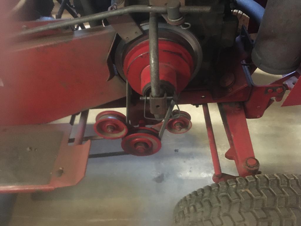

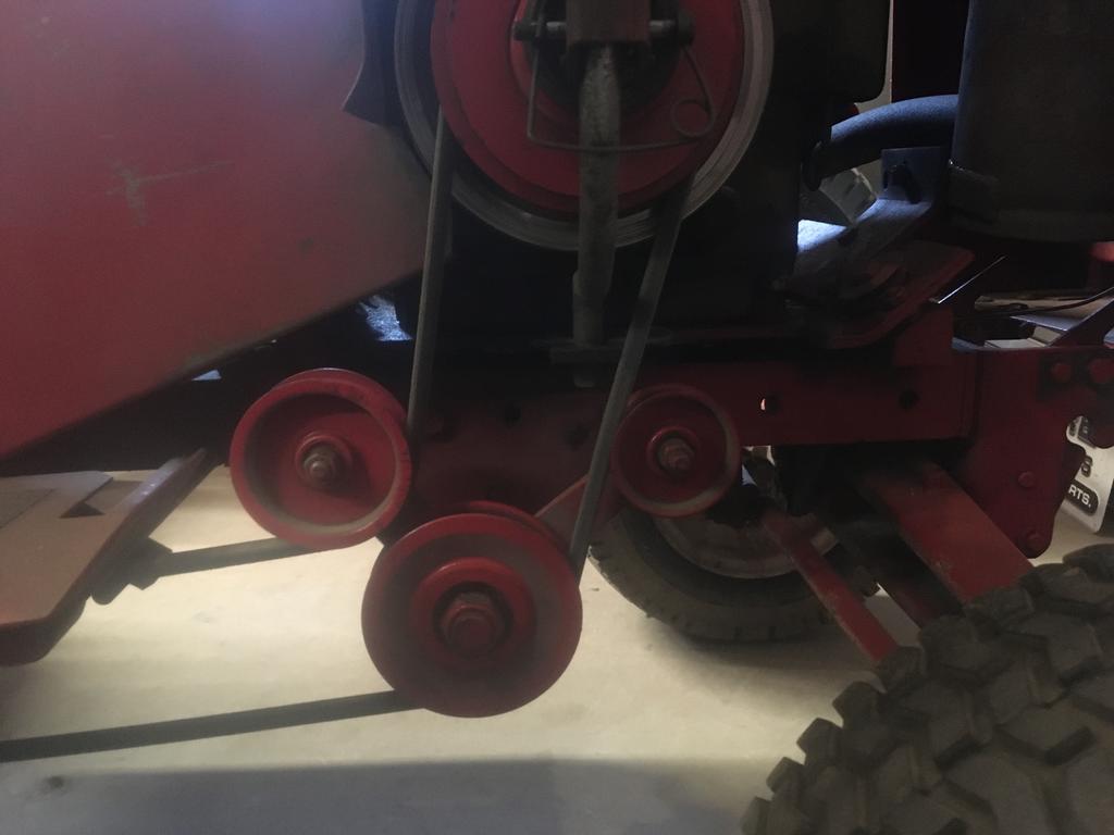

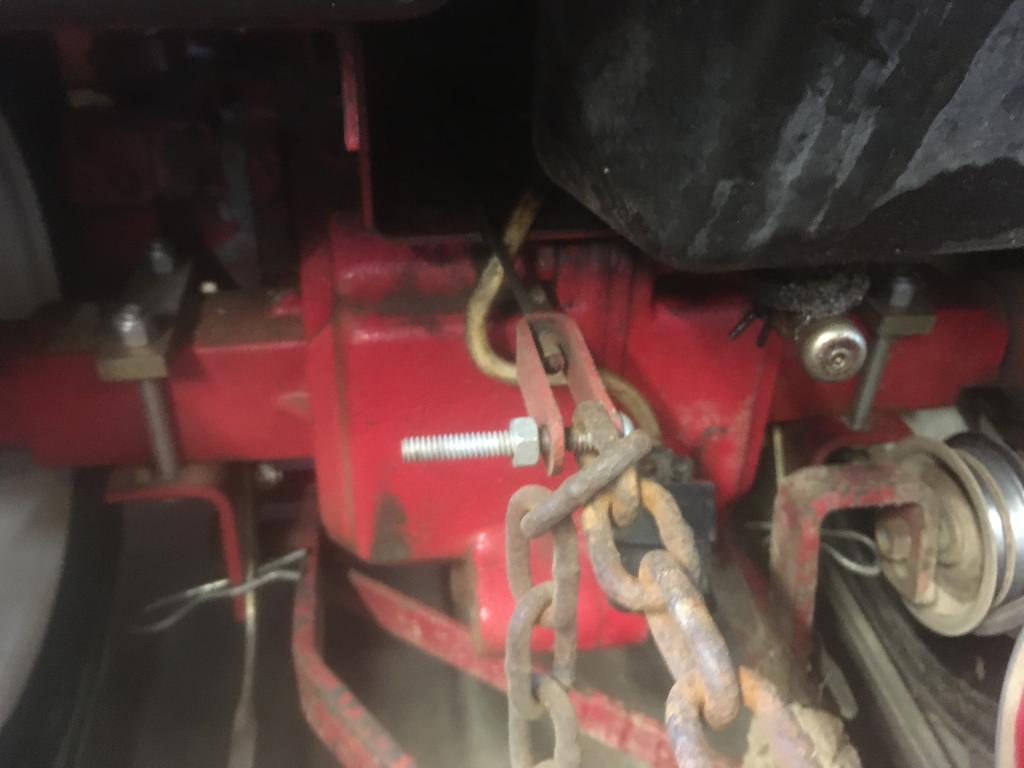

c-series don 12,363 #3 Posted April 21, 2020 You are correct, you will need a center mule drive which clips into the center tach-a-matic and rear axel bracket. Here’s a couple of pictures. 1 Share this post Link to post Share on other sites
briankd 833 #4 Posted April 21, 2020 well the tiller was a bust but still looking around for one reasonable priced but there are 3 tractors c-81 - c-120 auto - c-121 auto snow blade - blower - decks - homemade vac - homemade boom sprayer guess im going to pass on this tractors look decent in pics anyone interested pm me thanks for the pics Don at least i know what i need when i find one Brian 1 Share this post Link to post Share on other sites
