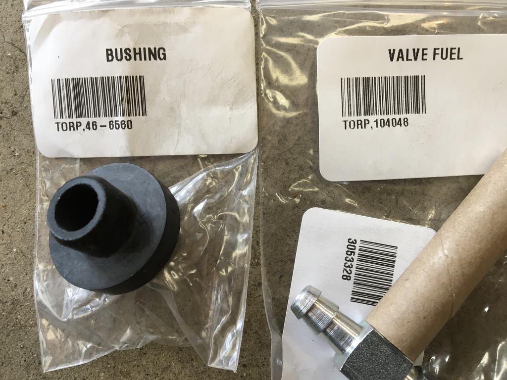

two horser 11 #5 Posted April 20, 2020 Yes it is the plastic tank, so from what I'm seeing all I do is pull the shutoff valve first than remove the bushing and replace with new one then replace the shutoff valve. As always you can count on this forum and the guys on it to come up with the fixes. Restoring a GT 1600 workhorse have most of it together filled tank starting leaking from the bushing must have lost seal when pulling the fuel line when I pulled the tank. Getting ready to paint the sheet metal tractor is looking good frame up resto can't wait to finish. Thanks to all who replied Twohorser 2 1 Share this post Link to post Share on other sites

two horser 11 #8 Posted April 29, 2020 I found the parts on ebay for $8.94 for both bushing and shutoff valve free shipping worked out great. Used a little lithium grease for reinstalling them. 1 Share this post Link to post Share on other sites
