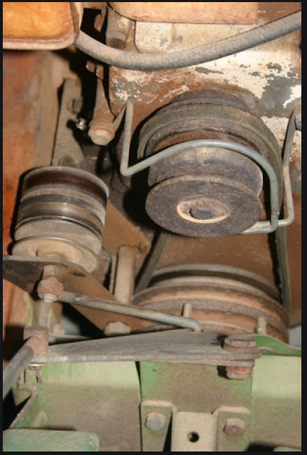

BrianX128 115 #1 Posted April 20, 2020 I've got a pretty old Montgomery Wards Tiller that runs great, I've been using it after I get my garden tilled up with the newer bigger cub tiller I have, my dad and I trade off tillers throughout the year and one of the reasons why is using the old wards one gets tiring as it only goes forwards and it's super heavy. I looked up online how the models that have reverse accomplished it, and it's just by running a belt over another idler vbelt pulley on the shaft the main idler is on, just running the belt over top of the pulley, and having it cross over as it goes down to the drive area to spin the tines backwards. My tiller already has the right pulley on the engine and the drive shaft, just doesn't have this small 2" vbelt idler pulley as seen in this picture. I can find a flat idler that's 2" but it's going to never want to stay where it needs to be, and a 3" vbelt idler hits the engine pulley. Any idea where you can get a 2" vbelt idler? I'm having troubles finding them that small anywhere. Share this post Link to post Share on other sites

BrianX128 115 #4 Posted April 20, 2020 I can get a 2" flat idler at my local tractor supply, what I might do just to see if it works is put this between two large fabricated "washers" so the belt can't track off the idler and the other belt can't jump over either. I have the belt guard for the drive pulley and from the engine pulley that will keep those two areas in line. 1 Share this post Link to post Share on other sites
BrianX128 115 #5 Posted April 21, 2020 It worked! Now I just gotta rig a better way up on my handle to have a true forwards, neutral, and reverse. I almost think I could put a weaker spring to keep the handle from being able to settle into reverse unless you pull it into reverse. Gotta look at how the linkage is setup more, didn't really pay too much attention just wanted to make sure it worked. Share this post Link to post Share on other sites
