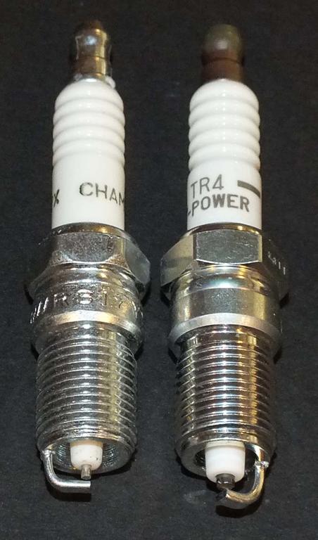

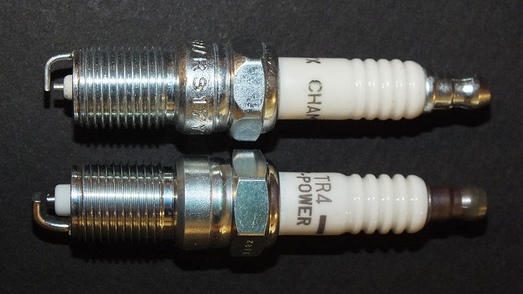

onanparts.com 185 #9 Posted April 19, 2020 16 minutes ago, cleat said: I just checked the last pack I bought of Champion plugs not too long ago at Canadian Tire and they are made in USA and look to be good quality. I will avoid any made in Mexico ones. Thanks for the heads up. Must be some really old stock! It was many years ago I started to see the made in Mexico plugs. I have a stash from at least 10 years ago that are made in USA. This pic is of one of those and a newer one. For the record, out of thousands of the Mexico plugs, not a single complaint ever received. The NGK plugs have a very good track record and the build quality is better all around so we are sticking with them. Share this post Link to post Share on other sites
