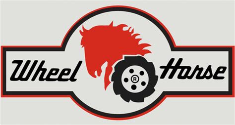

bc.gold 3,399 #1 Posted April 18, 2020 You can purchase ferric chloride or do as I'm doing, make your own. I gathered up some iron scraps then torched them to remove any grease or oil, then added the bits into a liter of hydrochloric acid aka muriatic available at most paint, hardware stores and lumber yards. Rusty iron is OK to use as the ferric solution gets filtered through a coffee filter before its used the first time. Nurd Rage has a good video showing how to make ferric chloride. I have a few small sheets of brass, my first project will be the logo shown below, after the brass has been through the first etch the part will be removed then thoroughly rinsed off. Then I'll apply mask to the exposed parts, then reintroduce the brass back into the ferric, what I'm hoping to do is remove all the outside metal from the outside outline - leaving me with just the logo. Once the etching is completed the mask is removed from all areas then paint is applied. I'll be using gimp for the artwork and the laser printer to create the mask, an old clothing iron to transfer the mask onto the brass. Ferric chloride works on copper, brass, steel and stainless steel. Share this post Link to post Share on other sites
