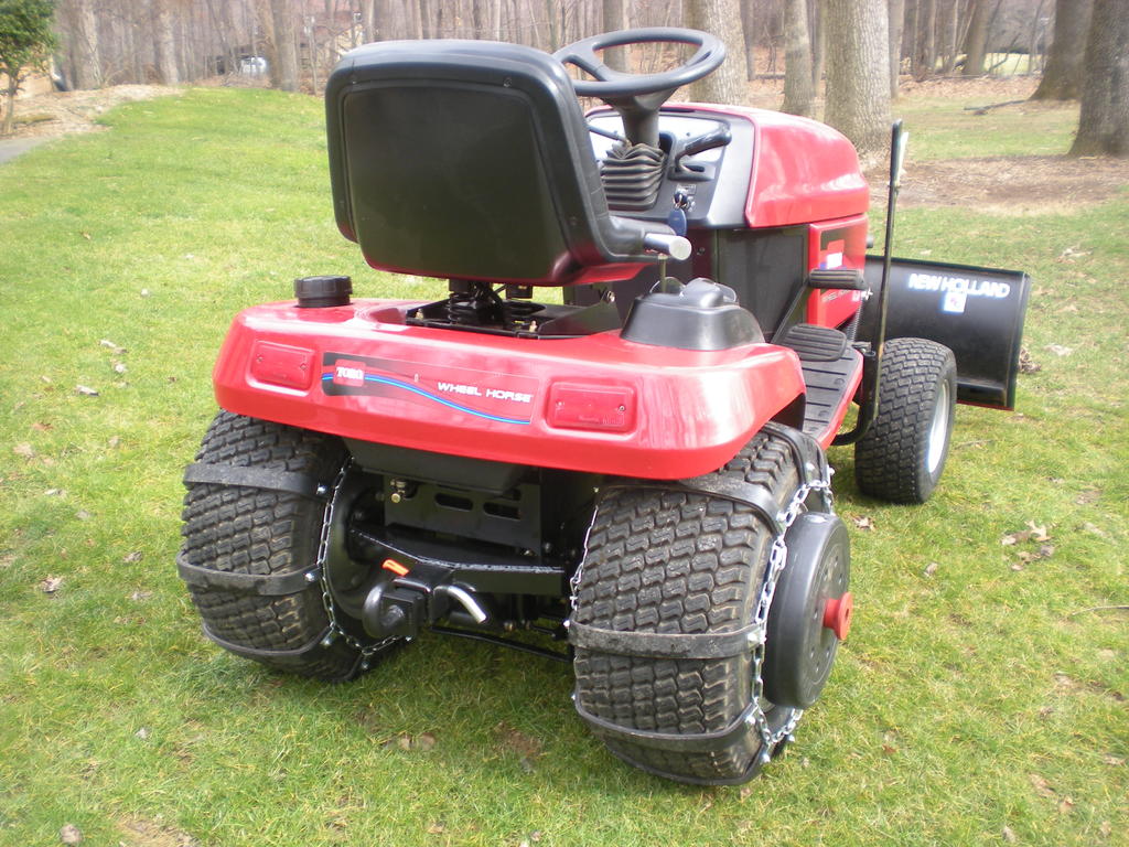

shallowwatersailor 3,222 #11 Posted April 24, 2020 (edited) On 4/22/2020 at 12:06 PM, TractorJunkie said: Hey Sailor, only xi regret.....not buying one of yours! Those were nice machines! They were very nice! Way overkill for the house that I have now. Here is my first, the 518xi, at the old house. Edited April 24, 2020 by shallowwatersailor 2 1 Share this post Link to post Share on other sites
