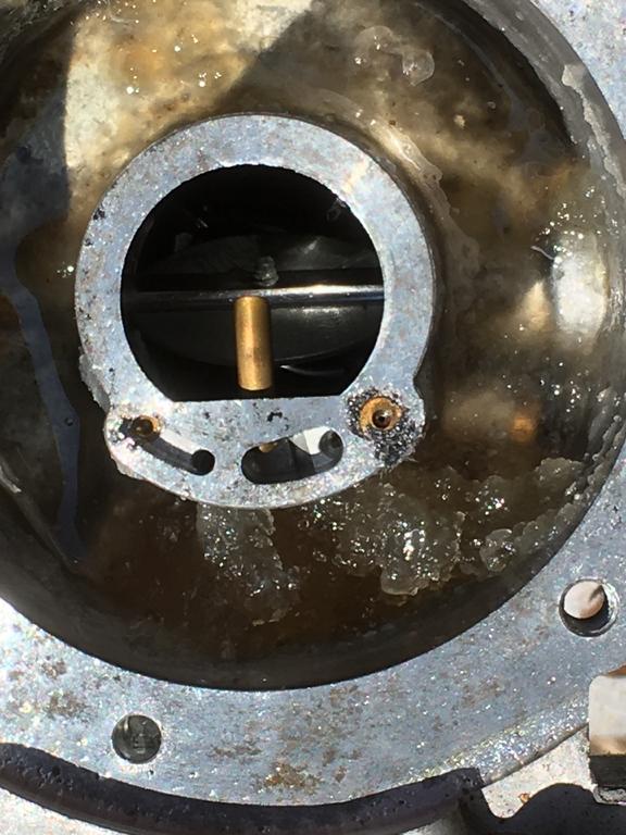

O2B__ 7 #1 Posted April 17, 2020 I was trying to get going a tractor that had been sitting for two or three years. When I determined that gas was getting to the carb, but the engine only ran on starting fluid, I pulled the top from the carb and found what looks like jelly covering the bottom of the float bowl. Anyone know the cause? 1 3 Share this post Link to post Share on other sites
The Tuul Crib 7,354 #2 Posted April 17, 2020 Ethanol pearls. Time for a thorough cleaning and non ethanol fuel. Gas line fuel filter rebuild a carb and flush out the tank. 9 Share this post Link to post Share on other sites
stevebo-(Moderator) 8,609 #3 Posted April 17, 2020 What he said!! Ethanol fuel is terrible 5 Share this post Link to post Share on other sites
oliver2-44 11,391 #4 Posted April 17, 2020 Yep, thats a classic Ethanol picture! 4 Share this post Link to post Share on other sites

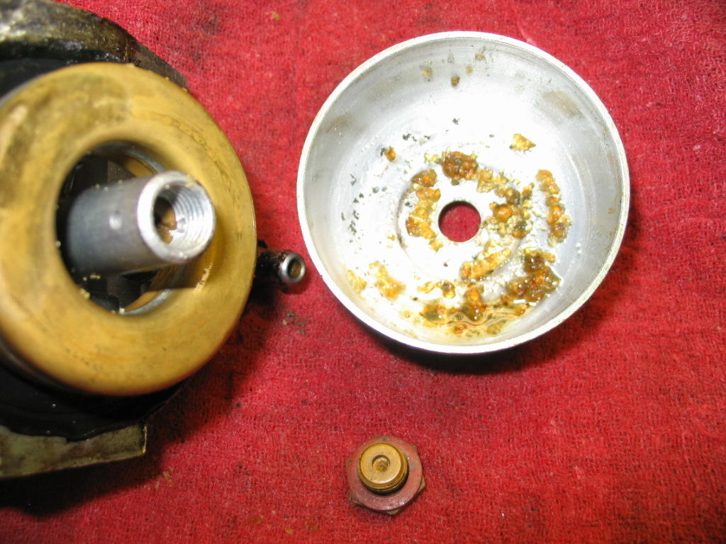

daveoman1966 3,882 #5 Posted April 17, 2020 For a few years, I used gas additive...Stabil... and this is what I got in the carb. Now I use ONLY ethanol free... 5 Share this post Link to post Share on other sites
953 nut 65,215 #6 Posted April 17, 2020 Once you have cleaned the fuel tank, replaced all fuel lines and filter, soaked the carburetor in a good carb-cleaner and rebuilt it you can find non-ethanol gas with this web-site, https://www.pure-gas.org/. 3 Share this post Link to post Share on other sites
