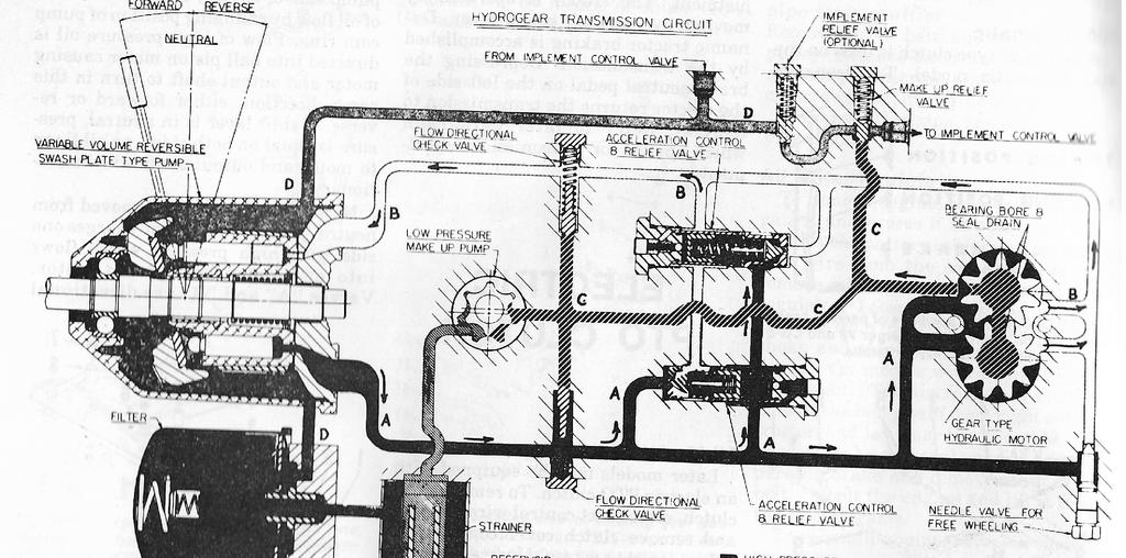

953 nut 65,344 #10 Posted April 18, 2020 I copied this from an old manual in my shop, hope it helps. Looks like a larger volume pump that is valved to be variable and reversible could be adapted to two hydrogear drives if you had a couple of machined adapter plates and some hoses. Share this post Link to post Share on other sites
Pat mcgrew 23 #11 Posted April 18, 2020 Thanks, that’s what I was thinking as well. Just got the second set of hubs for the new front end. Pictures to come soon. Share this post Link to post Share on other sites
