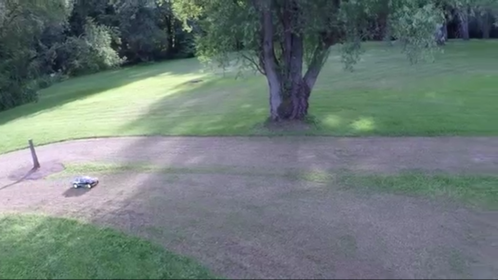

tom2p 2,394 #28 Posted May 9, 2020 (edited) When I have a deck off to perform cleaning or maintenance which is not as often as it should be - I flip the deck on its side and use a dremel on the blades ... just a few minutes on each blade cant recall the last time I removed the blades and used a bench grinder - the blades usually look fairly good ... have a small aluminum blade balancer - can't recall the last time I used it maybe because Wheel Horse blades are tough - and I typically keep the deck height high *** *** with the exception of when I cut the kid's RC track extremely low (pictured below) ( I only use 42 RD to do this - and then sharpen blades after ) Edited May 9, 2020 by tom2p 2 Share this post Link to post Share on other sites
