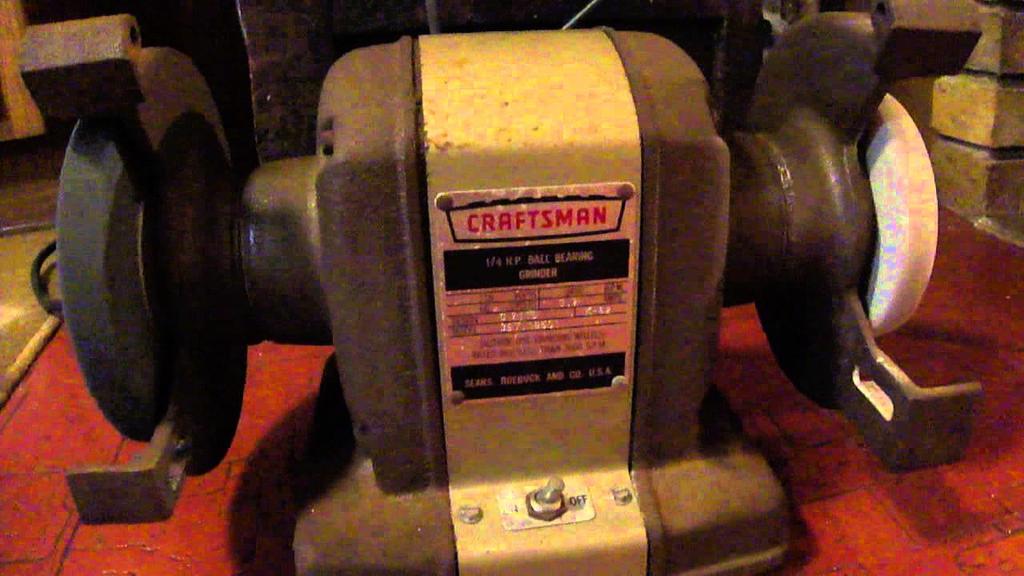

bottjernat1 2,197 #25 Posted April 15, 2020 I sharpen my own blades. I have my trusty old craftsman bench grinder! it may not be the right way but it works. Mine looks just like this one 1 Share this post Link to post Share on other sites
