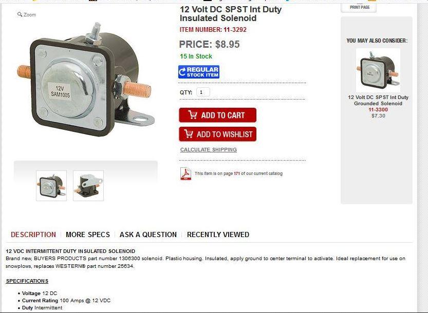

pfrederi 20,535 #29 Posted April 29, 2020 Or for 9 bucks by the original type.. either way could work... 1 Share this post Link to post Share on other sites

WHX?? 56,595 #34 Posted April 29, 2020 2 hours ago, Lane Ranger said: Or do like Paul indicated and buy a new snowplow type solenoid which duplicated the basic function of the original 701. 550 and 551 solenoid used in those wiring systems. The stay original guys in MN would prefer that! Mike's got a good point about keeping the juice at the solenoid. Share this post Link to post Share on other sites

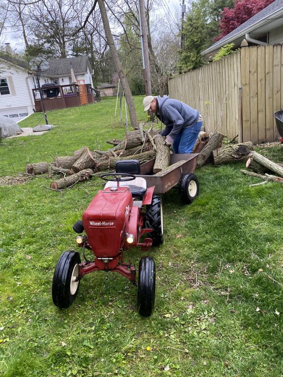

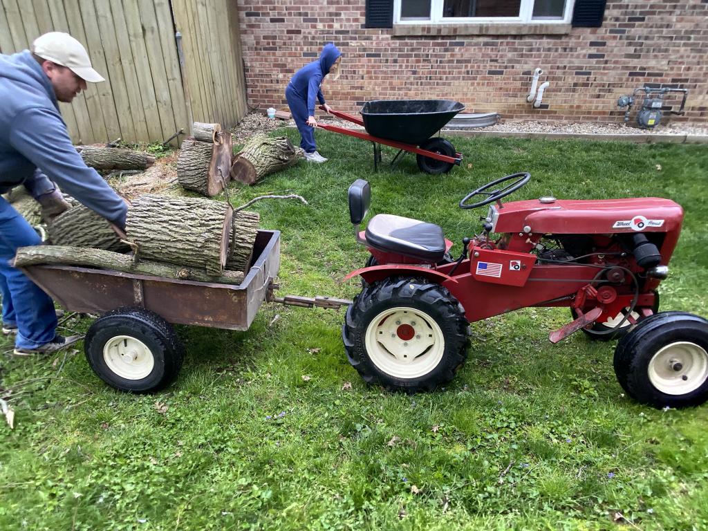

Lane Ranger 11,962 #35 Posted April 30, 2020 The 701 was back at it today! Finally, running with vigor again! Carrying a cut up walnut tree to my neighbor for winter 🔥 wood! 2 Share this post Link to post Share on other sites
