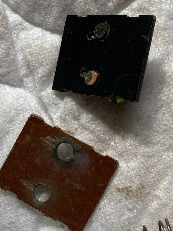

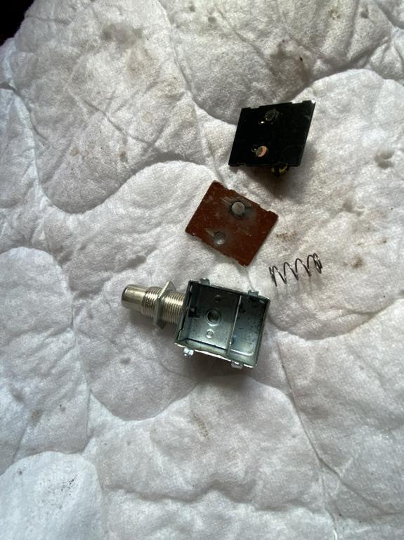

Lane Ranger 11,883 #1 Posted April 14, 2020 I tried starting my 1961 Wheel Horse 701 today and no go! Put battery charger on for a while but then remembered I had a newer battery. Got the test light out and looked at all my wire connections . All good. So I started checking closer the regulator and my push button starter switch. Regulator was ok but a loose bolt on the generator. Tried everything again still no go - no power to generator when using push button switch with key switch turned on. Key switch checked and all good. so I took out the push button switch after checking that one side had no power to my test light when pushed. So I removed the push button switch and decided to take it apart to look inside. Never looked at one before inside and wondered what it might look like. Here are the pictures. So looks like something burned inside the push button switch! I ordered a new Cole Hersee switch to replace my cheap one. 1 3 Share this post Link to post Share on other sites

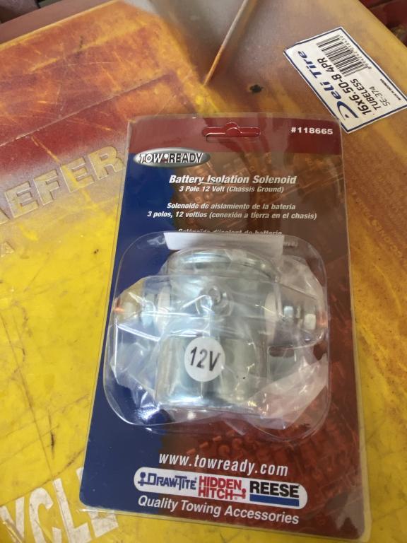

gwest_ca-(File Mod) 12,071 #2 Posted April 14, 2020 You realize the switch just provides a ground for the solenoid? Have never seen a replacement 3-terminal solenoid with the shunt for the coil. A 4-terminal solenoid with + and - terminals for the coil will work. Garry 3 Share this post Link to post Share on other sites
bc.gold 3,406 #3 Posted April 14, 2020 How many amps is your push button switch rated for, to extend the life use a horn relay good for 30 amps wired into the circuit. 1 Share this post Link to post Share on other sites
953 nut 64,664 #4 Posted April 14, 2020 8 hours ago, Lane Ranger said: So looks like something burned inside the push button switch! Ya, I don't work as well as I once did either, Push my buttons and I may or may not start! Guess one of my connections is burnt up inside 1 5 Share this post Link to post Share on other sites

rmaynard 16,992 #6 Posted April 14, 2020 (edited) Have you tried going directly to the solenoid, and jumper to ground eliminating the switch? As Garry said, the push button switch only completes the path to ground for the starter solenoid. Extremely rare that it should fail. Edited April 14, 2020 by rmaynard Share this post Link to post Share on other sites

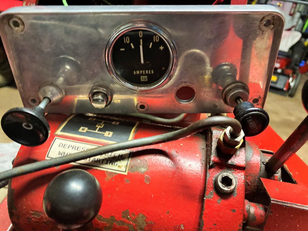

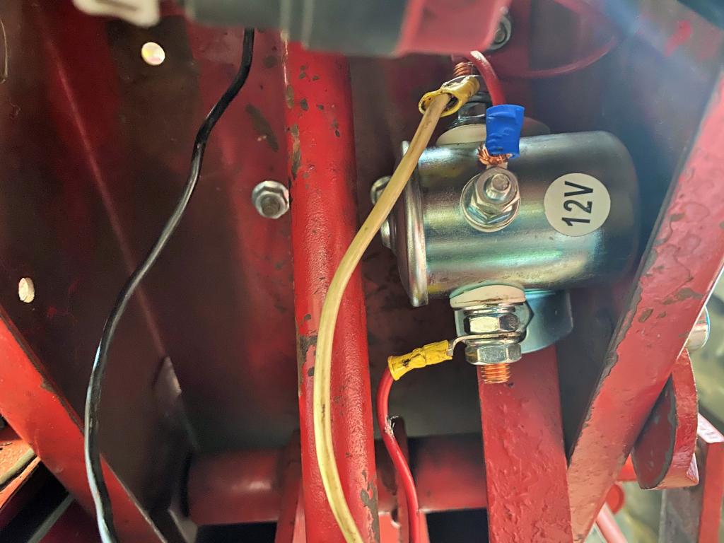

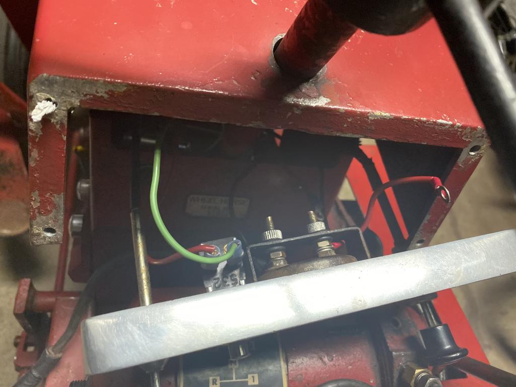

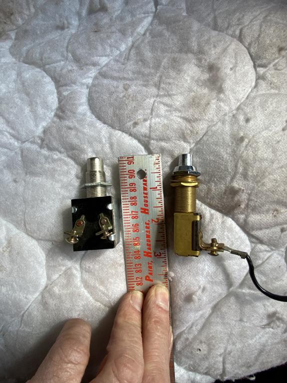

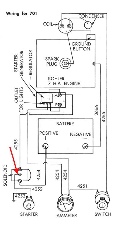

Lane Ranger 11,883 #8 Posted April 28, 2020 Ok guys thanks for all the suggestions and information on the 701 wiring. I finally got back to this project yesterday and today. I have a new Cole Hersee push button switch and a new solenoid. Due to my steel/chrome plated dash I can not use a two prong switch (at least I have not found one that has about 5/8 inches of threads to go thru the dash plate thickness. So the switch which has been in mine is a four prong switch. Been in there for ten or more years and three different owners. Photo of the key switch is attached. I hook up BAT prong on the key switch to the ammeter with a short wire like in the 701 diagram. I hook up the Positive Coil wire to the IGN on the four prong switch. When testing to test light with key switched to IGN I have power to POS Coil side. Positive on Both Sides on Ammeter. Light Switch Works -hooked to Regulator ACC Post. Test light also shows POS on Solenoid Top Post. However, when I push the Push Button Switch to turn the starter No Go. I tested continuity with Neg Side of Battery and ground wire on Push Button and I have continuity. I checked negative site of battery to center post on solenoid and I have continuity. I ran wire from positive side on battery to center post on solenoid and the solenoid clicks in place. However, I have no grounding occurring when I push the Push Button Switch. So I think the solenoid may not be correct. It is already grounded and that means the push button switch does not engage ground. What is a correct solenoid to use on the 701 that is ungrounded until engaged with the push button switch. Share this post Link to post Share on other sites

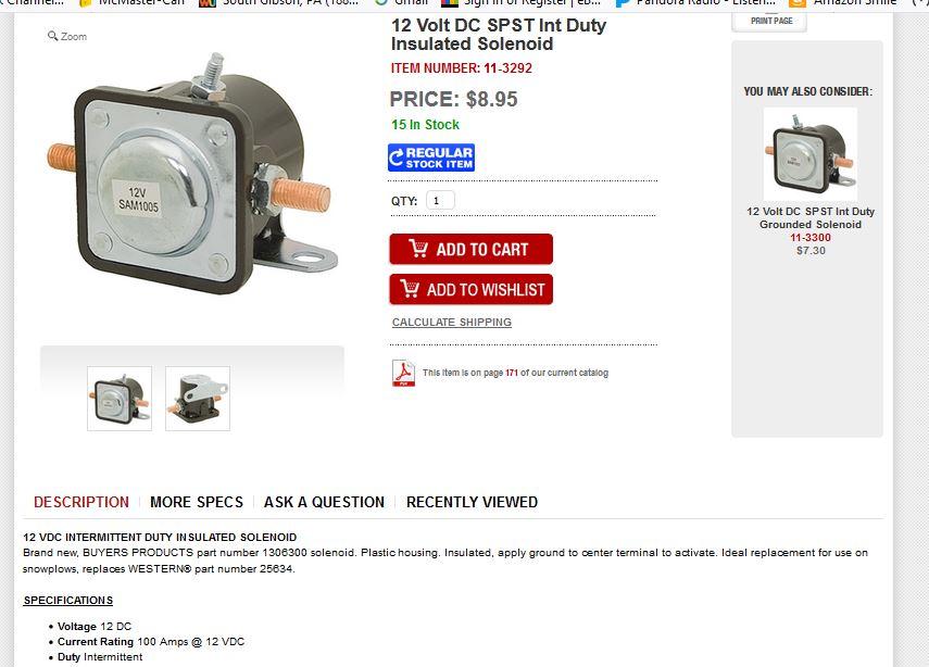

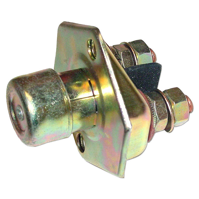

pfrederi 20,062 #9 Posted April 28, 2020 Guess it is this type used on snowplows Western 25634 1 1 Share this post Link to post Share on other sites

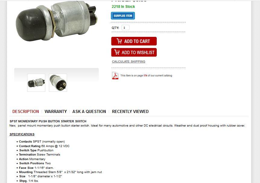

pfrederi 20,062 #10 Posted April 28, 2020 Foe push button one of these??? Share this post Link to post Share on other sites
WHX?? 55,725 #11 Posted April 28, 2020 Or a four post solenoid and jumper the batt post to one of the small posts and the other small post to switch ground? Which must be like an original except the sol. coil is internally connected to B+ . The one Paul showed would work for certain ...note the apply ground to center terminal to activate. Or I just come get the whole shebang! 1 1 Share this post Link to post Share on other sites
pfrederi 20,062 #12 Posted April 28, 2020 Most 4 terminal solenoids have an I terminal that is used to bypass ballast resisters while starting. Do not think they will work here. 1 Share this post Link to post Share on other sites

953 nut 64,664 #15 Posted April 28, 2020 Lane, I'm going to take guess here, At some point in the past six decades someone rewired it and didn't use the original style solenoid because they were no longer available. If you jump from big post to big post on the solenoid does the starter turn over? From what I am able to glean from your trouble shooting procedure I am inclined to think you have a bad battery cable, passes enough current to show voltage on a meter but not enough to actuate the starter. 3 Share this post Link to post Share on other sites
pfrederi 20,062 #16 Posted April 28, 2020 (edited) Read back through this Why did you replace the solenoid you talked about switches but I didn't see solenoid. Do you have the old one? Test it?? Richard may be on to something. Edited April 28, 2020 by pfrederi 2 Share this post Link to post Share on other sites
Achto 31,318 #17 Posted April 29, 2020 @Lane Ranger Looking at the wire diagram I think that it is wrong, or at least it won't work with the solenoid that you have. I have never seen a solenoid wired the way it is on the diagram. Here is the fix - Run a hot "+" wire to one side of the start button, run a wire from the other side of the start button to the small post on the solenoid. The body of the solenoid will serve as your ground for the coil in the solenoid. Connect a large "10ga at least" wire from the battery to one of the large terminals on the solenoid. Connect a large wire from the other large term on the solenoid to the starter gen "+" terminal. Your start system should work with the above set up. 2 Share this post Link to post Share on other sites

953 nut 64,664 #24 Posted April 29, 2020 11 hours ago, Achto said: Looking at the wire diagram I think that it is wrong, or at least it won't work with the solenoid that you have. I have never seen a solenoid wired the way it is on the diagram. That was the way the wiring was done on the 550, 551 and 701. Not a great idea but that was what they did. 1 1 Share this post Link to post Share on other sites
Achto 31,318 #25 Posted April 29, 2020 12 minutes ago, 953 nut said: That was the way the wiring was done on the 550, 551 and 701 This must have involved a special solenoid. I'm not familiar with any newer solenoid coil functioning that way. 1 Share this post Link to post Share on other sites
