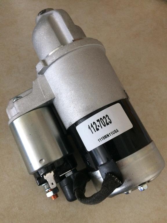

Redintheshed 5 #11 Posted April 16, 2020 The new starter arrived. Not a Mitsubishi. The label has a USA mark, but no brand name. It's the new substitute part for the original. Picture below. Installation may not happen until tomorrow. The part is slightly different than the original, but he mounting bracket and location of the solenoid are the same. The starter housing is slightly smaller. Wiring is different, but the contact points are the same layout. Quote 1 1 Share this post Link to post Share on other sites

lynnmor 9,042 #13 Posted April 17, 2020 Is the starter hitting the engine in a way that prevents the holes from lining up? Did you move the engine tin out of the way? Maybe you could stick some long pins in the holes to guide the starter in. Try sticking the old starter in to see if it still goes in easily. I have heard horror stories about these after-market starters. What you have is a $65 starter that Toro sold you with an extreme markup. Share this post Link to post Share on other sites
Redintheshed 5 #14 Posted April 17, 2020 (edited) Got it in by removing the hood and loosening the front section of the blower cover for better access. Still didn't start. By-passed the seat safety connection and it started. I suspected the seat safety all along, but previous attempt at cleaning the connection didn't resolve the connection problem. And the starter test (jumping with cables connected to the battery) didn't start it. So, now I have a new starter, the original in reserve, and I'm cutting grass again. Ha ha. Thanks for listening. Edited April 17, 2020 by Redintheshed 1 Share this post Link to post Share on other sites
