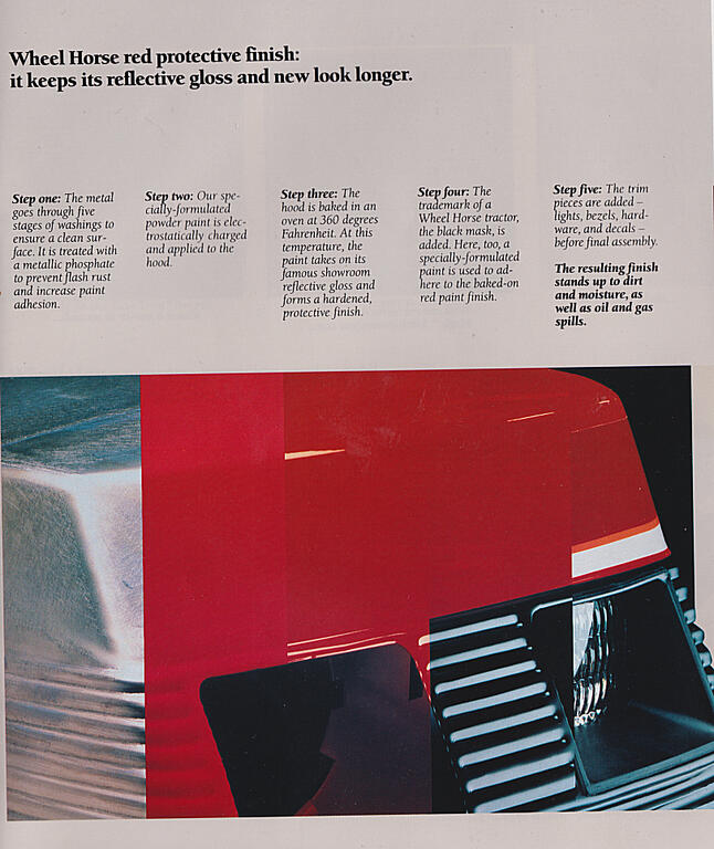

Anthony Wendover 124 #29 Posted May 14, 2020 A small update to this one guys.. Just picked up some books off of ebay and flipping through a book i found this page! It outlines the 5 step process.. However it states its for the hood not sure on the rest. 4 2 Share this post Link to post Share on other sites
pfrederi 21,274 #30 Posted May 14, 2020 9 hours ago, Anthony Wendover said: A small update to this one guys.. Just picked up some books off of ebay and flipping through a book i found this page! It outlines the 5 step process.. However it states its for the hood not sure on the rest. Is there a date on this info sheet?? Share this post Link to post Share on other sites
Anthony Wendover 124 #31 Posted May 14, 2020 1 hour ago, pfrederi said: Is there a date on this info sheet?? 1988 is the copyright in the book. Share this post Link to post Share on other sites
tom2p 2,396 #32 Posted May 14, 2020 12 hours ago, Anthony Wendover said: A small update to this one guys.. Just picked up some books off of ebay and flipping through a book i found this page! It outlines the 5 step process.. However it states its for the hood not sure on the rest. good find ! Share this post Link to post Share on other sites

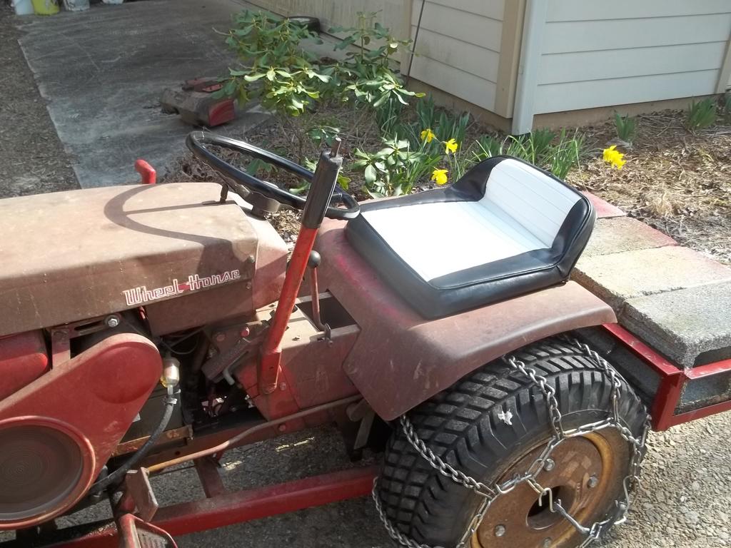

"D"- Man 827 #33 Posted May 14, 2020 On 4/16/2020 at 8:04 AM, 953 nut said: If you look at any unmolested, well patinaed older Wheel horse you will see that Kohler did a much better job of painting the engine tins than did of painting the tractor. They were the same color, but the engine paint is always brighter. Case in point, my 1055 engine tins are red, the rest of the tractor, not so much I would assume that engine tins had to be painted with a high heat paint that may have been better than the tractor paint. Share this post Link to post Share on other sites
ebinmaine 81,048 #34 Posted May 14, 2020 1 hour ago, "D"- Man said: I would assume that engine tins had to be painted with a high heat paint that may have been better than the tractor paint. on a good running engine that isn't too hot the only place you ever see an issue with non high heat paint on an engine is within an inch or so of the exhaust port 1 Share this post Link to post Share on other sites
