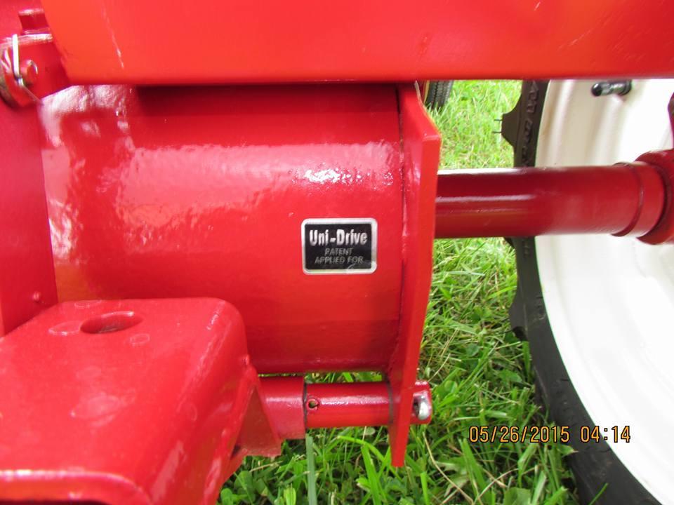

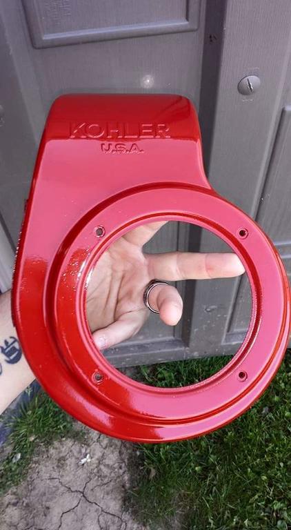

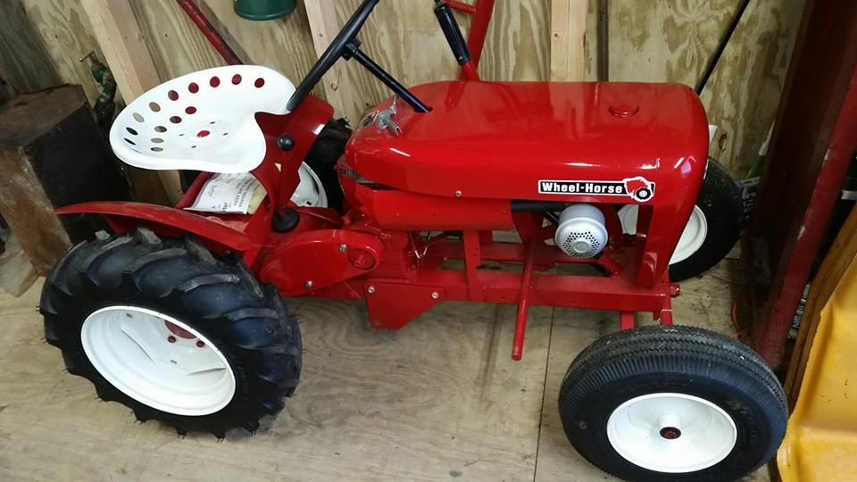

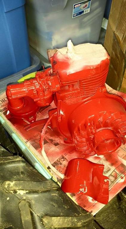

bottjernat1 2,197 #20 Posted April 14, 2020 (edited) Here is what i did for my rj58 most of it was done by a body shop but i did the transmission and motor. i sand blasted what i could then used oven cleaner and a wire brush. Don't use oven cleaner on aluminum it will eat it. But cast and sheet metal you will be good. Then wash if you used oven cleaner. Use a clean rag wipe down i used a coat of rustoleum grey primer 2 or 3 coats of rustoleum international red and 2 or 3 coats of clear coat. Edited April 14, 2020 by bottjernat1 6 1 Share this post Link to post Share on other sites
