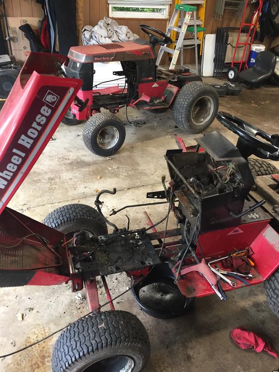

wh5208speed 672 #1 Posted April 12, 2020 So a few years back (Summer of 2015), I stumbled onto a pair of old 520H at an auction. They were used to push snow at a local bank. I am assuming the bank transition to paying to have someone else push snow because these Wheel Horses had been sitting in storage for a very long time. One had about 94 hours and the other had about 115 hours, both had snow blades and no mowers. I got the 94 hour wheel horse cleaned up and running and ended up selling it to cover the cost of what both tractors cost me. I finally got 115 hour 520H running and it sounded great. About 15 minutes into running it developed a knock, which sounded to me like a rod. I shut it down. So the tractor has been sitting for the past 5 years waiting for me to decide what to do with it. If it was a higher hour machine I would have sold it a long time ago, I just hate parting with something that is in such great shape otherwise. I have been considering a couple of options: 1. Find a Onan mechanic that knows what they are doing and fix it right 2. Buy a new 23hp Vanguard and keep the tractor 3. Keep an eye out for a donor 520H with Low hours (not many of these around anymore) 4. Sell the tractor as is and let someone else have the project I really prefer option 1...but I know these Onan's can be money pits. Anyone know of a good Onan mechanic in the Ohio area? Thanks! Thad Share this post Link to post Share on other sites
Sparky-(Admin) 24,998 #2 Posted April 12, 2020 If indeed the engine is shot I would go with a Vanguard or a Honda conversion. 1 Share this post Link to post Share on other sites
WVHillbilly520H 10,378 #3 Posted April 13, 2020 115 hours , I highly doubt anything major is wrong with it... But anything is possible... Could be something as simple as dislodged carbon , valve tappet clearance to big , low oil pressure (did you change oil and filter before start up?) To more involved like a loose valve seat or rod bearing... IMHO the Onan gets a bad rap they are hard to beat when running right a little finicky yes but opposed twins have more torque than the Vs and nothing sounds quite like an Onan up on the governor singing its song. 4 2 Share this post Link to post Share on other sites

lynnmor 8,741 #5 Posted April 13, 2020 Have someone open it up and investigate, until you you know the damage there is no way to choose the best course of action. Nothing special about an Onan, it's just another small engine and there are manuals right here to guide you or a mechanic. 1 Share this post Link to post Share on other sites
bc.gold 3,406 #6 Posted April 13, 2020 Before using the laid up tractor did you check to see if the mice had built nests under the tin shrouds. Share this post Link to post Share on other sites
Pullstart 69,643 #7 Posted April 13, 2020 Would you feel comfortable changing the oil again and adding some sea foam and running it a bit then draining again? There should be metal flake in the oil if it’s internal damage. If it is damaged, what’s done is done... 1 Share this post Link to post Share on other sites
peter lena 9,849 #8 Posted April 13, 2020 agree with pullstart on the possible oil issue, if it were me i would have slowly heated up the engine with heat lamps to get the oil moving. rislone oil treatments do a terrific job of cleaning and restoring ring gap crud and would help in its basic run in . with the low hours , i would think the engine was ok , mabey a fuel issue or other problem caused its lack of use. somewhere in time, motorcycle shop , regularly recovers and starts 100 year old cycle engines , using the slow heat up way of starting . hope you manage to save that engine , pete 1 Share this post Link to post Share on other sites

Andy N. 2,672 #10 Posted April 13, 2020 Option 3 worked for me last fall and I couldn't be happier. I swapped an Onan from a '90 520H into my '89. Not a big deal at all. Kept the original harness and intake manifold/carb. Donor tractors with good engines are out there. I swapped over the forward swept front axle as well so I could use the 60" deck that came with the donor. 2 2 Share this post Link to post Share on other sites
WildmanC120 613 #11 Posted April 13, 2020 Boat anchor that Onan and throw a Honda or vanguard in it and be done! 1 Share this post Link to post Share on other sites
WVHillbilly520H 10,378 #12 Posted April 13, 2020 55 minutes ago, WildmanC120 said: Boat anchor that Onan and throw a Honda or vanguard in it and be done! I would agree with you if it had 2115 or more hours but just at 115 it's worth the effort to see if it's just something simple vs a rebuild/replacement. 2 Share this post Link to post Share on other sites
Greentored 3,220 #13 Posted April 13, 2020 Go with option 2 or 3 and let me take that 'junk' 115 hour Onan off your hands and dispose of it properly. ...right into my 1300 hour 520 after a freshen up 2 2 1 Share this post Link to post Share on other sites

bellevillerod 835 #18 Posted April 14, 2020 I'm running 4 onan engines over here. That one you have is brand new in comparison to mine. 3 of mine are from the mid 70's. I'd check to see if you have a stuck valve. They do collect a bit of stuff when running but yours are snow machines not cutting grass. Like someone else said check for mice nests. Pop the covers off check valve clearances an run some fresh oil with some k1 an mineral sprites in it. Run an hour and change oil. Love to hear an Onan sing. 4 Share this post Link to post Share on other sites
