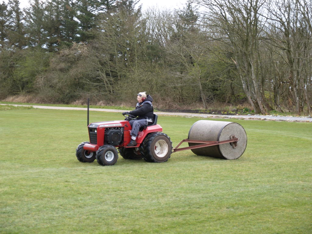

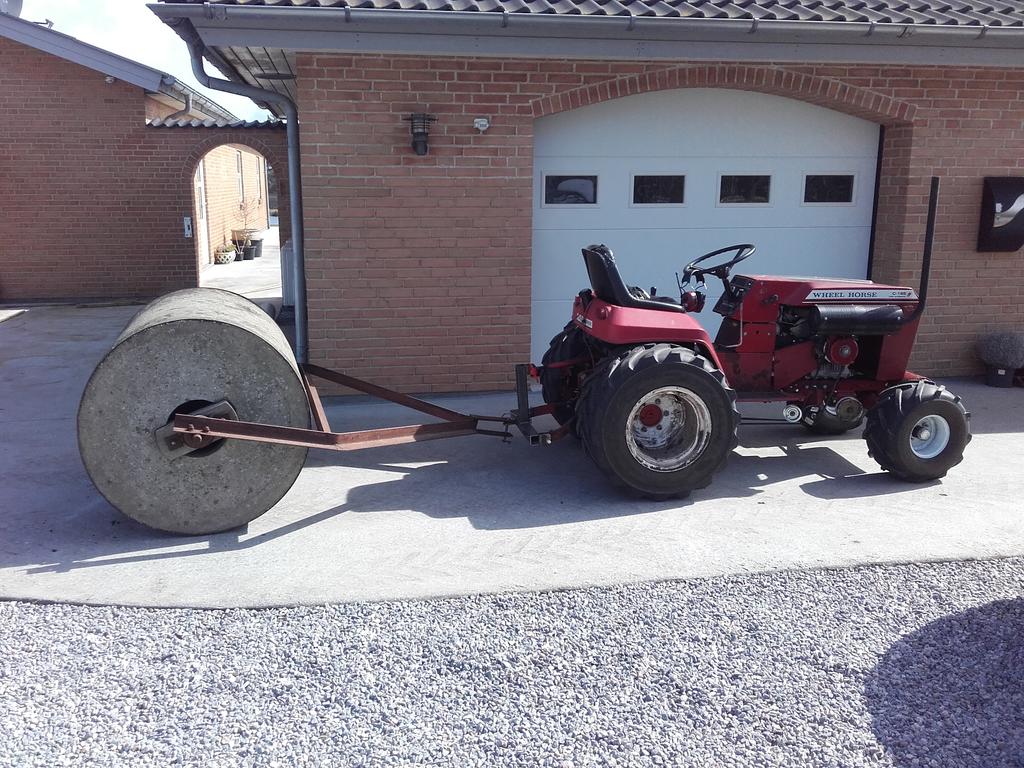

Skipper 1,792 #1 Posted April 12, 2020 (edited) So, my good friend and neighbour is a big farmer. He has a bunch of cows grazing on our fields around the house, and then one day cow poo happened. They got out, and wandered into the garden. Moist soil, so giant fat bambi footprints all over. My friend immediately offered to pay for a redo of the lawn, but hey, why be an ass and say yes, when we can fix it without. I knew he had a big old roller sitting around. several actually, but one was more than enough for my plans. This roller weighs in at 2 ton or 4410 lbs to be exact. Or about 10-15 standard garden size rollers. That will put a squeeze on, and with a few passes it will smoothen things out to a pancake. it's about 40" diameter, and about 50" wide. Solid concrete with some steel in it. He then immediately offered me to borrow his smallest tractor to pull it around, but I figured I would let Baby have a go at it. I once tried that roller on a c120 in the past. that was not a success. It could barely move it, and had no control over it at all. The c120 did not have the weight nor the grip to do anything serious about it, but my good was I surprised by my custom C195. Baby did not just move it, it actually ran fine with it. It could steer, it could pull it up hill. Heck, it could even start it up hill on wet soil. towed it fine on loose granite chips too. I am so impressed by my little franken horse. It pulled this thing around the lawn for 7 full hours with not one single issue. It is scary good! I'm in love!! I am tempted to say that it tows almost as good as a sub compact. One problem with this setup is though, that it makes the one eyed franken horse look small---ish Yes, this is missus nut job having a bit of fun seat time too. Edited April 12, 2020 by Skipper 7 11 3 2 Share this post Link to post Share on other sites

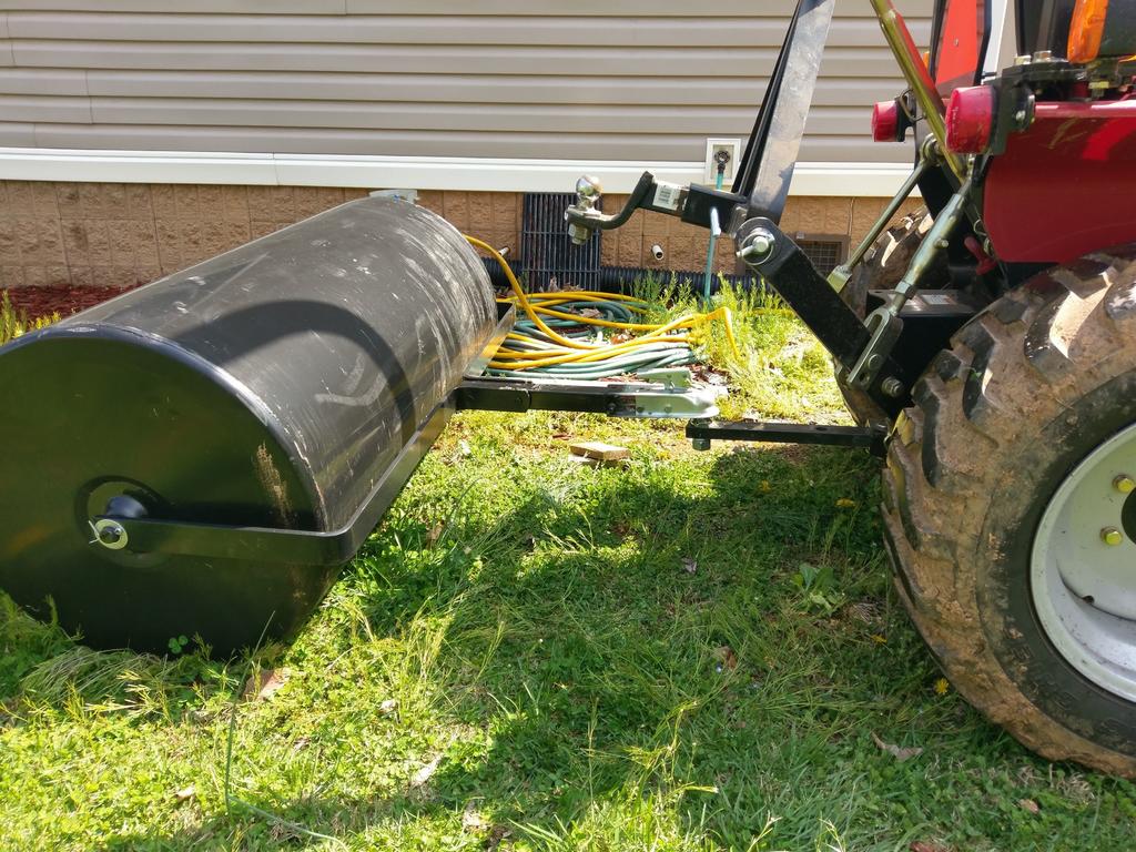

lynnmor 9,073 #2 Posted April 12, 2020 Just think, the owners manual for my 520H says the limit for towing is 275lbs. Yes, I have towed a bit more, like a 5-1/2' x 10' trailer piled high with damp mulch. 2 Share this post Link to post Share on other sites

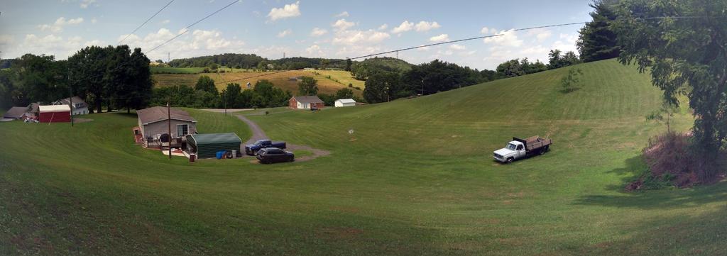

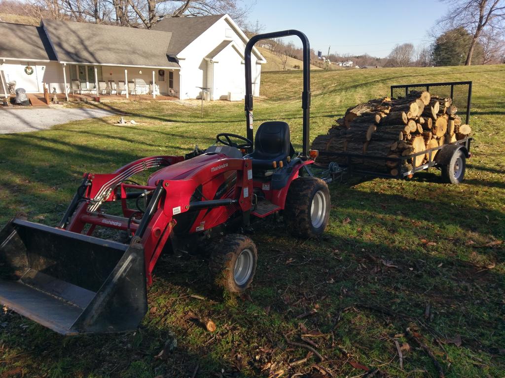

WVHillbilly520H 10,379 #9 Posted April 13, 2020 Just to think my (24"x52") 1/2 ton water filled roller pushes my Mahindra eMax (gear) compact around on our hilly property and it has "good" brakes. 3 Share this post Link to post Share on other sites
Skipper 1,792 #10 Posted April 13, 2020 Yeah, I would definitely not try this setup at your place. Way to dangerous It would take a real tractor to handle a 2 ton roller in a place like that. 1 2 Share this post Link to post Share on other sites

Skipper 1,792 #12 Posted April 13, 2020 1 hour ago, pullstart said: Amazing Skipper! I am assuming this is a fresh Eaton? Didn’t you recently fry one in the last escapade, or just stall it out? Hi and thanks. Amazing can be substituted with insane at any point No I didn't fry it. It just stalled the engine several times. This is the factory unit from 84, with at least 1200 hours on it. Fun thing how well it can transfer HP kind of in a fixed ratio as a gear drive. Push the hydro to full in low rpms, and then give it full throttle with that roller. It simply just accelerates equal to RPM. Or in other words, the speed is locked to engine rpm. Fun little side story. I used the GPS to see how fast it could go, flat out on tarmack with that roller in tow, and it did 9.5 mph. exactly the same as without the roller. Not something I can recommend though, as speed certainly didn't make the setup more stable. At full speed it was clear that the roller was still way heavier than the tractor, and I eased off gently with a sweaty hand. That was enough of a near pancake situation for me. 1 2 Share this post Link to post Share on other sites
