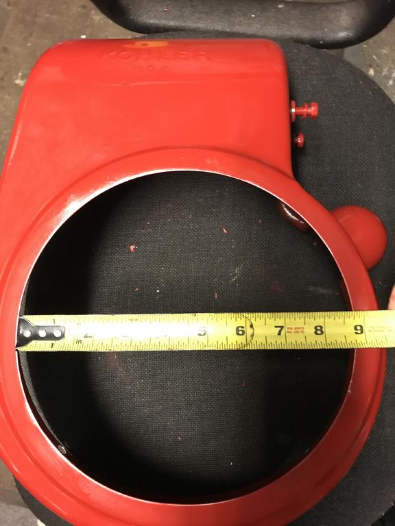

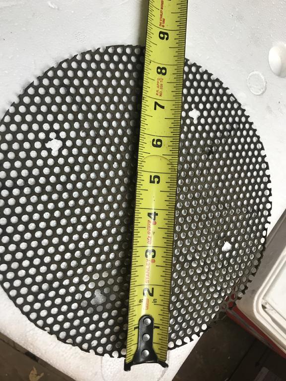

Larry P. 45 #1 Posted April 12, 2020 (edited) Happy Easter All, Before I go eat my Easter Ham I was trying to install my K341 Engine shroud over the flywheel on my wheelhorse C160. The problem is the shroud jams against the grass screen. I don't know where these parts came from so I don't know if they are correct to this engine. It seems that the diameter of the grass screen is too much. The diameter of the grass screen is 9.75" and the opening on the shroud is about 8.5". Is this the wrong grass screen? Also should the grass screen have the hole in the middle or be a full screen without the hole. Thanks for your help, Larry Edited April 12, 2020 by Larry P. added photos Share this post Link to post Share on other sites

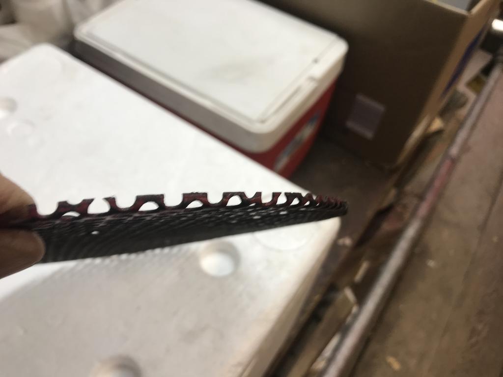

oliver2-44 11,632 #3 Posted April 12, 2020 Post some pictures to help us see what you have. Does your screen have a bent lip of the preforated metal on it, or does it have a flat metal band crinped around the outside? Share this post Link to post Share on other sites
pfrederi 20,892 #4 Posted April 12, 2020 Hole in the center was for many engines ordered by other manufacturers who had output shafts on the flywheel but not for a WH. 1 Share this post Link to post Share on other sites

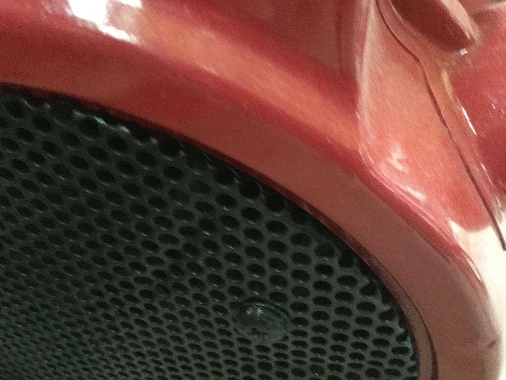

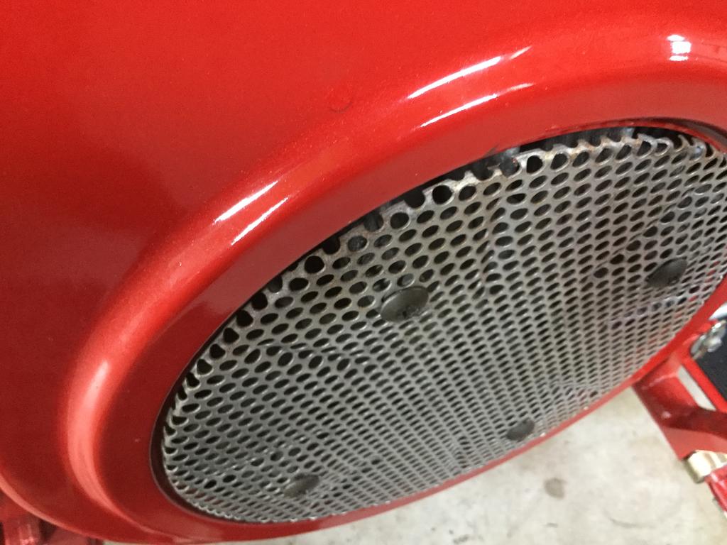

gwest_ca-(File Mod) 12,371 #5 Posted April 12, 2020 Have a K301 with that screen mounted on the outside. Garry Share this post Link to post Share on other sites
pfrederi 20,892 #6 Posted April 12, 2020 MY K341 with a bent edge screen runs inside. The solid ring edge like the picture runs outside the K321.... 2 Share this post Link to post Share on other sites
Larry P. 45 #7 Posted April 12, 2020 But I have the K341. what is the correct grass screen for the K341? bent edge or solid ring edge?? Share this post Link to post Share on other sites

squonk 47,423 #9 Posted April 12, 2020 8 1/2 " bent edge Share this post Link to post Share on other sites
richmondred01 2,383 #10 Posted April 12, 2020 8.5” bent edge Share this post Link to post Share on other sites

Larry P. 45 #12 Posted April 13, 2020 Awesome guys. that answers my question. I got the wrong flywheel screen for the K341. Does anyone know what Kohler motor my screen goes too ? Share this post Link to post Share on other sites
