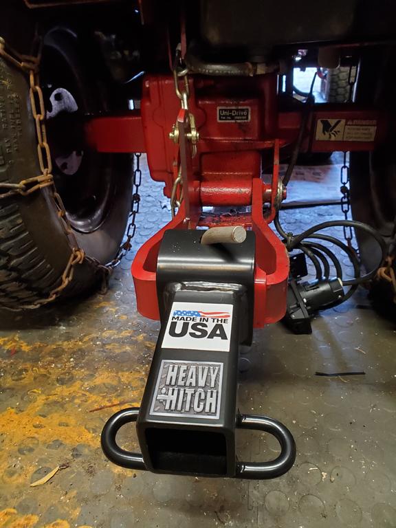

Racinbob 13,213 #4 Posted April 12, 2020 Here's one of their receivers. The best add on I've even done. 3 2 2 Share this post Link to post Share on other sites

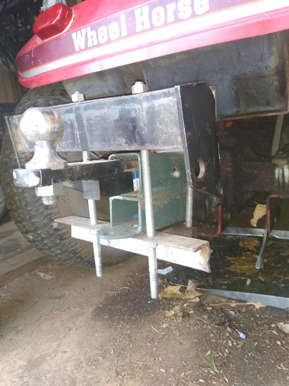

CCW 1,519 #8 Posted April 12, 2020 Ok, ok. Photos you get. A couple of pieces of square tubing to accept the draw bar. The upper one is so I could raise the trailer tongue to a better height. The lower one has the receiver hole for the original hitch connection. This was my first modification to the tractor and I bolted it directly to the original hitch bar. Discovered that the tongue weight was bending the hitch bar so I added a bracket to support the new hitch connect from the suitcase weight rack. Worked perfectly after that and the suitcase weights still fit should I ever need to use them. Oh yeah. Green paint was some I had and I was new to the WH world. 1 2 Share this post Link to post Share on other sites

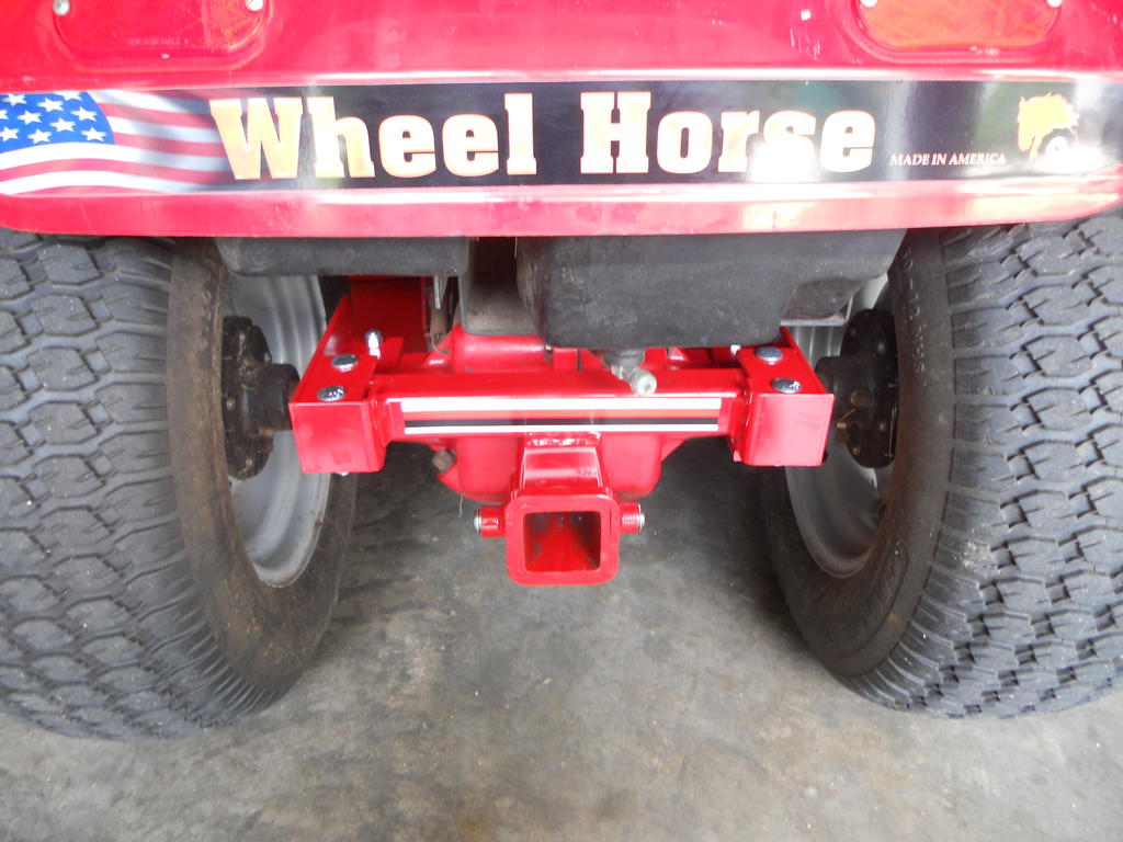

Bill D 3,173 #9 Posted April 15, 2020 I made my own. I had an old receiver hitch someone gave me. I cut it down and made this. Bill 2 1 Share this post Link to post Share on other sites

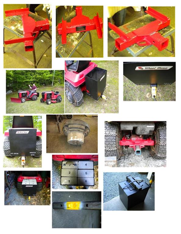

Lee1977 7,805 #10 Posted April 16, 2020 Here are some I built. 1 1 Share this post Link to post Share on other sites

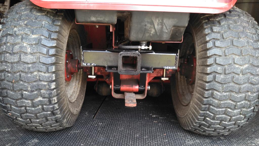

C-85 826 #11 Posted April 16, 2020 Here's how the mighty C-85 handled this! 1 1 Share this post Link to post Share on other sites
