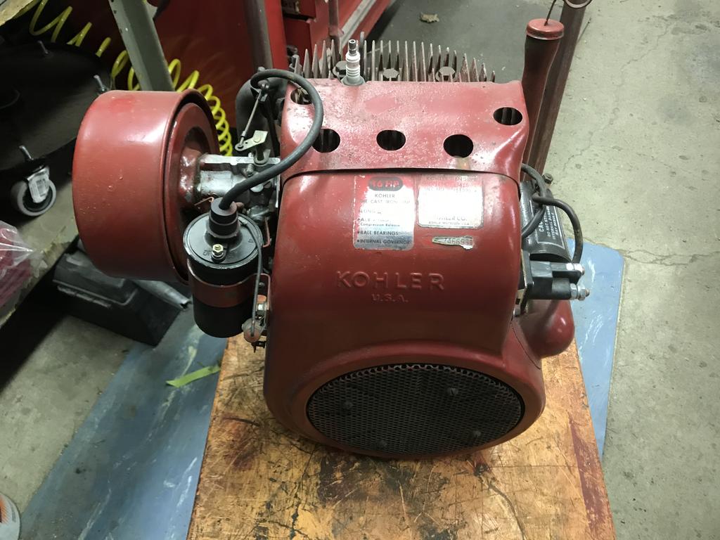

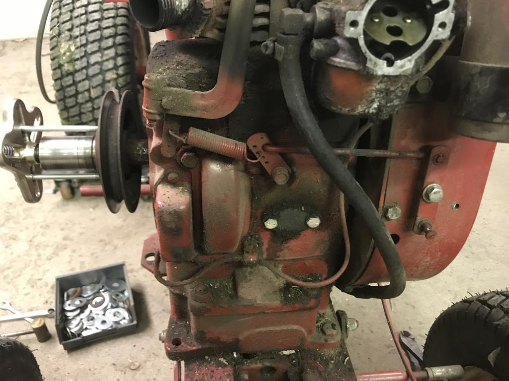

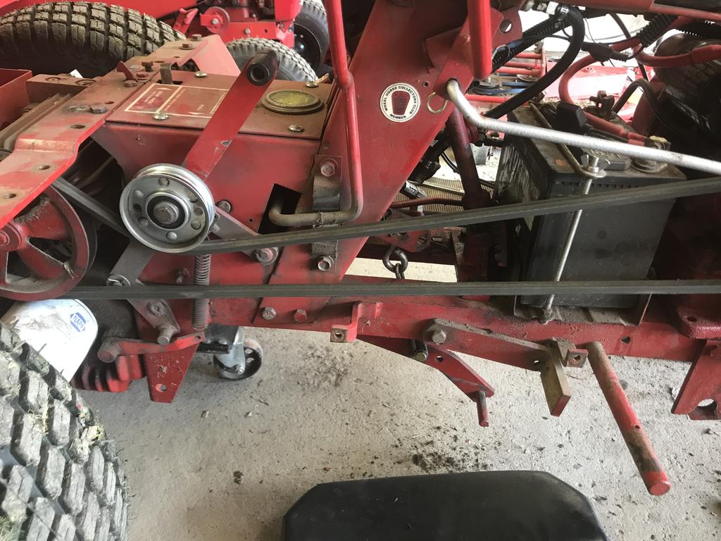

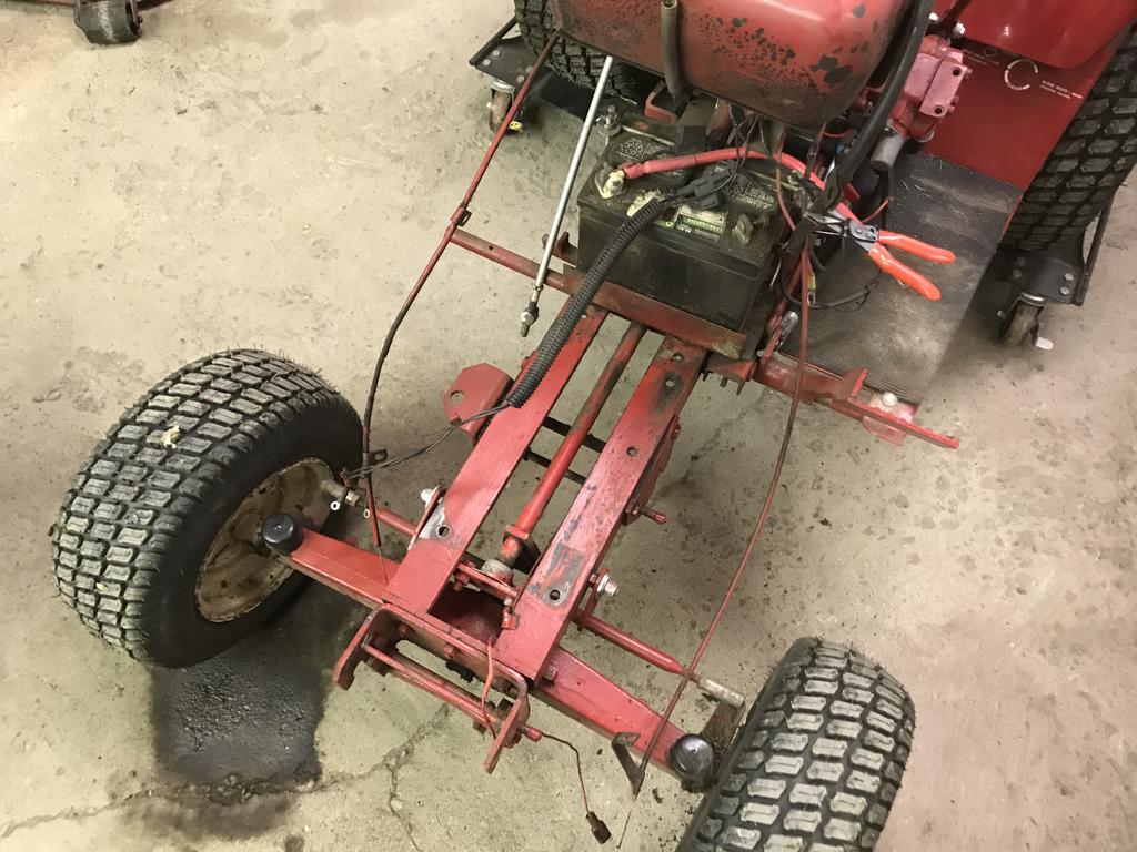

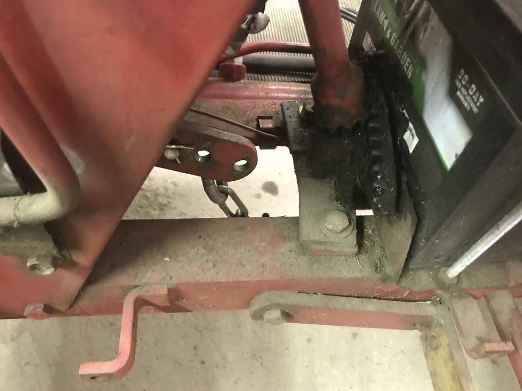

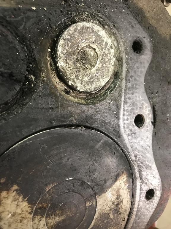

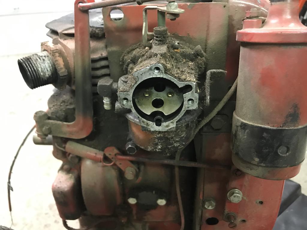

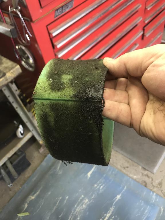

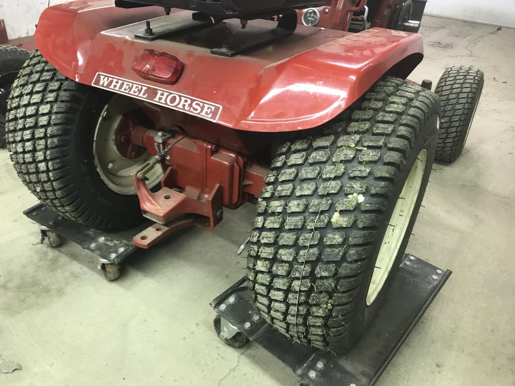

squonk 45,511 #1 Posted April 11, 2020 (edited) Many of you have read about the rattle noise coming from My C-160 engine. It sits at 986 hrs. I got this tractor at 700 hrs.about 12 years ago and it was tired then. Smoked like crazy when I first started it but it cleared up. Been mowin and blowin with it ever since. got another engine from @richmondred01 3 or 4 years ago and put it on the shelf as insurance. Well time to cash that policy in! I had pulled the head and found some slop. Also look close at the piston by the exhaust valve. It's starting to deteriorate. I put this air cleaner wrap on last year after the show. Look at the GUNK!! First step wheel dollies so I can move the hydro around. I clean the engine often You can see all the gunk that came from oil mist from the breather making things sticky. New engine has a chipped pulley so I have to reuse the old one. Plus the PTO spacer is stuck so out comes the puller. Bad tooth removed. cleaned all the gunk from the frame. Here's an idea for @WHX24 and his A-81! With everything ripped apart, I decided to replace the steering block that has been broke since I got this tractor. somebody made a clever clamp setup that was still working to this day. I did see the block wiggle some so out it comes. My 12yr. old Napa drive belt still in fine shape! First start!! Still got a few adjustment to make under load cutting grass!! Edited April 11, 2020 by squonk 7 14 2 2 Share this post Link to post Share on other sites
Tractorhead 9,216 #2 Posted April 11, 2020 The new Engine Sounds nice. do you have any clue what was the reason, about the outlet Valve ? wrong gap maybe or a weak Spring? good to have spare and a well equipped Workshop 👍 2 Share this post Link to post Share on other sites

953 nut 64,114 #9 Posted April 11, 2020 Glad to see you saved the block from becoming a boat anchor with a hole in the side. 1 Share this post Link to post Share on other sites
