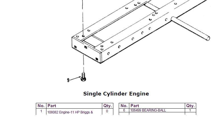

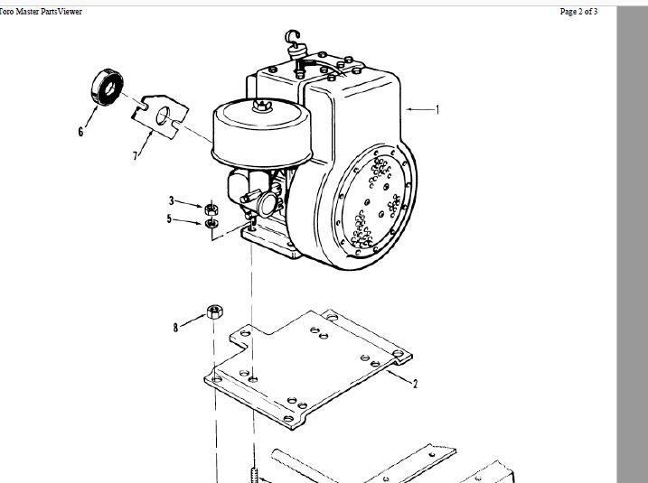

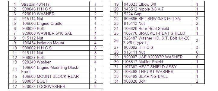

pfrederi 21,190 #9 Posted April 11, 2020 Probably more than you want to know but here we go. WH used the flat plate I mentioned on 1100 specials. They also used a thrust washer on C-111 and C-165 twins. The plate 108074 is NLA the thrust washer 106498 is still available but pricey. The used the same bearing in both instances 106499 Which is a Pacamor 6007RS. 1 1 Share this post Link to post Share on other sites
bellevillerod 836 #10 Posted April 11, 2020 Great now I have a direction to go. The plate is a piece of cake to machine, just have to figure out the dimensions. That should not be too hard to do. I will have to locate a good pic/diagram of the assembly of the thrust washer an bearing. The thrust washer looks like it would be pretty easy to machine up also. Will of course have to buy the first one then measure it up. After that I will make up a 1/2 dozen or so. Down the road someone else, if all goes well may want to do the same thing. Good thing is that I can use this as is on some of my other tractors. My old Sears SS16's an SS18's use a different type of pto. It should bolt right into those. Thank you for all your Help!! Going to hook the gas tank up tomorrow and see how she runs. 1 Share this post Link to post Share on other sites
