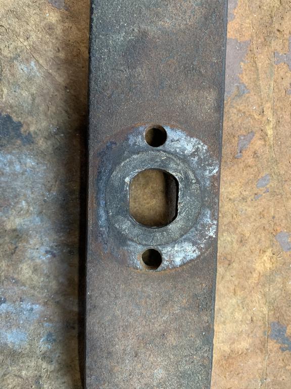

Ronert Canan 2 #1 Posted April 9, 2020 Can’t find a 16” blade with this “Bolt on Configuration” for a Wheelhorse 607 ? Forgive me it’s probably right In front of me.. Share this post Link to post Share on other sites
gwest_ca-(File Mod) 12,454 #2 Posted April 9, 2020 8777 2-blade set replaces 3719, 7760 and 7909 left blades and 3718, 7761 and 7908 right blades Left and right blade for a 32" width of cut mower. Parts Tree say no longer available Still listed here and expensive. https://www.psep1.biz/arinet.asp#/s/TO//8777/1/ There is a spindle cup between the blade and shaft. Garry Share this post Link to post Share on other sites
