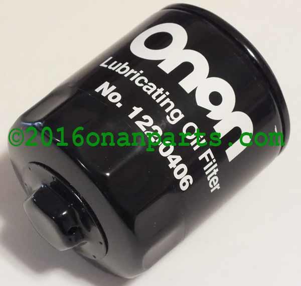

onanparts.com 185 #4 Posted April 14, 2020 122-0645, 122-0406, 122-0469 and 122-0800 all can be used. You really don't want to use the longer ones unless they are protected from damage. If they stick out, they will get crunched...If no risk of damage, longer filters are preferred since they hold a bit more oil. The short 0406 is the same as 0645 but with a hex nut welded on for easier removal in cramped locations. Same story with the longer 0800, no hex and the 0469 with hex. 122-0406 shown. Share this post Link to post Share on other sites
