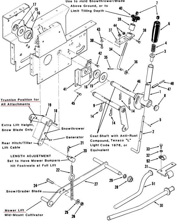

RedH 5 #1 Posted April 9, 2020 I just purchased a 79351 grader Blade for my 520H but it doesn't fit. It can be hooked up to the attach-amatic but the shaft from the blade to the hydraulic arm is too long. Could anyone give me some help with this? Do I need to make a new arm to connect it? Share this post Link to post Share on other sites
953 nut 68,519 #2 Posted April 9, 2020 Here is an illustrated parts list for the blade that may be helpful. Also a picture of the rocker shaft and lift arm to show where it attaches. Share this post Link to post Share on other sites
RedH 5 #3 Posted April 9, 2020 Thanks for your help. I guess there is another connection link to the hydraulics that I did not know about. I will get under the tractor with a flash light and look up inside the frame. Share this post Link to post Share on other sites
