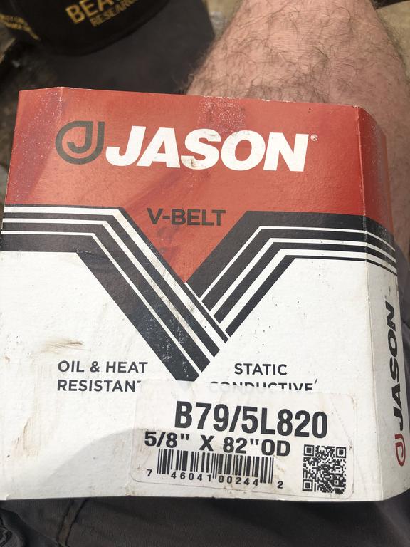

The Tuul Crib 7,354 #1 Posted April 8, 2020 I just ordered a drive belt for my 414-8 and it came this morning . It calls for a 108501 - 7473. 5/8 x 82 should work right? Nope! Too small . I checked to make sure that the PO for some reason didnt change out either pulley but they are both correct. Any one have this same issue ? Share this post Link to post Share on other sites
ebinmaine 81,046 #2 Posted April 8, 2020 What's the brand and part number of the belt that you got Randy? And is the BELT ITSELF stamped with the correct numbers? Share this post Link to post Share on other sites
The Tuul Crib 7,354 #3 Posted April 8, 2020 5 minutes ago, ebinmaine said: What's the brand and part number of the belt that you got Randy? And is the BELT ITSELF stamped with the correct numbers? The number on the belt is the same as the number on the sleeve should be correct 1 Share this post Link to post Share on other sites
ebinmaine 81,046 #4 Posted April 8, 2020 Is your old belt in decent enough shape to compare the measurement of them side-by-side? 1 Share this post Link to post Share on other sites

Tractorhead 9,218 #11 Posted April 9, 2020 I found out, when i tryed my Belts for the Hydraulic rework of my Hrse, that several Dealers confuses between inner and outer diameter. few Belts i ordered as 1226mm outer diameter come as 1226mm inner diameter, that means it will be too long and vice versa. Share this post Link to post Share on other sites
squonk 48,287 #12 Posted April 10, 2020 I would like to see a side picture of the belt you got. A B series belt is not the same as a 5L series. If there is a Tractor Supply near by, get a one of their blue belts 5/8 X 82. The inside measurement is a bit longer than a B78. If it doesn't work, you can return it. Share this post Link to post Share on other sites
