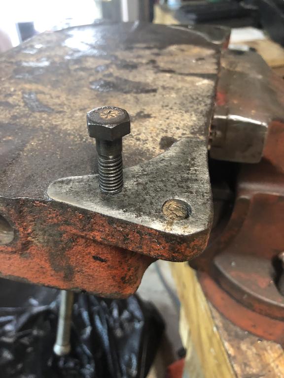

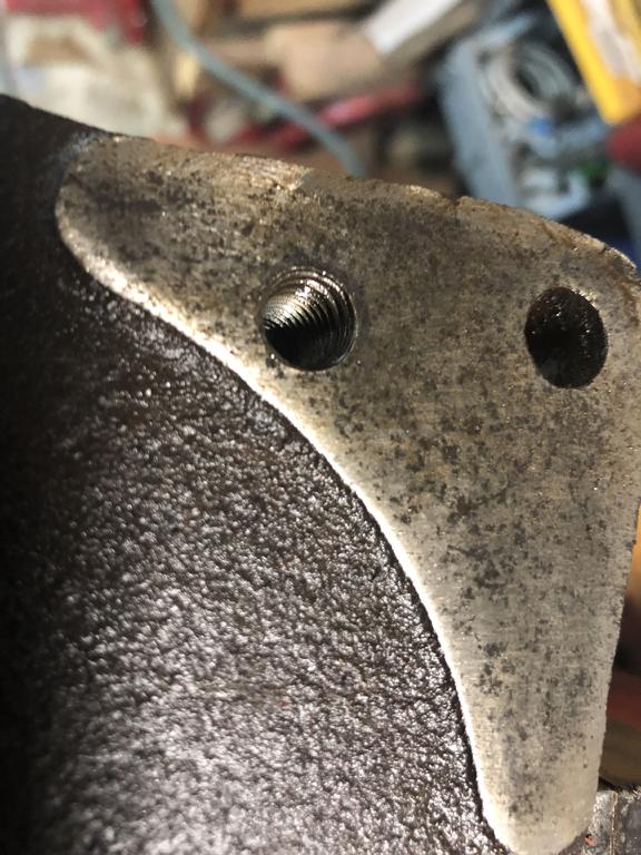

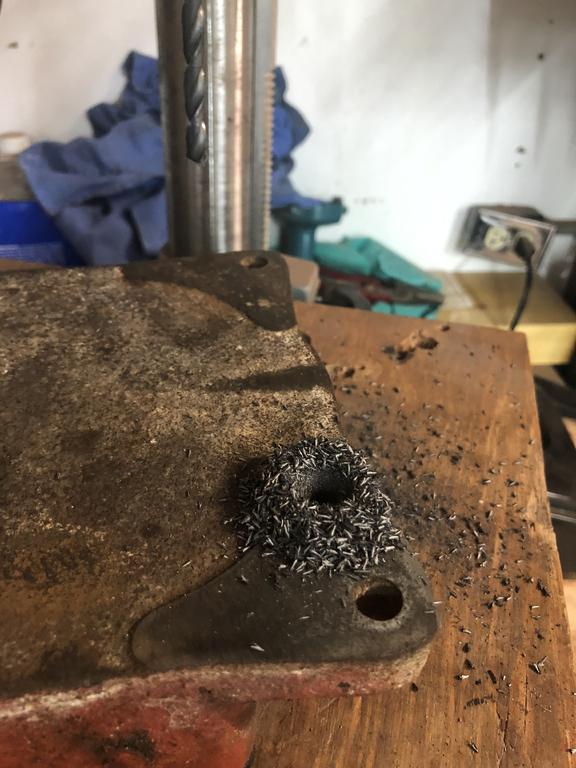

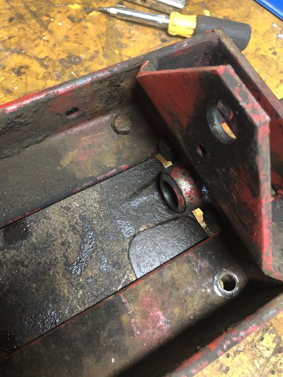

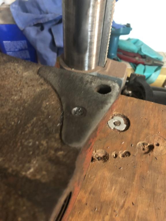

The Tuul Crib 7,354 #1 Posted April 7, 2020 So I'm going through some parts in my shed and came across a couple of oil pans for a big block kohler. Looking at the bottom they did not have those extra holes to mount from the bottom side on the right side. So I mounted it on a frame and marked the holes from the bottom side. Then l drilled a 5/16 hole and tapped to a 3/8 bolt. Lots of oil and slow go and now l have a usable oil pan. 2 5 Share this post Link to post Share on other sites

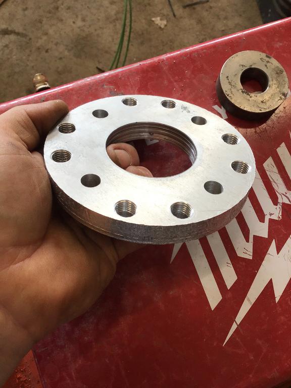

Pullstart 71,332 #3 Posted April 7, 2020 Rylee was helping me drill and tap today too! She knew exactly which bit was next... drill / chamfer / tap / move the spinner / drill.... 1 2 Share this post Link to post Share on other sites
The Tuul Crib 7,354 #4 Posted April 8, 2020 22 minutes ago, pullstart said: Rylee was helping me drill and tap today too! She knew exactly which bit was next... drill / chamfer / tap / move the spinner / drill.... She is one talented chic ! Keep up the good work Rylee!! You go girl!! 1 Share this post Link to post Share on other sites
