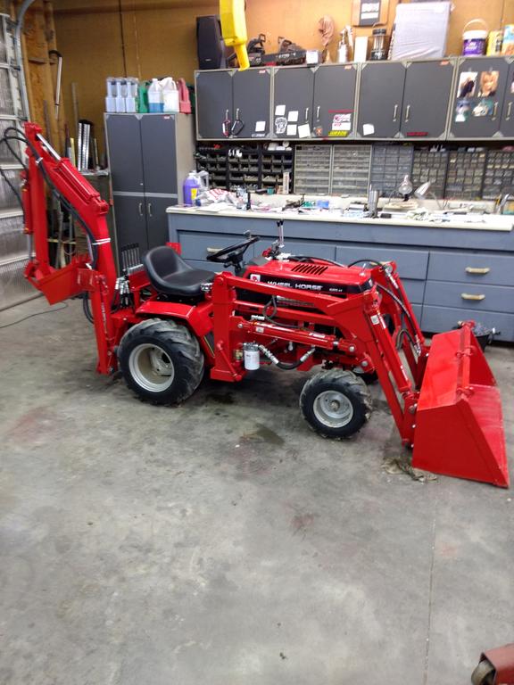

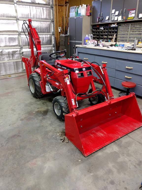

Ironman 115 #1 Posted April 7, 2020 Just finished building a 520H Loader with Backhoe. It works Great! 5 21 11 Share this post Link to post Share on other sites
wallfish 20,724 #3 Posted April 7, 2020 NICE! That thing looks great PF eng design.. One thing I wish I did different was to angle the 2 stabilizers for the hoe back towards the rear. They were ripped off twice but it was getting worked hard digging a 4ft trench to bury the house utilities. 1 Share this post Link to post Share on other sites
JAinVA 4,638 #4 Posted April 7, 2020 Great looking unit.I am building one as well from PF Engineering drawings.Just curios are you sittiing on the seat back to operate the hoe? Share this post Link to post Share on other sites

c-series don 12,609 #8 Posted April 8, 2020 Dude! Did you build that yourself? Really? That is awesome! Do you have any pictures of the build? Or more pictures of the backhoe mount? Or just more pictures of it, we love pictures 👍🏻 1 Share this post Link to post Share on other sites

mmmmmdonuts 274 #12 Posted April 8, 2020 Wow. That looks fantastic. Amazing job. How did you mount the backhoe to the frame? Share this post Link to post Share on other sites

wallfish 20,724 #14 Posted April 8, 2020 21 hours ago, JAinVA said: Great looking unit.I am building one as well from PF Engineering drawings.Just curios are you sittiing on the seat back to operate the hoe? I flip the seat up and on to the steering wheel to sit on the back of it and made some deviations to the plans for the frame holding the valves to make it more comfortable to do so. Interested in seeing how Ironman operates his. If possible, my suggestion is to angle the stabilizers back 45 deg towards the bucket instead of straight out the side like the design plans, if you haven't finished the main frame. It will certainly work as designed but there's quite a bit of force on those arms pulling them back towards the bucket. Not sure how much it would help but it certainly couldn't hurt. "beefing up" those mount areas down near the frame or doing both is a good idea. Another thing is to look into using joystick controllers instead of levers. Just a couple of hindsight observations after using it for a while. 1 Share this post Link to post Share on other sites
JAinVA 4,638 #15 Posted April 8, 2020 (edited) Ironman, Again nice build.I am working on the loader first but will build the hoe version.There is a lot of work that goes into building your own so my hats off to you.I will take your advice about angling the stabilizers back and I like the joystick for this application. Thanks for the reply! Edited April 8, 2020 by JAinVA Share this post Link to post Share on other sites
bo dawg 643 #16 Posted April 9, 2020 (edited) That's as professional as anything WheelHorse or Toro could have done. Man I would love to have that. Love to see more pictures, all sides and angles please! Edited April 9, 2020 by bo dawg Share this post Link to post Share on other sites

Ironman 115 #20 Posted April 12, 2020 On 4/7/2020 at 7:55 PM, JAinVA said: Great looking unit.I am building one as well from PF Engineering drawings.Just curios are you sittiing on the seat back to operate the hoe? I made a mount so I can spin the seat around. I'll try to post more pics soon. Share this post Link to post Share on other sites
Ironman 115 #21 Posted April 12, 2020 On 4/7/2020 at 6:50 PM, wallfish said: NICE! That thing looks great PF eng design.. One thing I wish I did different was to angle the 2 stabilizers for the hoe back towards the rear. They were ripped off twice but it was getting worked hard digging a 4ft trench to bury the house utilities. So far I haven't had any problems. If I do I'll address them as they pop up. Share this post Link to post Share on other sites
Ironman 115 #22 Posted April 12, 2020 On 4/7/2020 at 9:31 PM, c-series don said: Dude! Did you build that yourself? Really? That is awesome! Do you have any pictures of the build? Or more pictures of the backhoe mount? Or just more pictures of it, we love pictures 👍🏻 I do have some pics of the build. I'll post some if y'all are interested. Let me see what I have. 1 Share this post Link to post Share on other sites
Ironman 115 #23 Posted April 12, 2020 On 4/9/2020 at 9:00 AM, pullstart said: Love them big bore cylinders! What size are they? Most are just 2" cylinders except for the crowd arm. That one is 2 1/2. Share this post Link to post Share on other sites

Ironman 115 #25 Posted April 12, 2020 On 4/8/2020 at 5:50 PM, JAinVA said: Ironman, Again nice build.I am working on the loader first but will build the hoe version.There is a lot of work that goes into building your own so my hats off to you.I will take your advice about angling the stabilizers back and I like the joystick for this application. Thanks for the reply! Joysticks are something I really wish I had put on. I may switch them in the future. Share this post Link to post Share on other sites
