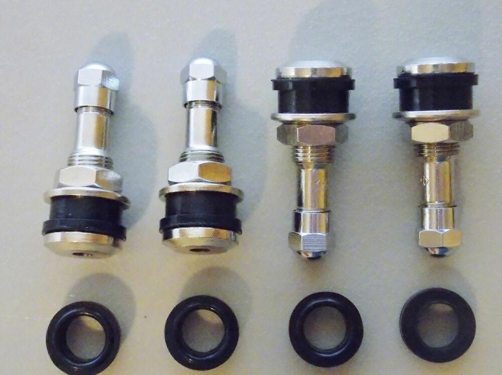

River19 87 #1 Posted April 7, 2020 Since I am replacing the tires on the C-160, I am assuming the valves might need to be replaced as well and I would rather have new ones available before I confirm that mid-project and lose a week. I found some valve stems for a 0.453" hole that are 1.25" long.......but off hand does anyone know what size the C series used? Thoughts? Comments? Insults? Thanks Share this post Link to post Share on other sites

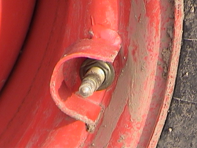

ClassicTractorProfessor 5,455 #5 Posted April 8, 2020 I use these in all my tractor tires, you can get the rubber seal for them for either the large or small hole in wheels. You will need the smaller rubber for yours. I like them as they seem to not be prone to leaking around the seal as much as the snap in rubber ones. I've also not had the trouble of ripping them out in mud like the rubber ones tend to do. Used to have farmers bringing implement tires in for repair all the time that all that was wrong was the stem got ripped out. Starting changing them all over to these and never have had one come back 2 Share this post Link to post Share on other sites

River19 87 #7 Posted April 8, 2020 10 hours ago, HandyProfessor said: I use these in all my tractor tires, you can get the rubber seal for them for either the large or small hole in wheels. You will need the smaller rubber for yours. I like them as they seem to not be prone to leaking around the seal as much as the snap in rubber ones. I've also not had the trouble of ripping them out in mud like the rubber ones tend to do. Used to have farmers bringing implement tires in for repair all the time that all that was wrong was the stem got ripped out. Starting changing them all over to these and never have had one come back Thanks for the feedback guys. There is usually a difference between "what will work" and "what is the best choice" and those are 2 difference questions and answers. I like the metal stem idea that Bryce posted......gotta see if I can track those down. Steve Share this post Link to post Share on other sites
Pullstart 70,049 #8 Posted April 8, 2020 8 minutes ago, River19 said: Thanks for the feedback guys. There is usually a difference between "what will work" and "what is the best choice" and those are 2 difference questions and answers. I like the metal stem idea that Bryce posted......gotta see if I can track those down. Steve Check out circle track racing catalogs... they look familiar 1 Share this post Link to post Share on other sites
ClassicTractorProfessor 5,455 #9 Posted April 8, 2020 50 minutes ago, River19 said: Thanks for the feedback guys. There is usually a difference between "what will work" and "what is the best choice" and those are 2 difference questions and answers. I like the metal stem idea that Bryce posted......gotta see if I can track those down. Steve Check with your local tire shops.. they should have them on hand. If you're not in a major hurry for them I can send 4 or 5 of them your way Share this post Link to post Share on other sites
River19 87 #10 Posted April 8, 2020 3 hours ago, HandyProfessor said: Check with your local tire shops.. they should have them on hand. If you're not in a major hurry for them I can send 4 or 5 of them your way Thanks for the offer......already got them on order !!!! Really appreciate the help. Share this post Link to post Share on other sites
